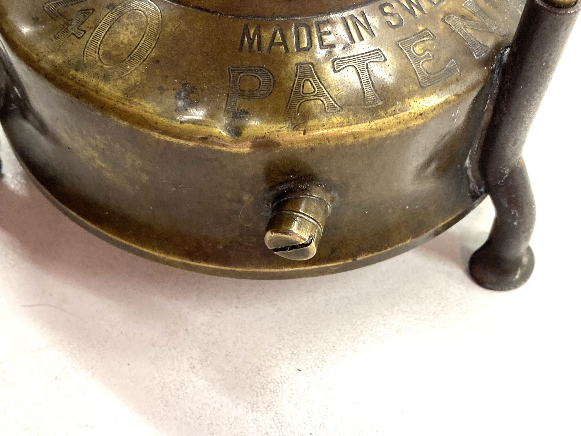

    This NRV is configured in the same way as on the tiny Svea No.40 as explained in the above quote extract. The little slotted cap is a male threaded access cap. It is well illustrated in @presscall's Svea 40 post here: Svea 40

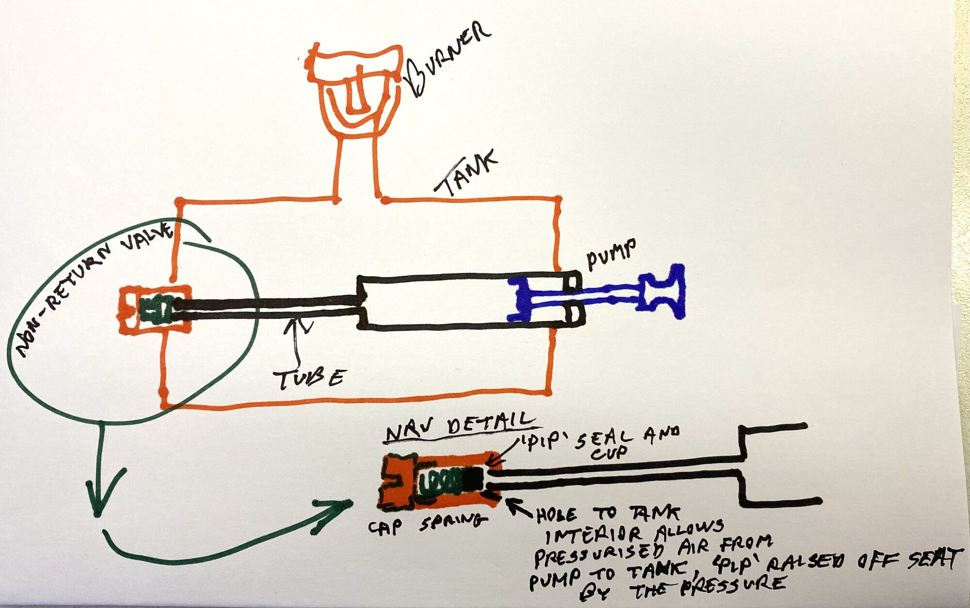

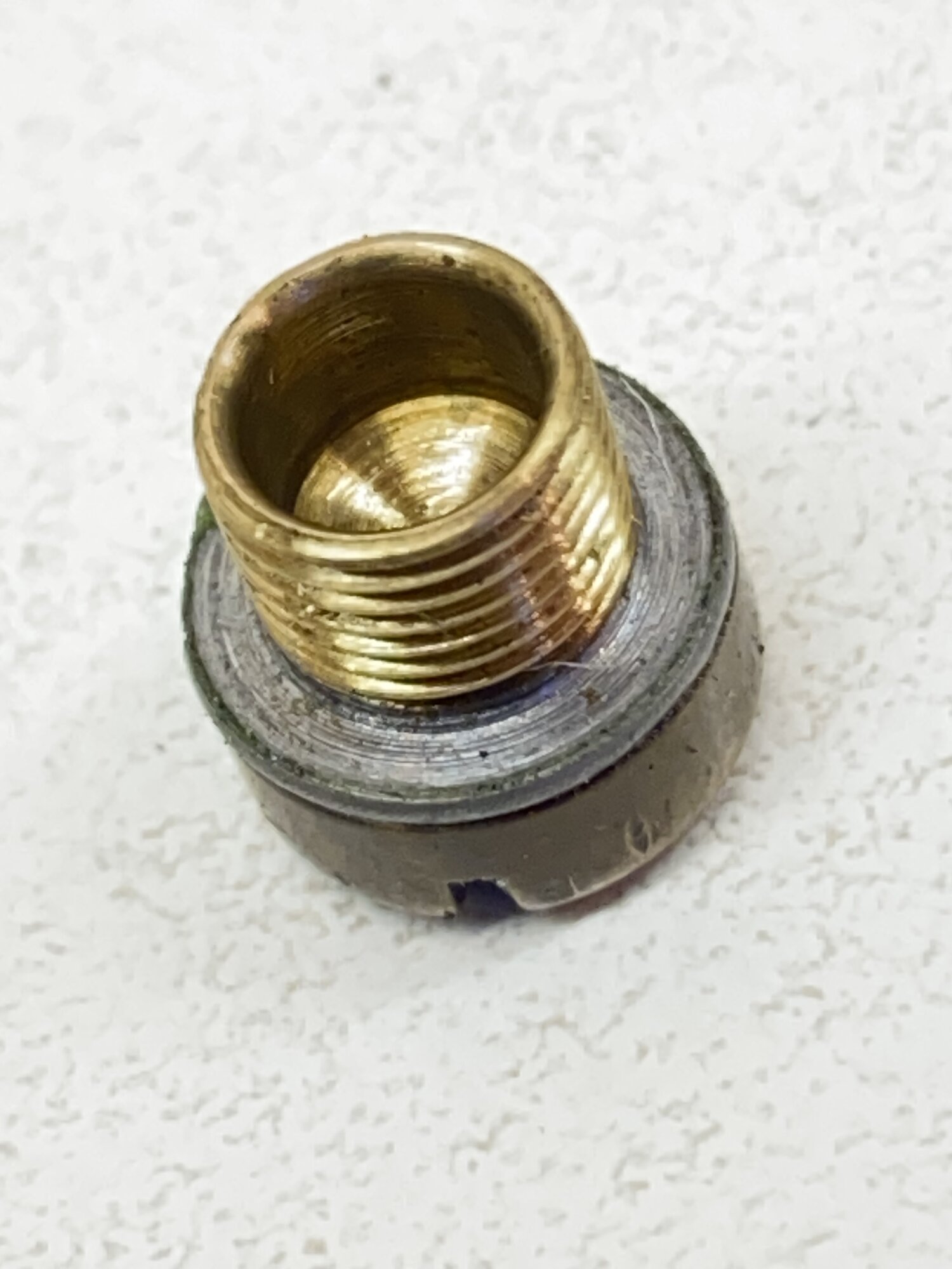

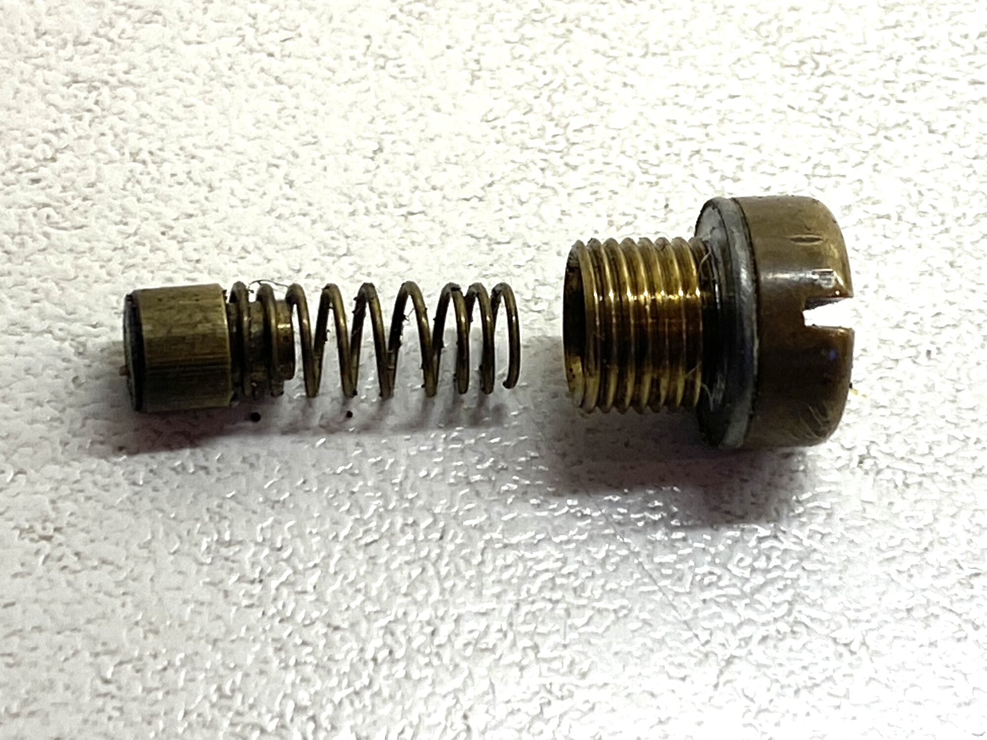

    A bit more explanation of the working of an ‘external’ Svea NRV might be helpful.
    My Svea No.40 with one.
    The NRV components, in part.
    Those fit into here, the sprung-loaded ‘pip’ seal mating against the annular rim of a brass tube that exits in the base of the pump, the tube feeding pressurised air on the ‘push’ stroke of the pump to the NRV.
    The rectangular hole arrowed exits to the tank and pressurised air passes through it into the tank when the pressurised air from the pump lifts the ‘pip’ seal off its seat.
    Pressurised air or fuel cannot escape from the NRV because its screw cap carries a lead washer which seals it to the tank.
    Crudely drawn, but the internal arrangement and NRV.
    The pump/NRV action is excellent and access to service the NRV is better than that for an NRV located at the end of a pump tube.
