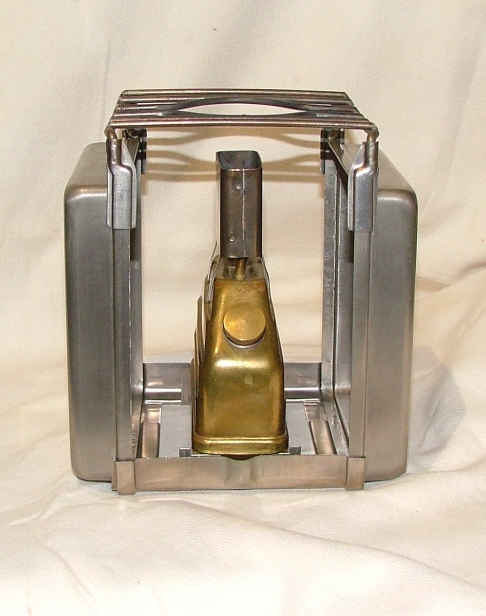

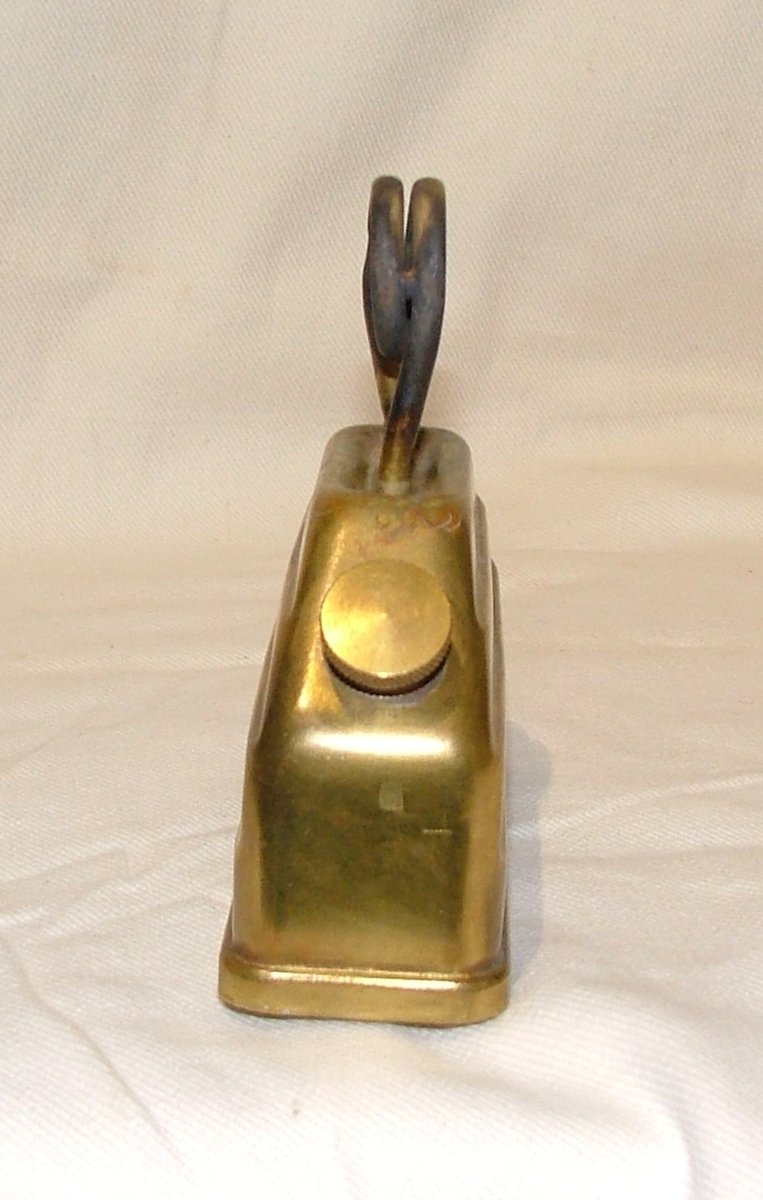

    Not the original rubber on the funnel, it is to hard to make a proper seal
    Fuel cap with pricker wire, cut the old gasket down and fitted a new around it

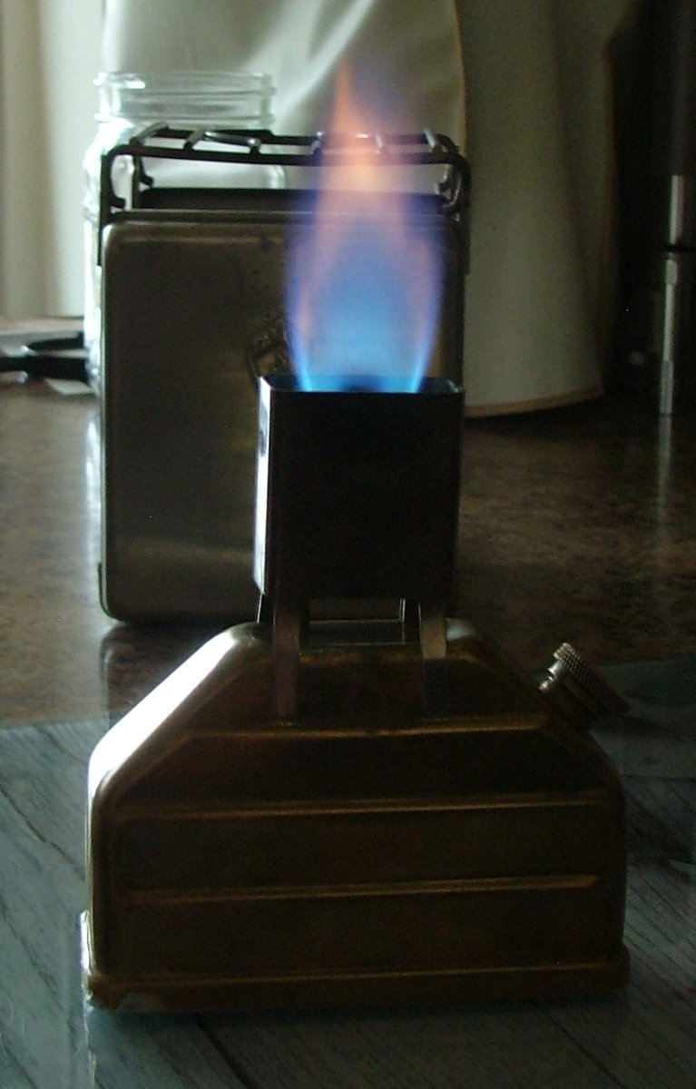

    That is about the best flame that it will produce,the wicks are probably damaged and there is no way to replace them without surgery.

    Maybe hard to tell but flame looks pretty good to me. Are you thinking the flame should be more blue, bigger, more stable, or ??

    The flame you show is not bad. Taykits are very sensitive to the gap between the coils. Instructions say .045". I use a .035" and .010" feeler gauge blades held together since I don't have .045". Use a flat bladed screwdriver and pair of pliers to gently adjust the gap with test lights in between. .045" is not the magic gap for all Taykits though. Play with the gap until you get it where you want it.
  7. snwcmpr
    16,514
    The instructions say the gap should be the size of a dime. A US 10 cent piece.

    The instructions actually say to use a "thin" dime. In those days everyone knew what that meant, modern cupro-nickel coins don't wear appreciably. A US dime (without wear) is actually .051" at the edge. So, if they really are sensitive to gap, find a feeler gauge. Or a "thin dime."
