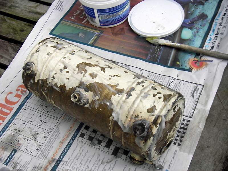

    No such indecision with the fuel tank, which went straight under a layer of paint stripper. Finished in white paint, most had flaked off and was still shedding bits. Original finish? If it was, it was poorly keyed with no primer. Brass suits me fine

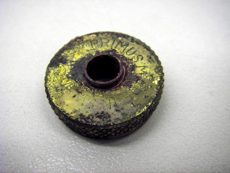

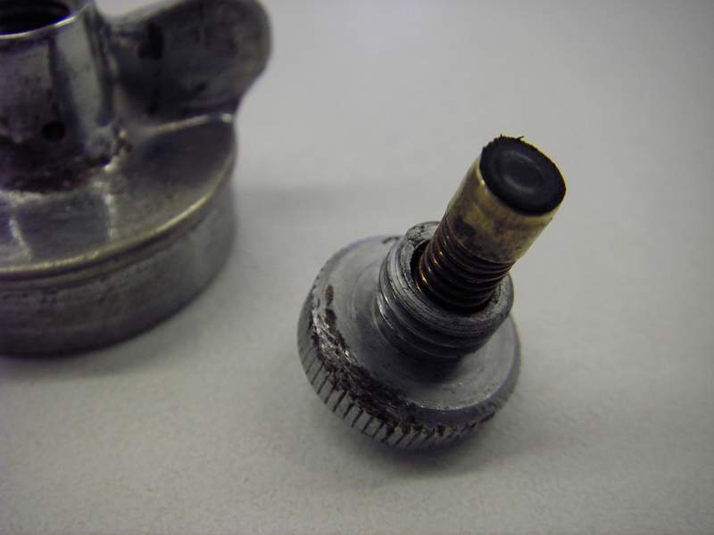

    'Perishable' goods were: burner heatproof washers; pump cup leather washer; nitrile 'pips' for non-return valve and safety release valve; tank filler cap seal; replacements for the rusty spring washers used on the assembly nuts and bolts and ... a tiny spring washer to act as a retainer on ...
    ... the safety release 'plunger'

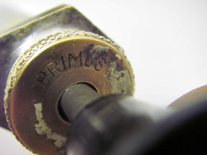

    Taylors bought in Primus parts

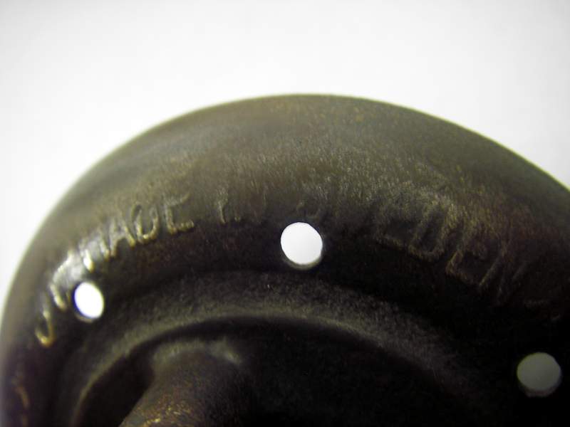

    Burner's not got manufacturer's marks but is Swedish

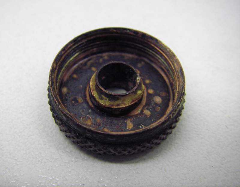

    I could live with the wear between pump rod and pump cap ...
    ... but decided I'd be happier fixing it, silbrazing in an insert to take up the slop
    Flux cleaned off, insert trimmed, polished up

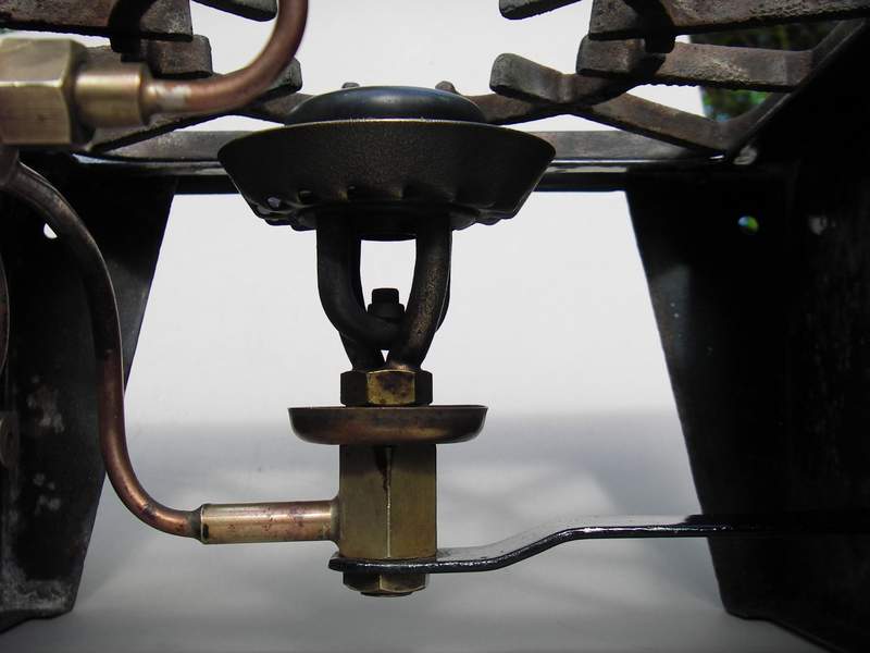

    Test assembly. Some may notice a burner swap. I fancied a more powerful burner to suit the use I had in mind for the stove (more of that in a minute) so this one's off a Primus No.10. The assembly is secured to the frame at three points using knurled brass knobs - two on the fuel tank and one on the burner bracing strut
    The regulator valve is fixed to the stove frame using a couple of countersunk headed set screw and cup washers

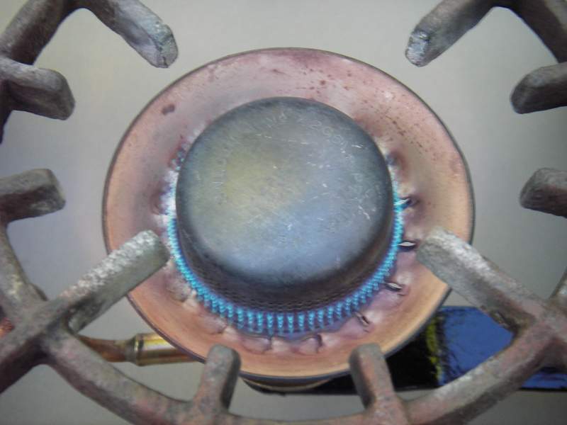

    At 10 psi (just touching on the red zone) and with regulator valve opened up a hot flame results

    Quite a robust mounting for the burner

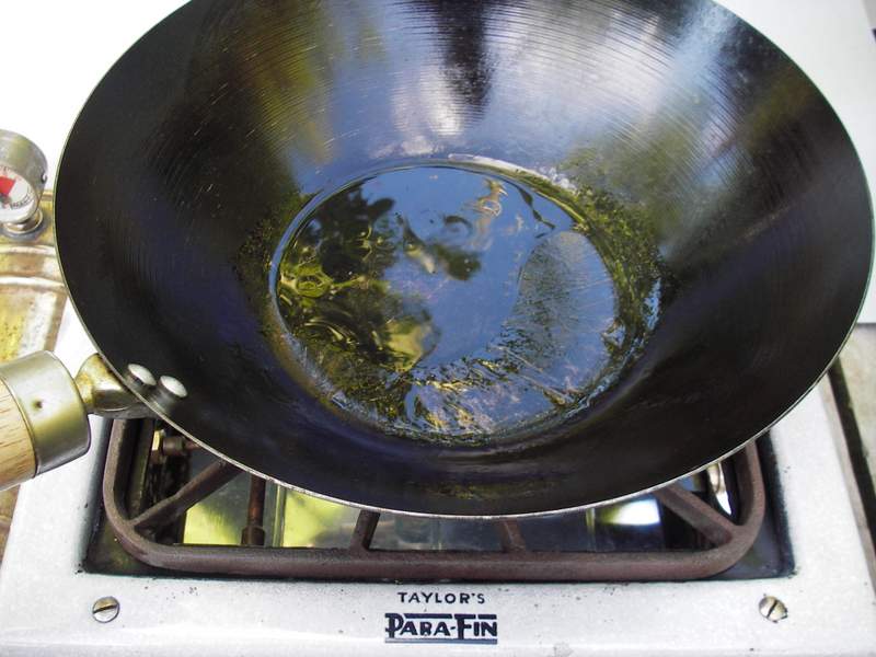

    I mentioned earlier, I had a particular use for this stove. I start by heating up some oil
    Frying lardons then popping in some chopped onions

    Night fell. Some flame shots.
    Simmer
    A useful max, something short of crazy heat (+10 psi is crazy)
    Nice cone of flame compliments the pot stand configuration
    Crazy again

    The regulator appears to be some distance from the burner head so I guess there must be a lag in flame control. Is this noticeable.?

    The feed pipe to the regulator valve from the tank is of smaller bore than the one from the regulator to the burner, so there's some hydraulic leverage at work to ease the problem.
    That said, there's nowhere near as much control over the flame as with a regulator at the burner as on Ian's more recent example in the Stove Reference Library .
    That dodge I photographed of raising the safety release valve plunger to drop the pressure works very well though, without throttling down at all on the regulator wheel, combined with the pressure gauge to get the pressure down to a figure where I know it'll simmer reliably (around 3 psi).
    So in a sense, it's best to operate it as a traditional Primus stove with an un-regulated burner by adjusting the pressure in the tank with air release and pump. The bonus is being able to pre-pressurise the tank before priming, ready to release fuel when primed and having the facility to transport the stove without fuel seepage, valve shut.
    It's possible to regulate the flame on the wheel, but tricky.

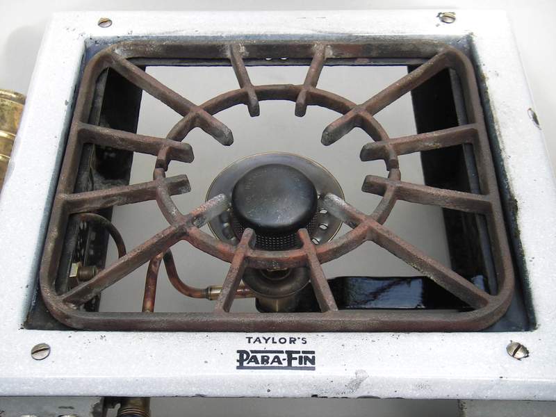

    I am restoring one of this myself right now. But unfortunately is the pan stand missing.
    Do you think your one is original? It seems to have the right size but the ends are a bit rounded while the stove has straigh corners. I believe it is hard to find an original one so I am planning to make a replica in flat iron or something like that.

    I found the answer myself and of course on this forum. In this post a similar Taylor stove is listed and it has the same pan support. I take this as an evidence it is the original.
    Not easy to copy though:

    Current example of a two-burner version on ebay further confirms that the grid is original to the stove, as is a white-painted fuel tank.
