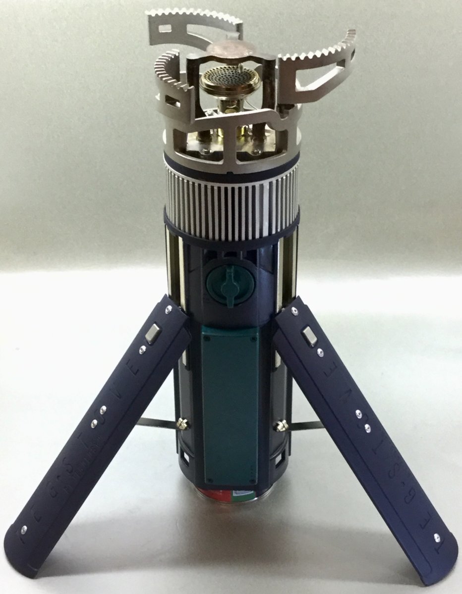

    It’s a tall, weighty device. Some comparisons of scale, Soto Windmaster and Svea 123

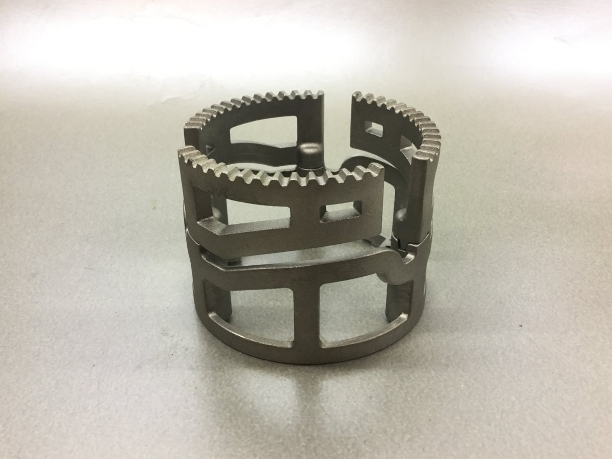

    The pot rest. Very sturdy, nicely sprung adjustment to three positions - stowed/open/wider open.
    The legs offer variable height to compensate for uneven ground ...
    ... and click into place at the base for stowage.
    The legs are firmly braced and in spite of the height of the stove, create a very sturdy cooking platform.

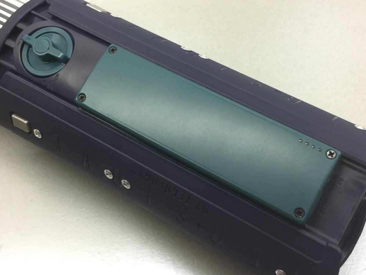

    Electrickery.
    The Li-ion battery and charge indicator LED’s.
    Button to check on the state of charge - fully charged with four LEDs illuminated here.
    Output USB and input micro-whatsit for charging the battery from an external source (before an outing for example), using the micro-whatsit plug-to-USB plug lead supplied with the stove.
    End result, charging for a phone, or whatever.

    Some of the points of apparent built-in obsolescence might be circumvented.... The battery might just be swapped for one with the current fad of "standard" USB-ports, the kind of micro-USB on your example just went south. But who doesn't love to keep a pocket full of adapters for different standards?
    It would be nice to see the results of a practical test of the efficiency of loading the battery while running the stove, like is a brew up enough to recharge the battery or do you need to run it full blast with three canisters?

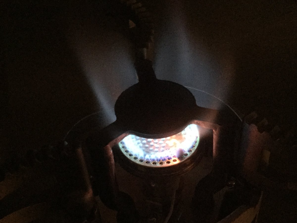

    Still compiling the evidence, but 79% charge on my I-pad to 82% charge in the time taken to boil a litre-and-a-half of water (3-and-a-1/2 minutes). The Li-Ion battery was fully charged before the session and remained so in that time.
    A second kettle boiling session produced a very lively flame on max (compared to the photo above of output after the first 3 1/2 minutes firing) almost lifting off the burner. This was due to the warming effect of the fan hot air down-draft.
    Throttled back to a simmer.
    Next test will be to discharge the battery by charging my phone/tablet from it when the burner’s not in action, then see how it copes with charging up its battery while charging a device too.
    To be continued ...

    Exactly right, after writing up my report I set another kettle to boil and the charge indicators immediately showed a drop. The greater drain of the tablet over my phone may have made the difference, but it indicates that the charging ability of the set-up has its limitations and I conclude that in my test the TEG’s charge merely slowed down the discharge of the fully (externally) charged Li-Ion battery.
    Next test was to discharge the battery by allowing it to charge my tablet without the stove burner being lit, though I was unable to get the battery completely discharged and one LED charge indicator light showed.
    It must have been very near to zero charge however, because once the TEG got up to working temperature, there was no output to charge my phone and the current from the TEG was evidently wholly assigned to powering the fan at first.
