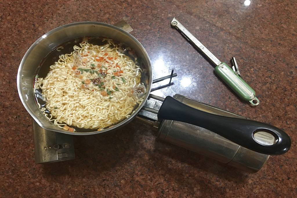

    I can only eat instant noodles now.

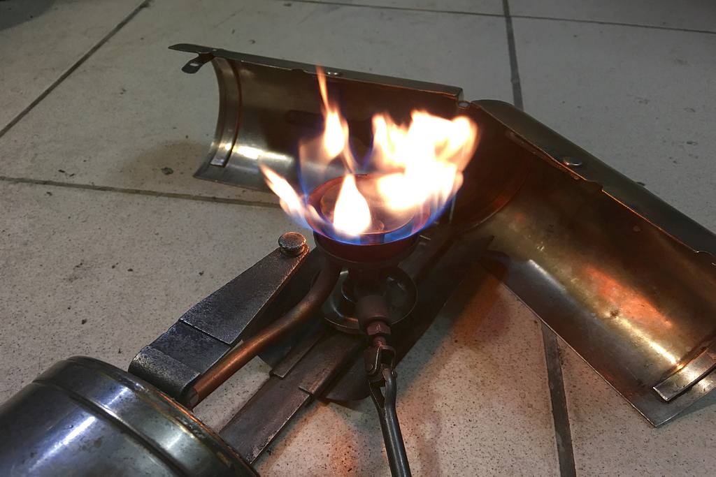

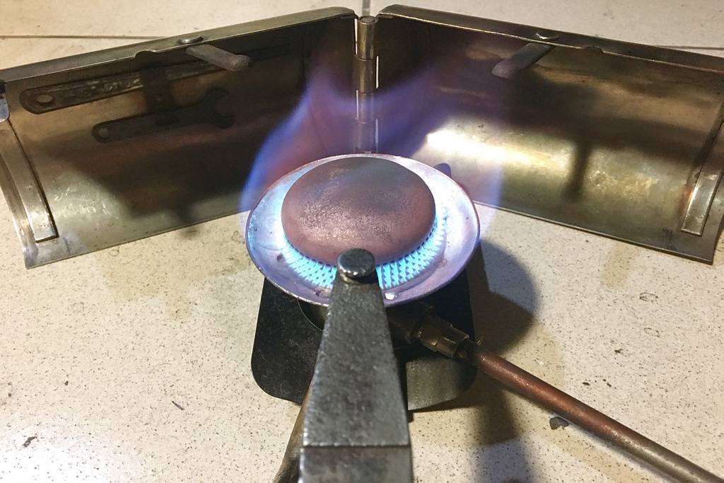

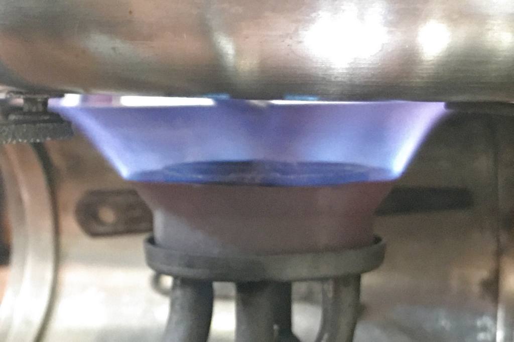

    When i try to use safe kerosene indoors. Damn, there is no pure blue flame.

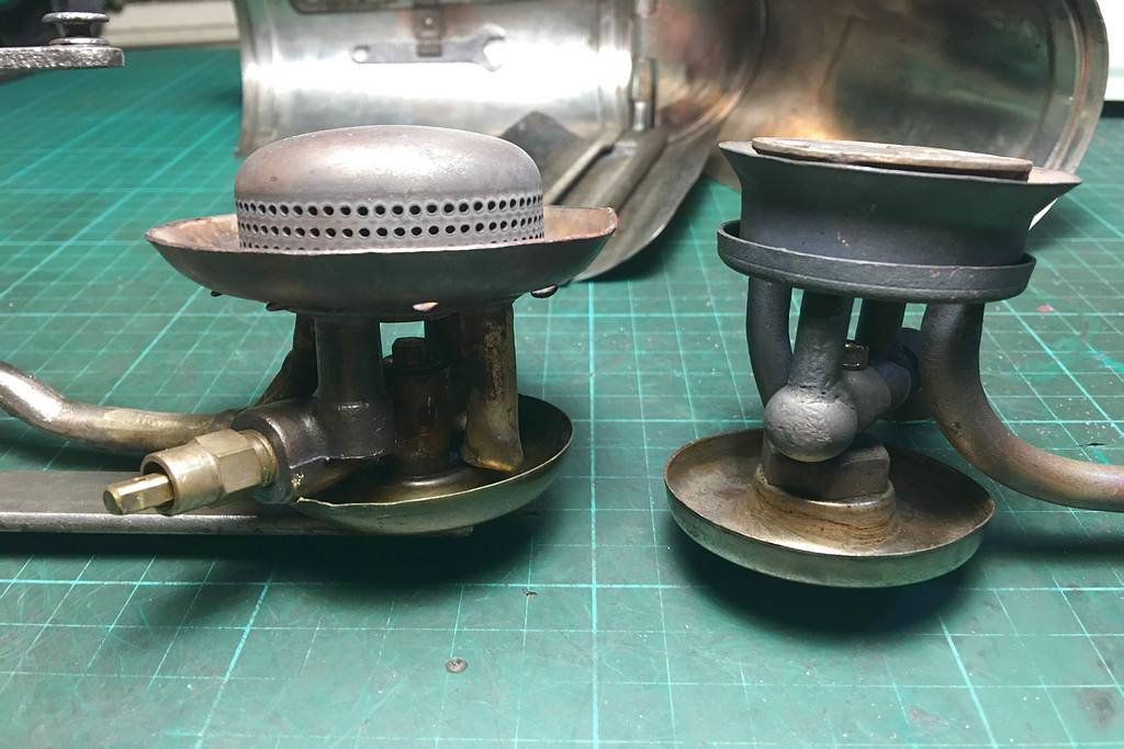

    I decided to use a silent burner.
    Normal silent burner is too high. Radius 43 burner is ok.
    IMG_8168.JPG IMG_8169.JPG IMG_8170.JPG IMG_8179.JPG IMG_8176.JPG IMG_8171.JPG

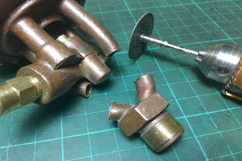

    I plan to cut down the normal silent burner.

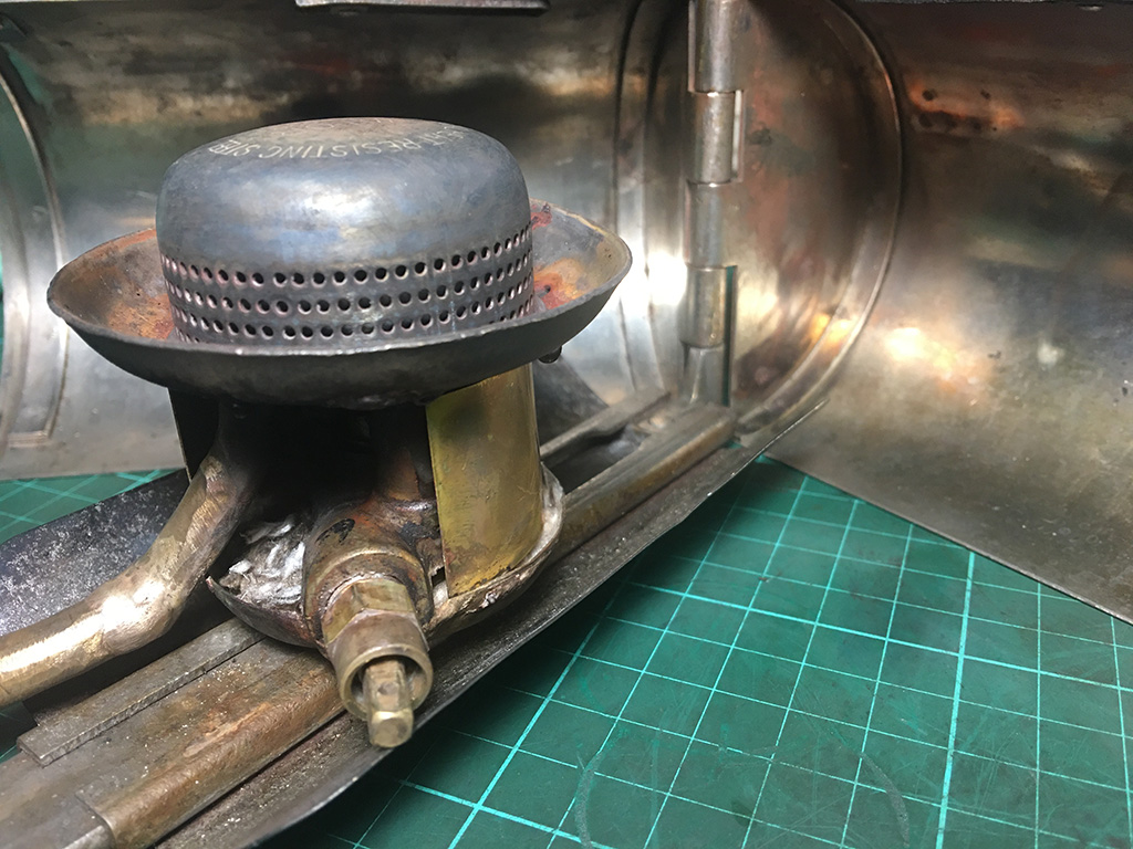

    It is difficult to bend the angle of the copper pipe without tools.

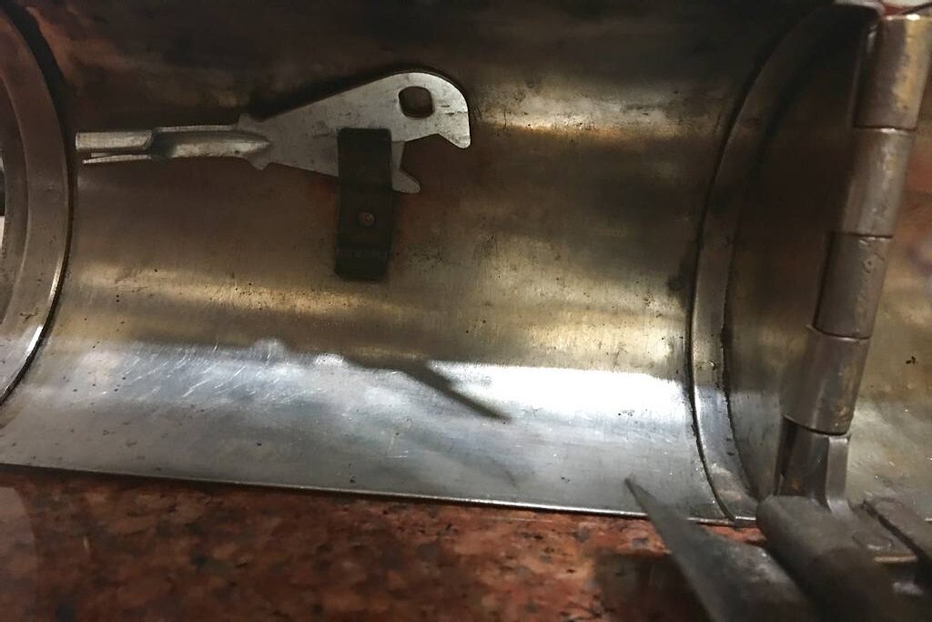

    A little interference when close the case.

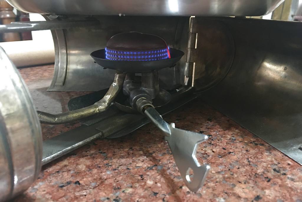

    No matter what, I'm finally done, I can switch between Silent Burner or Roarer at any time.

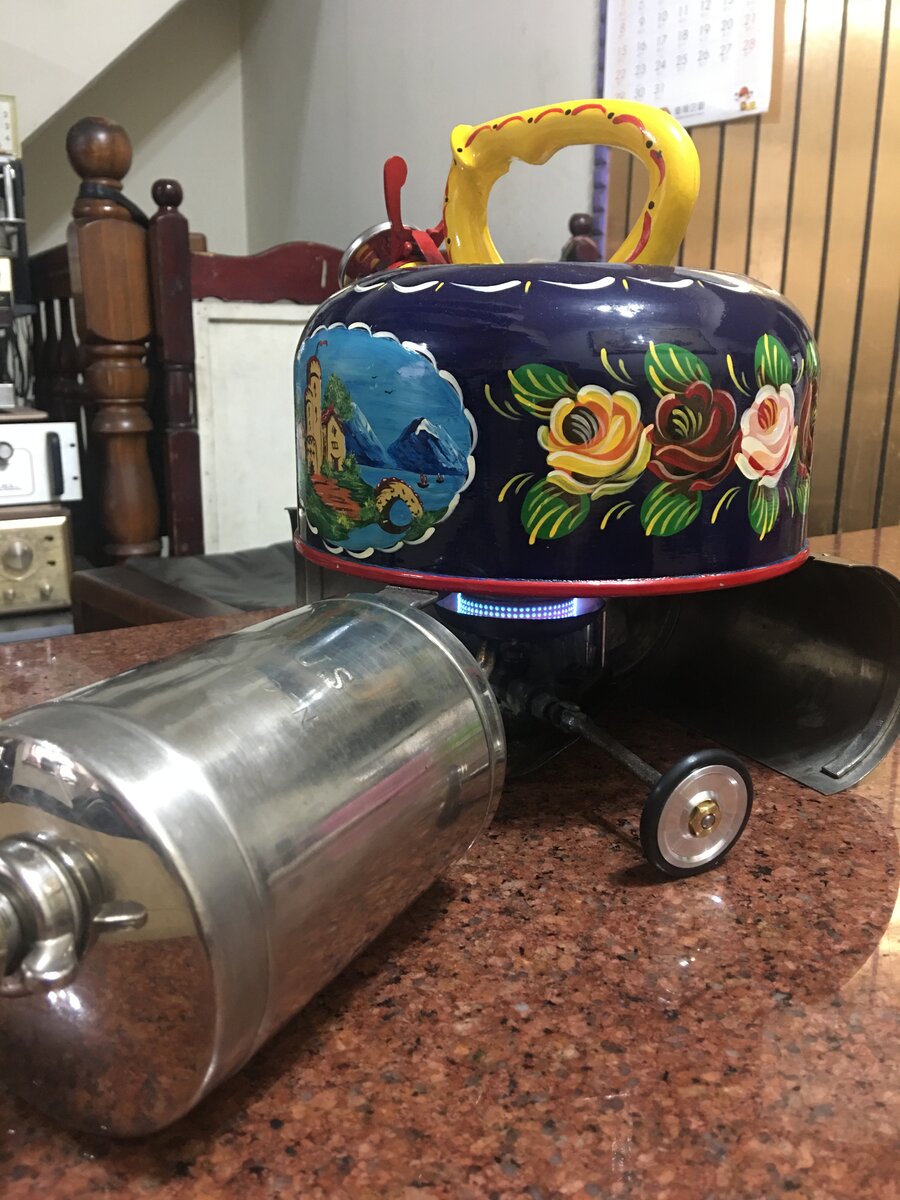

    Made a small wind shield today.

    I did not destroy the original design, I just made an extra burner set.
