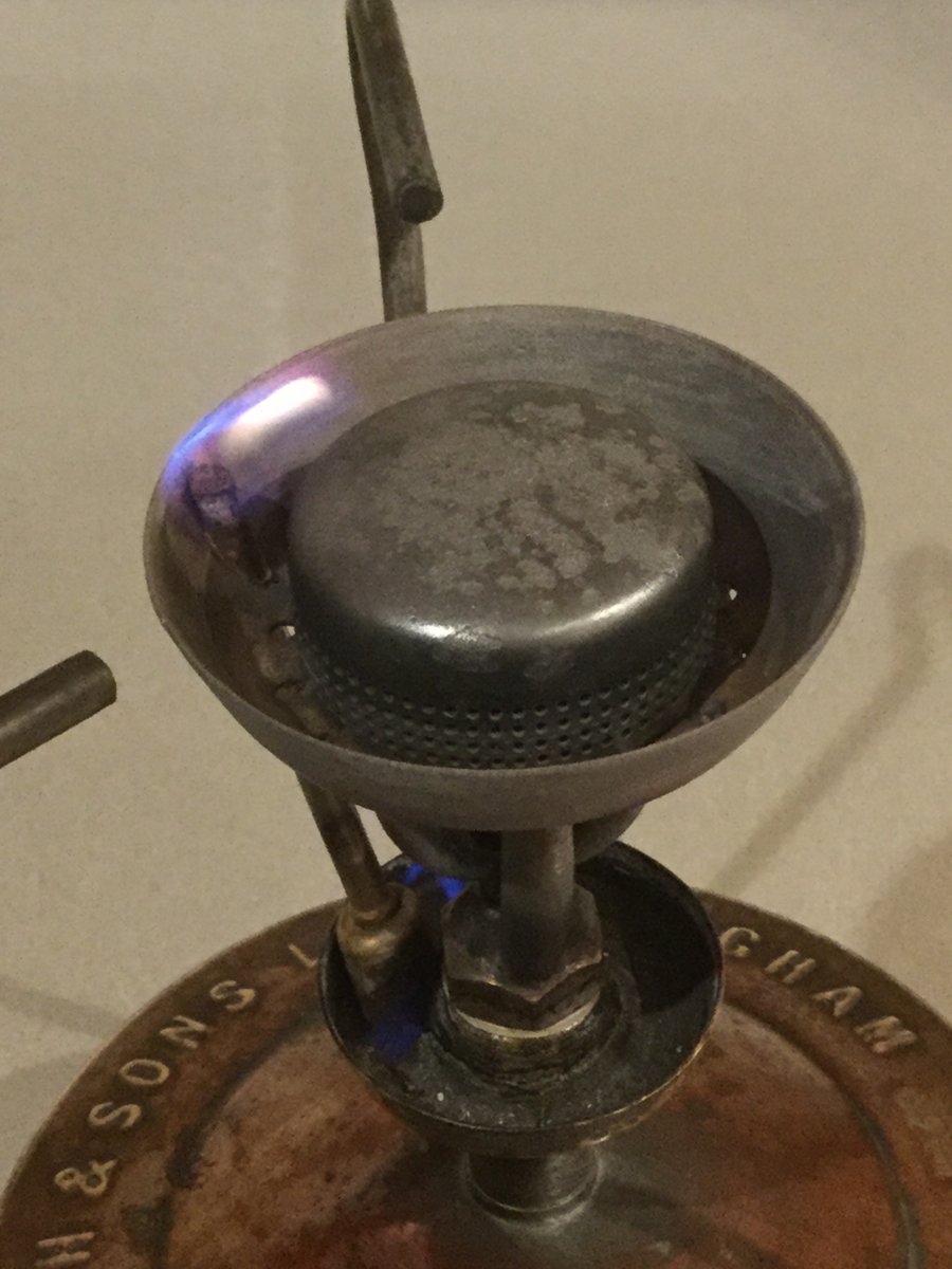

    The burner’s right for the period with a deep ‘shroud’. Judging by the age-related pitting, the inner and outer caps are original. There is an oval hole in the burner shroud for a lighting torch, which I added. Clever design, using the burner shroud as a register at one end, torch base tucking into the priming cup, so no need for a fixing clip. The torch is longer than the usual 2-pint stove burner type and I’d to silbraze an extension tube onto the one I had in my spares box.

    Priming.
    Priming torch doing its job.

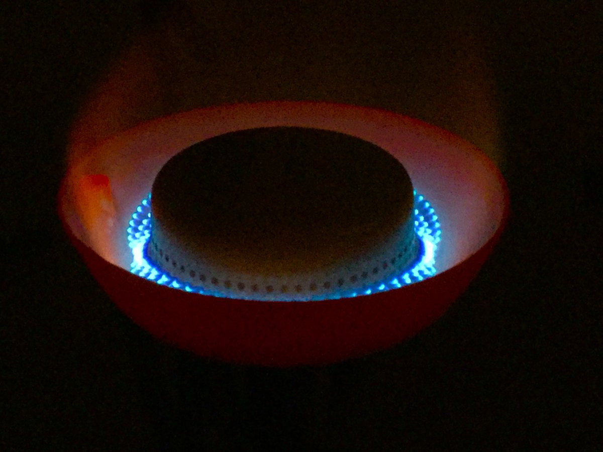

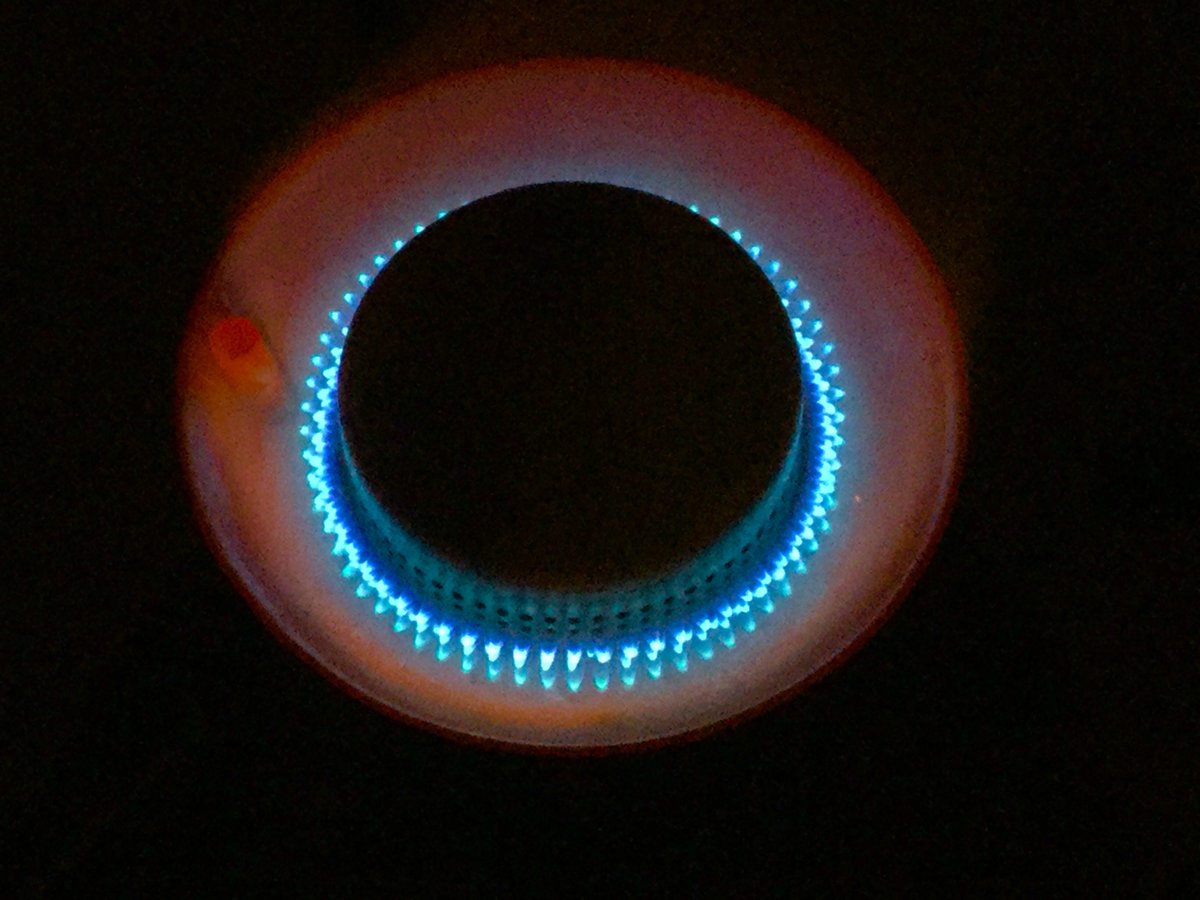

    Ignition.

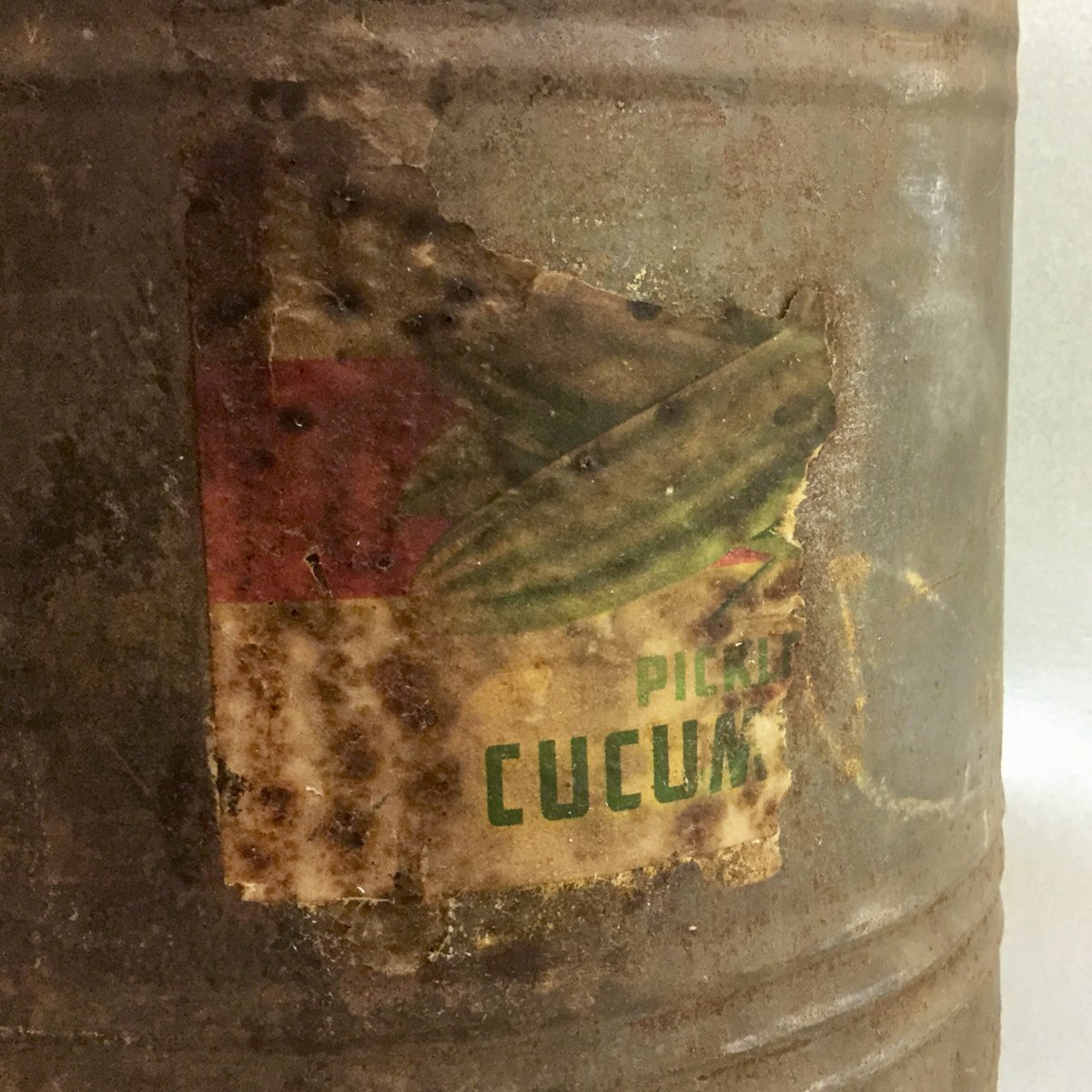

    The stove most probably dodged knocks and scrapes thanks to being used in this pickled cucumber tin. I’m guessing that was done post-war, since the label on the tin refers to the cucumbers being produced and packed by an Israeli company, which I assume was after the state of Israel was formed. Kibbutz produce, and judging by the size of the tin the contents would knock the spots off those dwarf varieties (gherkins) that pass as pickled cucumber these days.

    Hi John, great presentation of a lovely stove.
    I have seen the neat trick of feeding an igniter through the shroud of a silent burner in 1950s Czech Meva stoves:
    https://classiccampstoves.com/threads/czech-meva-value.10229/#post-98339
    David pointed out the same feature on a much earlier Monitor 2 pint stove from WW II and provided a photo in the above thread.

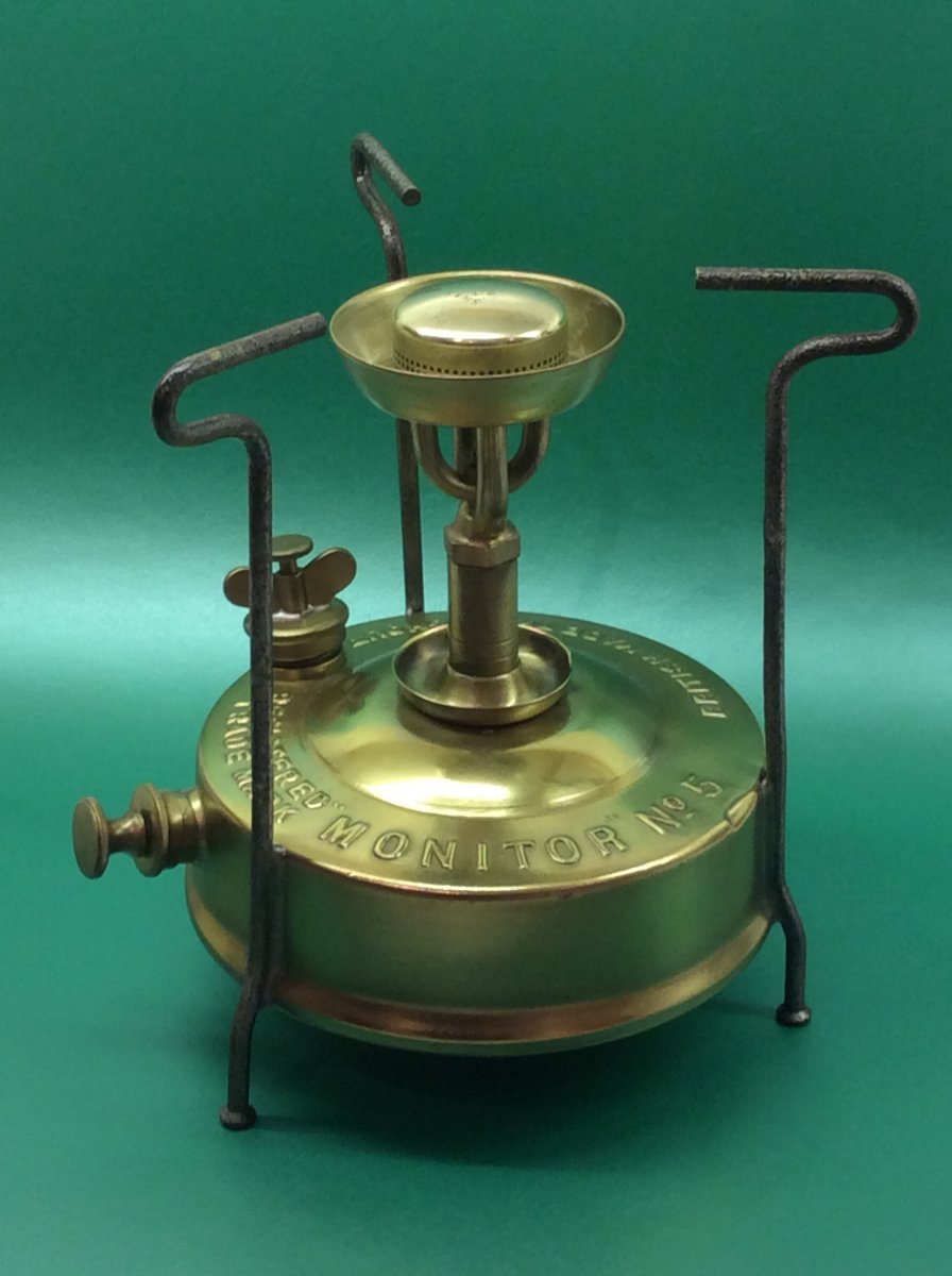

    I agree @shagratork , and yes, @teckguy_58 it has a patina that is more to my personal taste than the de-patinated look of THIS Monitor that shares many of the characteristics of the Thermidor - burner type, embossed lettering, solid build.
