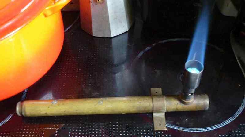

    Preheating with a Fork and then comes the Flame.

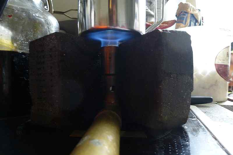

    My first Coffee with Tito.

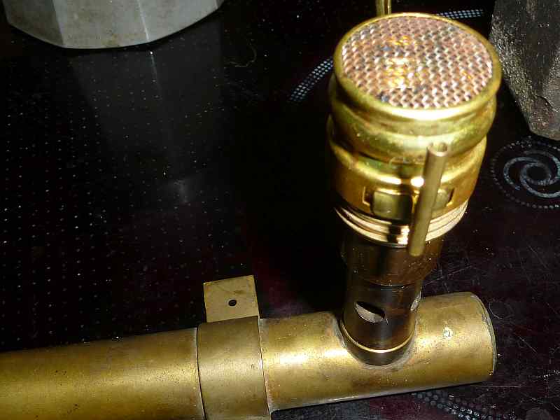

    So its Time for a little Fetling to get all Options of the Hydro-Carbon-Multitool. Looking arround and find a Part of an Air Pressure Connector that fits on the Burner.
    And on the other Side it makes Click on the Base of an Upright Gas Mantle.
    So I think I only must pull out the Screen to make Light.
    At the Top You see a Fork. So I tryed to mount an 40 CP Ethanol Burner from the small Titus Lamps. but the Flame rise up
    at full Power or at reduced Pressure its to short and looks very Hot. So I think the other Way will be better.
    Cheers Peter

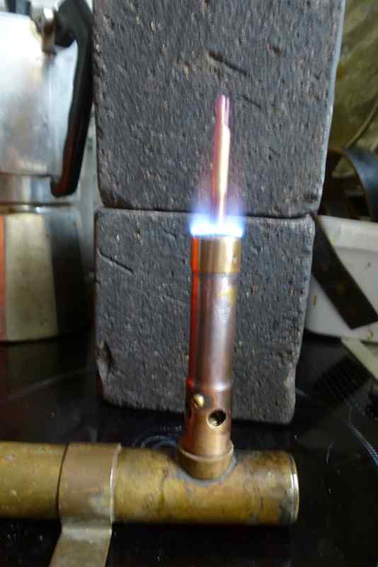

    Yes that Way was False. The Power is to low for an Auer-Welsbach-Mantle. Try and Error.
    and another Test.
    So I test a Burner from the Tito Landi double Burner Lamp. The Air Holes are smaller and I think that`s it.
    Tito Landi PIP Part II Action-Video
    So I need to build a very small Mantle next...
    Cheers Peter

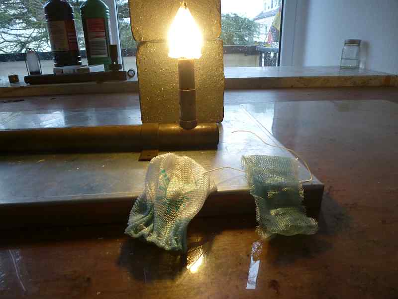

    Get it fully working with an half 500 CP Mantle. Consumes 40 ml Gasoline in one Hour. Bright Light.
    Cheers Peter

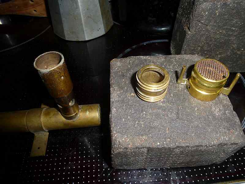

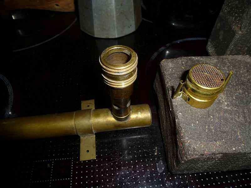

    I just get the Pip to my Hand and take a Look to answer your Questions. Inside the Tube there is some wick for the last 3" inch on the side of the Burner.
    and around the Wick there is some Metal-Wire-Gaze
    , also inside the Back of the Nozzle.
    only a little Update and a Look Inside.
