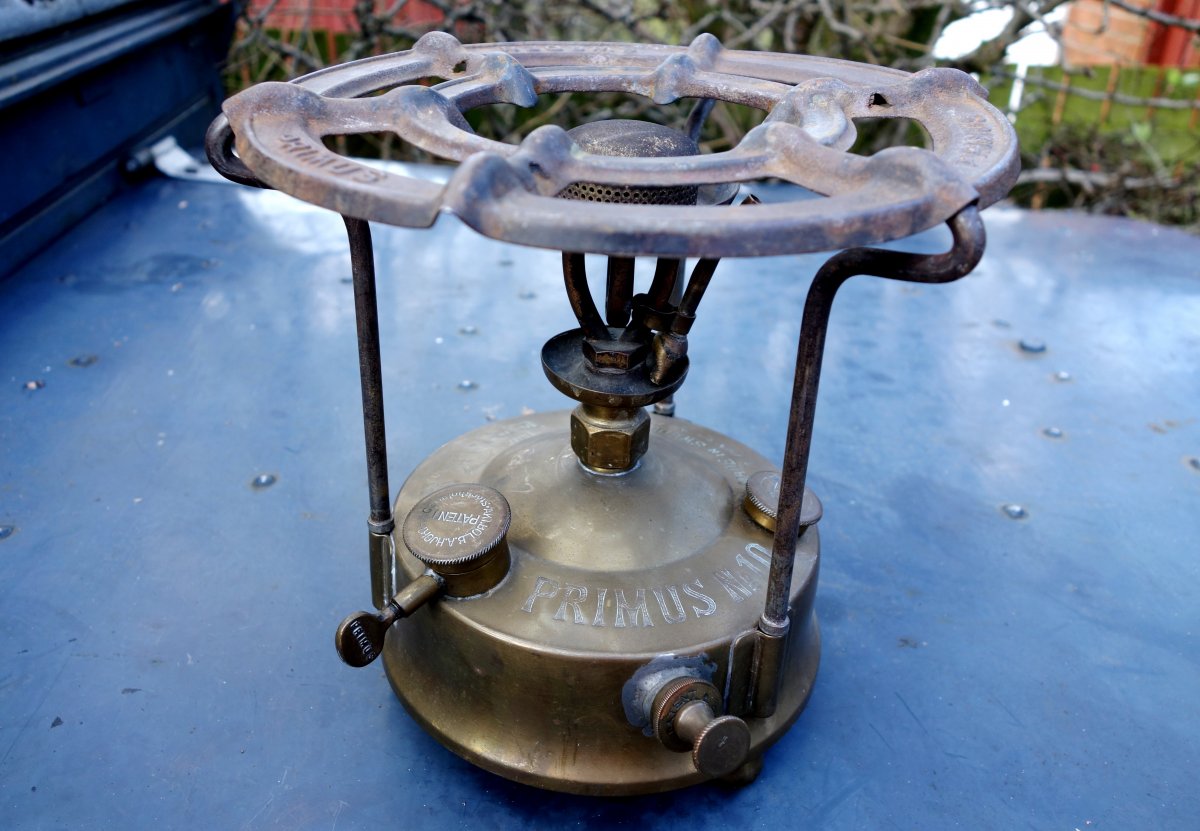

    This is the pre-1911 'Travelling-Primus' counterpart of the fixed-leg No.4 stove, absolutely nothing to do with the much later 1930s/'40s 'Primus No.10'.
    This Primus No.10 appears in the 1903 and 1905 catalogues, but is no-longer listed by the time of the 1912 catalogue. This specific example I would guestimate to be c.1905/8 as it still has old form of pressure pump assembly, and 'Patent' filler and pump caps, unlike this gallery example of the No.9 stablemate which itself is still pre-1911. On the other hand it does share with that No.9 a hexagonal riser base rather than the wingnut form (which was shown in the earliest catalogue entry for the model in 1903 but not in that for 1905). Yet another example of one of those really very old stoves that never seems to have had that
    much use.
    DSC03739.JPG DSC03732.JPG DSC03728.JPG DSC03727.JPG DSC03729.JPG DSC03730.JPG DSC03735.JPG DSC03736.JPG DSC03733.JPG DSC03741.JPG DSC03738.JPG

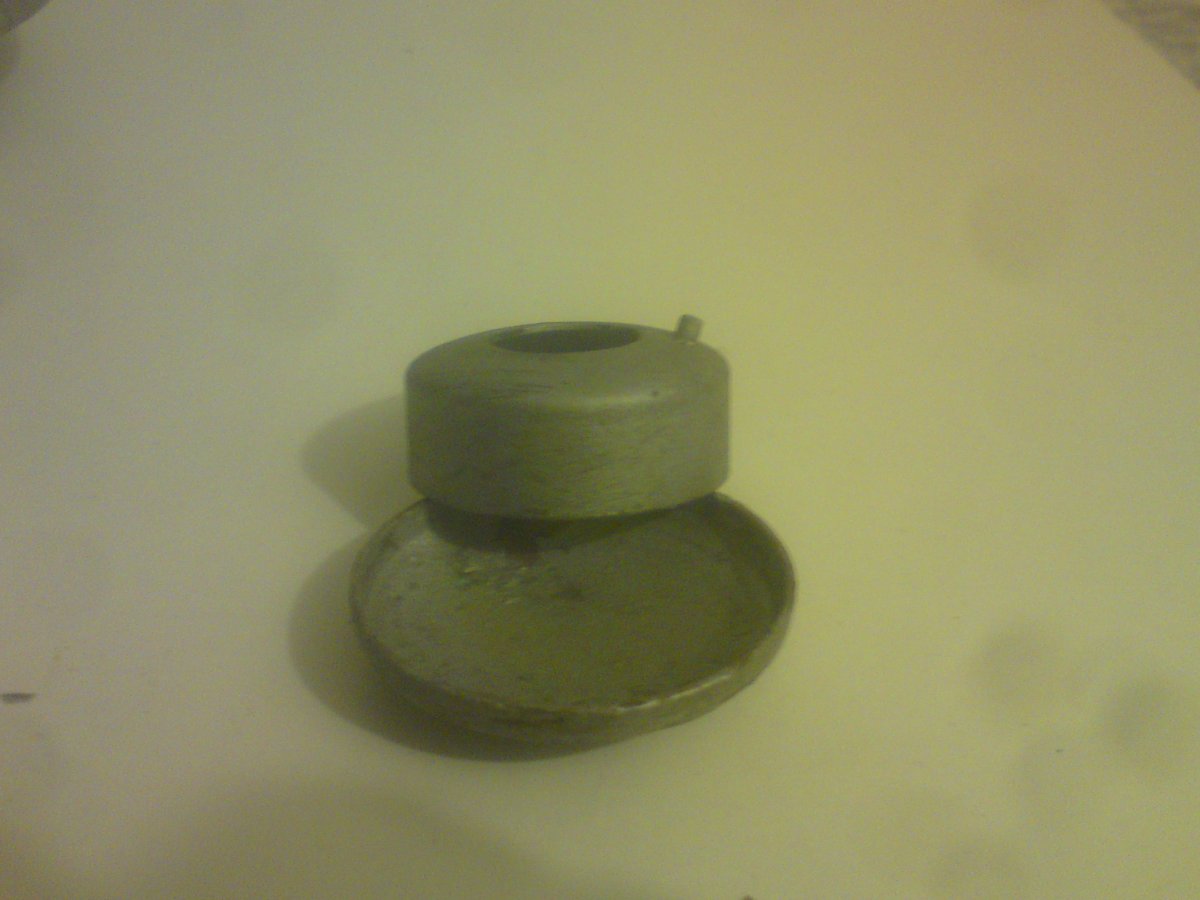

    These stoves were actually used by the Civil Defence in Sweden.
    @igh371 Is it the original burner on this one?
  3. janders
    janders Subscriber
    Aug 11, 2014
    720
    One cute detail from original the burner on these:
    Since the burner has perforated sides fixed to the burner and a loose lid only, it is quite hard to remove the inner cap. To help that process a small "handle" is found on the inner cap to provide a grip. Pretty neat!
    Sorry about the bad quality of the pic - my mobile camera is shite...

  5. igh371
    1,781
    Durham
    @janders very interesting point you make about Civil Defense use, in the 1905 catalogue the descriptive note is expanded to include a point which seems to translate as "These petroleum stoves, especially are intended for use on trips, and as militarkok so are designed that they can be taken apart in order to take the smallest possible space". The burner, however, is a later replacement, not the original fixed ring type that you so kindly illustrated; if only ...

  7. Tony Press
    7,404
    @igh371
    Does the little pip on the inner burner cap function to keep the top cap at a certain height, or is that achieved by the shape of the top cap?

  9. Wim
    Wim Subscriber
    4,464
    The little pip is there to make it easier to take out the inner cap. The top cap sits on top of the outer (fixed) burner ring.

  10. Tony Press
    7,404
    Thanks, Wim. I have a couple of this style of burner, but mine do not have that pip on the inner cap, and I'm yet to make the top cap for them.
