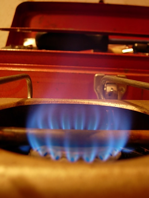

    Hello here is a Turm-Sport stove from Germany. I'm not sure of the date but understand it's an older one of the alcohol Turm stoves. the picture with flames were 99% Iso propylique but i will now use Methyl Hydrate in it.
    It's in pretty good shape but often people leave the burner cover on burning off the label.
    But still a neat stove.

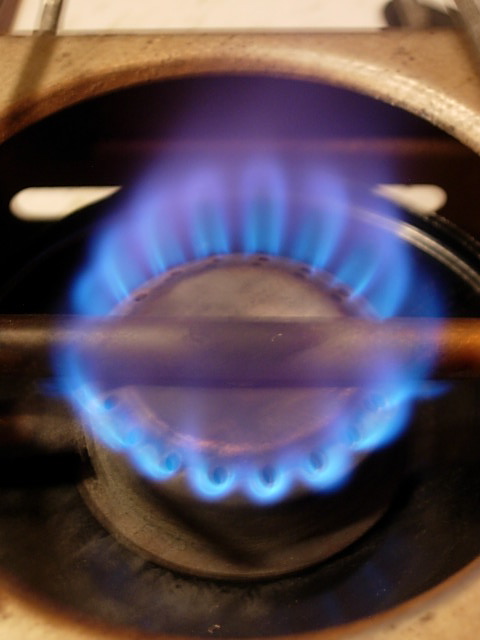

    With the proper fuel, denatured alcohol, the Turm stoves will burn with a much bluer flame than is shown in the photos above and with zero sooting.

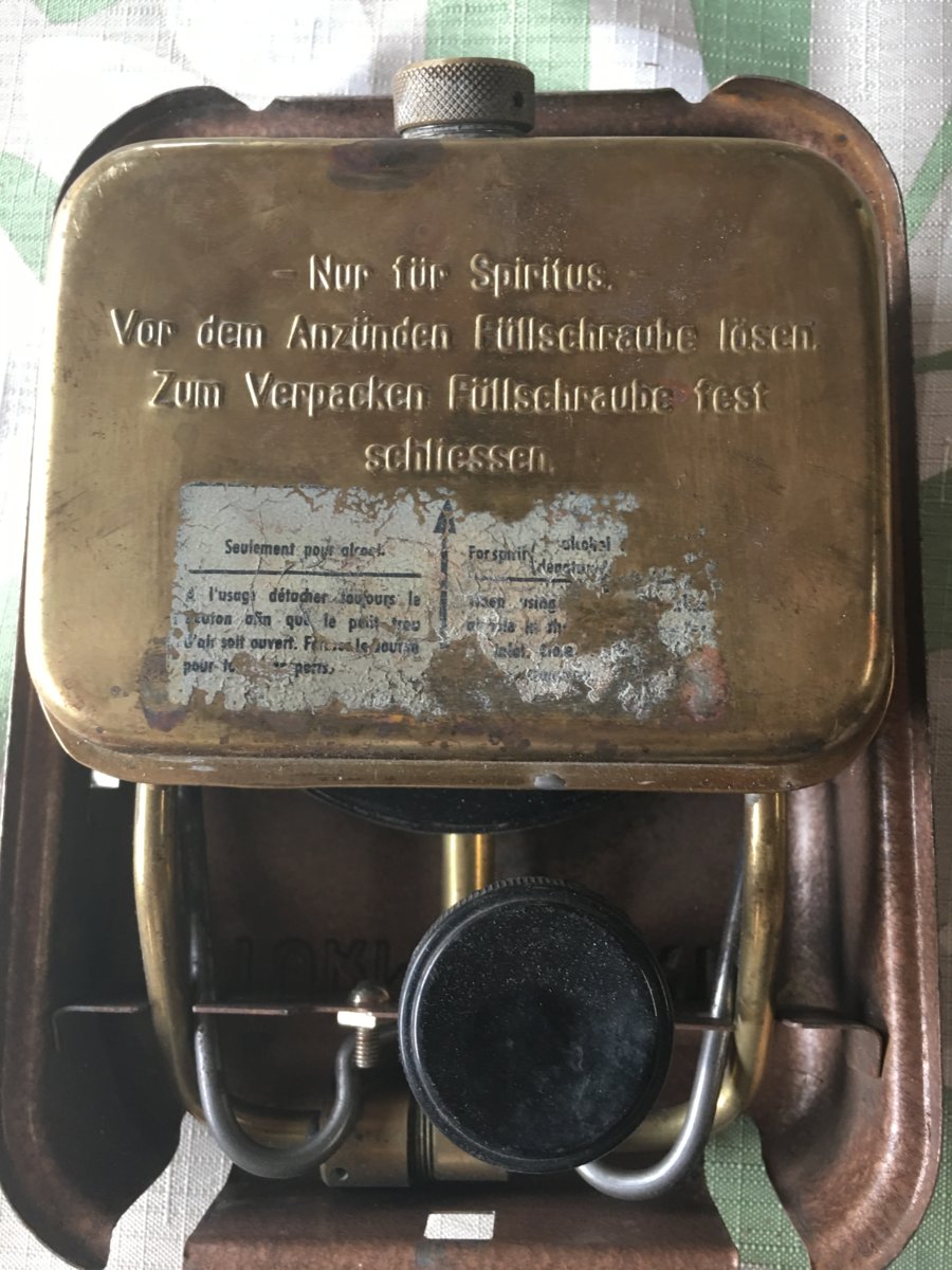

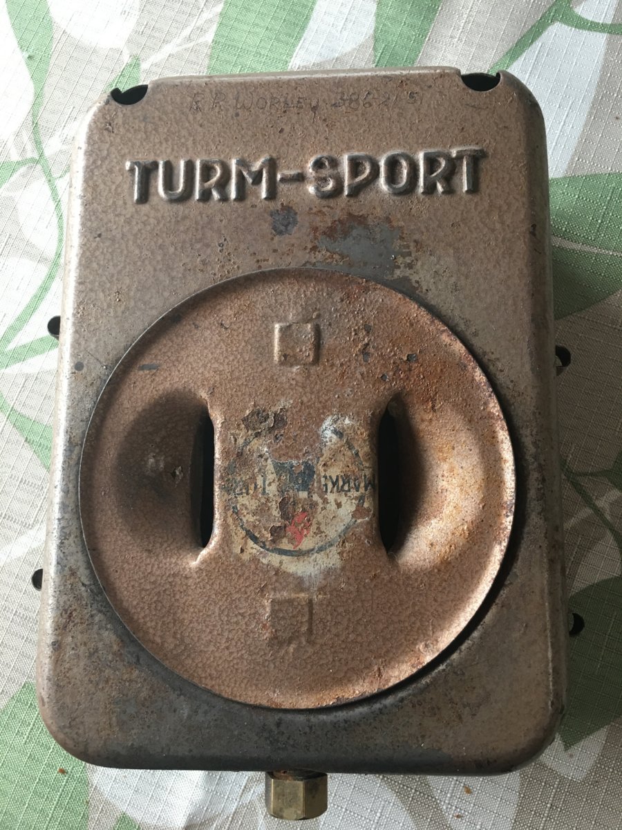

    My new to me Turm Sport. Wish I could date it. The tank has instructions embossed in German. I’m using the Kleen Strip denatured alcohol. I thought I was the only one with sooting issues from my alcohol stoves. Oh for a bottle of methylated spirits.

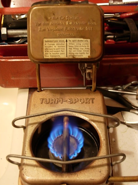

    1: I can’t get nearly the flames shown here - just (hot) simmering blue flames —> How can I get more/hotter flames out of it?
    2: where can I find a “turn-handle” for this old stove? - it has gone missing for long time since.

    My Turm Sport also had a puny blue flame. I carefully cleaned the vaporizing wick and that did the trick. I have found that when a pot sits on top of the burner, the extra heat on the burner causes a larger flame.

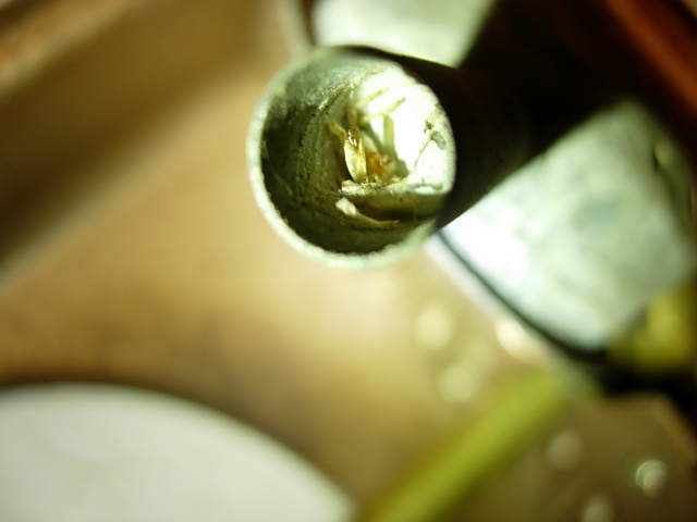

    Many long years ago, I tried to fire up one of my Turm-Sport stoves, and it steadfastly refused to run with the gusto it should have enjoyed. Finally, I broke it down to it's parts, and sure enough, in the fuel line, was the mummified body of some sort of large spider, and the thick, sticky web that it had created!! After cleaning out that former resident, I was amazed by the strong, very blue flame, my Turm-Sport immediately had!!
    Here are a few photos of where I found my "Creature from the Fuel Lagoon", and how the stove ran after I'd removed the corpse, and cleaned out the tomb (fuel line):
    And, how things ran, once the corpse and web had been removed:
    Look, carefully, inside he fuel access tube that leads directly to your burner, and you might be surprised at what you find in there. Good luck, and God Bless!

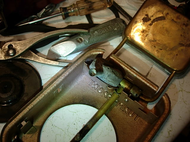

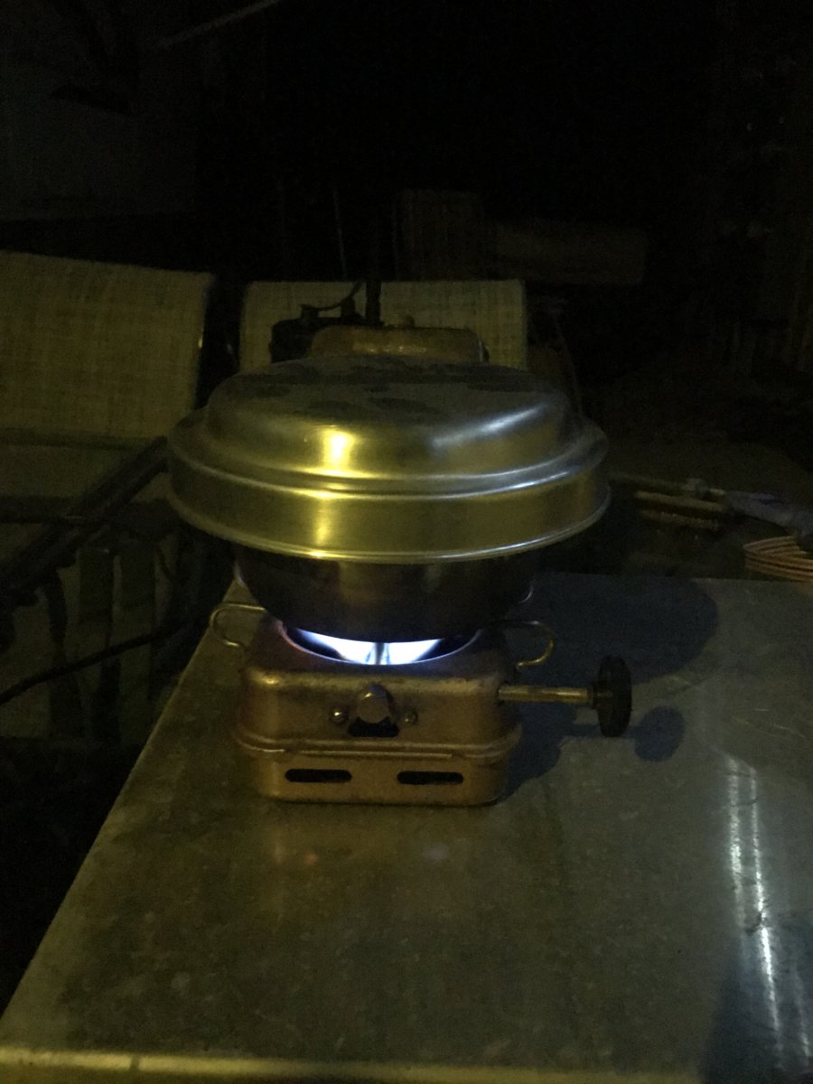

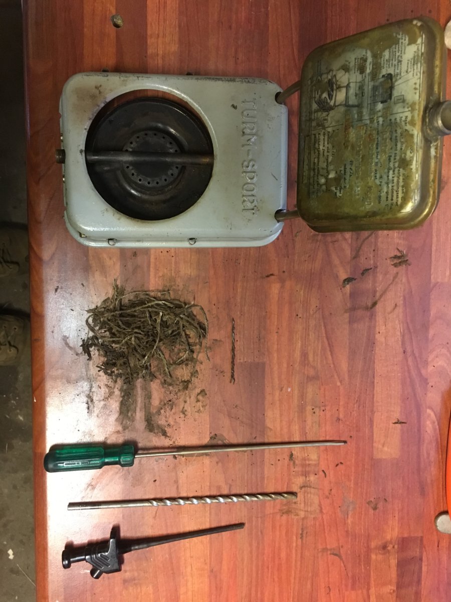

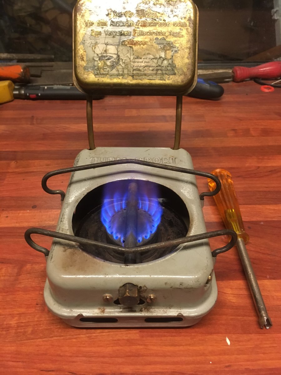

    As promised above - here are the results so far with my fathers old Turm.

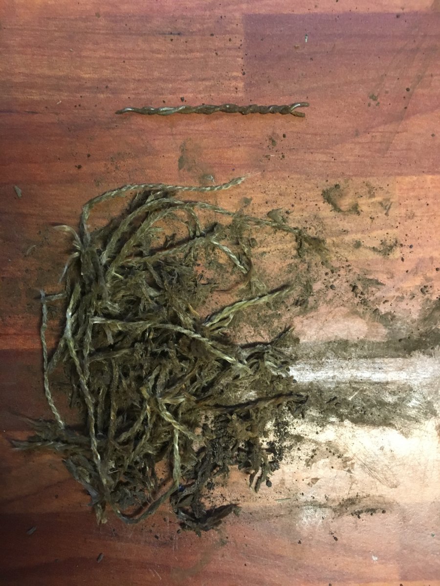

    After reading @Doc Mark horror story above - I took my burner tube apart. This last sentence took a whole evening - see pics.
    One of the tools used which was particularly well designed was the cable clamp. With that I could sloooowly dig out the old wedge. On one of the pics you can see what was left of the original twisted wire - app 1/3.
    Made a new wedge out of a glass fiber mat (Advice: do wear gloves when working, cutting and twisting raw glass fiber!!), and put it together. Now it works fine.
    You can see my interim handle. I hope to find an original some time.

    Wow! you have a nice blue flame there. Should give you years more service.
