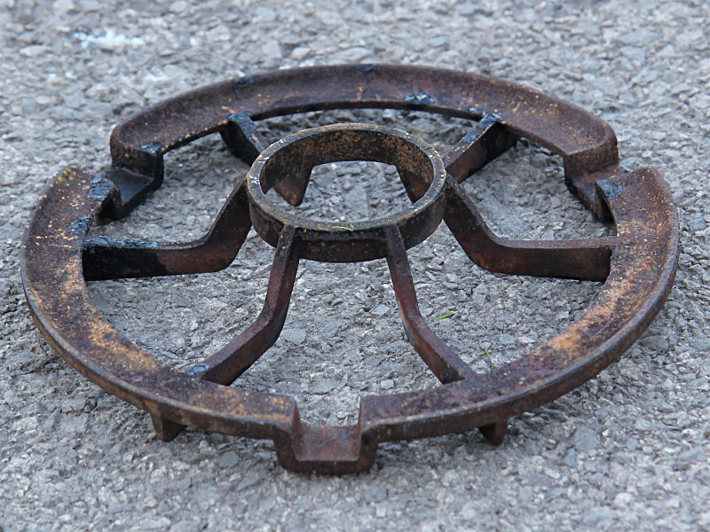

    The first paraffin pressure stove made by C.R. Nyberg. The Victoria was the predecessor to the Svea's.
    This one is probably even older than the other we have here in the gallery since it has a removeable pumptube with an old style NRV. Also the flat legs differ from that other Victoria, and it has the older style of pan ring that also act as a flamespreader.
    Unfortunately the burner has been swapped to a Primus, so it doesn't really fit the pan ring. On the other hand, I'm not absolutely convinced that the ring is original. It fit well to the broad, flat legs, though, so why not?
    Nyberg started the production of this stove in 1894, and my guess is that this one is from that year or just thereafter. The Victoria was not a success, so it can't have been made for so long before the more successful Svea entered the stage.

    The fuel cap and air release screw are the correct ones, as is the offset preheating cup.
    Nyberg did for some obscure reason decide to use the same kind of safety pin you see on the petrol fueled apparatus on the Victoria. The massive soldering blob you can see in front of the riser tube is a result of someone sealing off that area. The pin is still in the tank, though.

  5. Spiritburner
    10,762
    Outstanding find Christer! These early stoves have a unique spirit of their own. An ancient relic to be revered!
    The pan ring looks similar to the early Primus:
  6. Christer Carlsson
    Nov 12, 2005
    3,460
    Cheers Ross. Yes, I have noticed the similarity of the pan ring of the first Primus (or rather pre-Primus), but it's not exactly the same. I even tried it on my oldest Primus (again; pre-Primus), but it didn't fit well.
    I also wondered why the first 'Primus' had those broad, flatly shaped recess for the legs, despite the fact that they used round legs from the very beginning.
    It doesn't make sense, but perhaps it just was a technical thing. Something with the casting process.
  7. kerophile
    12,452
    Hi @Christer Carlsson I have always assumed that the "broad, flatly shaped, recesses for legs" were there to allow the outer ring to expand and contract without cracking.
    Cast iron items are inherently brittle, particularly in tension. Designers try to accommodate both differential Expansion and contraction stresses by having loops, sometimes with thinner sections, to allow thermal strains to be tolerated. We have all seen serpentine "spokes" in a cast iron wheel for this precise reason.
    Kerophile
  8. Christer Carlsson
    Nov 12, 2005
    3,460
    Yes, I know that. But still the later cast iron rings doesn't have this 'broad' (meaning wide), flat surface where they rest on the upper parts of the legs.
    They are still square, of course, but they are not this wide. They are just wide enough to go around the round legs.

    I thought the pump tube made of a ribbon of brass was interesting. Interesting to see it so prominent. Most of the time, the lines are more subtle.
    The pan ring did it for me. I was drawn to the thread because of it. A pan and flame ring built into one.
