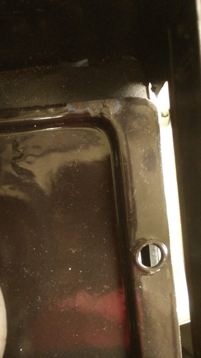

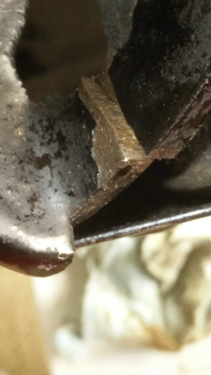

    Hi.
    I did receive the stove and after some clean up, I am not going to paint it in general. However. The pot support need to be redone and it is broken. As you will see on pictures, it will need to be fixed by welding but I can't guess what kind of metal it is. Also the paint is a kind of plastic hight temperature same as the stove top. The tray under the burner is porcelain and it is a touch up.
