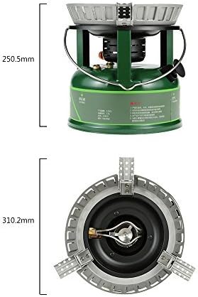

    BRS 7
    really big, powerfull, 3,2 kg.
