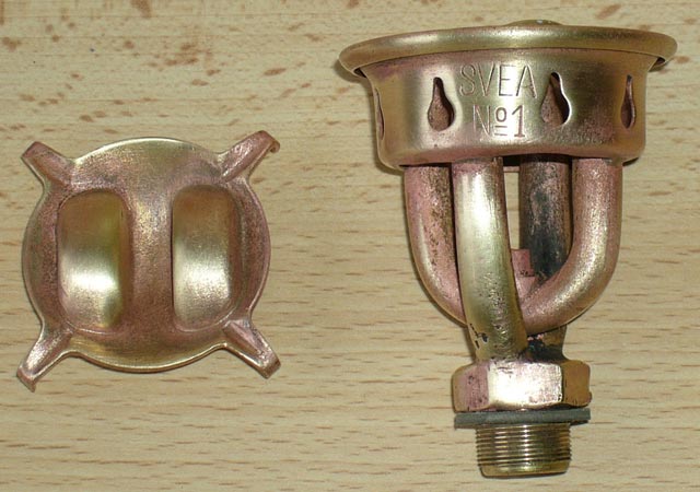

    Hi, here are some photos of an interesting early Svea paraffin burner, the No.801:
    1245305196-Svea-801-burner-1912-1.jpg 1245305221-Svea-801-burner-1912-2.jpg 1245305261-Svea-801-burner-1912-3.jpg 1245305289-Svea-801-burner-1912-4.jpg 1245305320-Svea-801-burner-1912-5.jpg
    This roarer burner has a coil-based vaporiser and was typically fitted to early 20th. Century 2-pint Svea stoves.
    It is shown in the 1912 catalogue for the Sveaspilar range, so its manufacture must pre-date 1912:
    https://classiccampstoves.com/threads/11447
    You get a nice optical illusion with the photo of the burner plate!

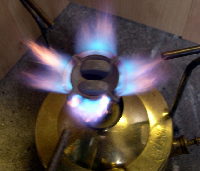

    Today, I fitted this Svea 801 roarer burner, which is now around 100-years old, to a slightly later, 1920s/30s Svea No.16 stove, photos of which can already be seen in the Reference Gallery.
    The Svea 801 burner is shown in the 1908 and 1915 Catalogues but not the 1930 one, where it has been replaced with a more conventional style roarer burner.
    Here are the photos I took of the stove/burner operating earlier today:
    1245342740-St.68_Sv.801-burner-1.jpg 1245342773-St.68_Sv.801-burner-2.jpg 1245342821-St.68_Sv.801-burner-3.jpg 1245342876-St.68_Sv.801-burner-4.jpg 1245342912-St.68_Sv.801-burner-5.jpg 1245342940-St.68_Sv.801-burner-6.jpg 1245342980-St.68_Sv.801-burner-7.jpg 1245343009-St.68_Sv.801-burner-8.jpg 1245343042-St.68_Sv.801-burner-9.jpg
    This ancient Svea 801 burner is very powerful and reasonably controllable. It primed easily and had no difficulty passing the Kerophile "Tea Test".
    The flame pattern is reminiscent of that from a paraffin-powered Op.111 I think.
    It is obvious that Max Sievert, Svea, had paraffin coil burners well sorted out by the first few years of the Twentieth Century!
    A really impressive bit of early Industrial Technology!
  8. Spiritburner
    11,667
    Awesome George - I for one appreciate seeing that in flame! :clap:

    I am wondering though, how it would burn without the flame spreader. Is it there just to spread the flame nicely underneith the pan/pot/kettle or does it also help to hold the heat in the 2 tubes.
    I am wondering, becouse, from what I can tell, most coil burners are petrol burners. This could be my inexperience off-course...
    Just a thought.

    Hi, I have made some measurements of the burner-plate of my Early Svea burner, for a CCS friend, and thought that it might be useful to record them here on the Site.
    The measurements should be studied with the photos shown at the start of this thread:
    The top plate is intricately shaped, having been fabricated from a single piece of brass sheet, approx.1.5 mm thick.
    The plate is deeply dished, but there are two shaped fairly high indentations which locate on the two tops of the vaporiser coils.
    The OD of the burner plate, including the projecting lugs is 55mm.
    The OD measurement of the plate itself is 39mm
    Max depth of the burner plate ( from top of coil indentations to base of dish ) is 12mm
    Depth of dish, excluding the coil indentations is approx 9mm
    The "turn-down" on each projecting lug is approx. 6mm
