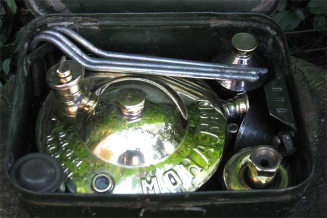

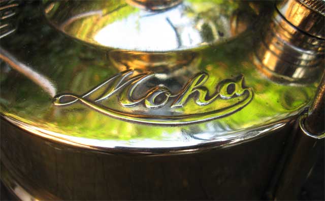

    I was very pleased to find this on ebay at a very modest price - a single fuzzy mobile phone picture on the auction may have put bidders off. I was able to collect as the seller was local. It belonged to his wifes father & had been in the loft for years. His wife used to get 'wrong' as a child for playing with it. Unfortunately he couldn't tell me any more of it's history.

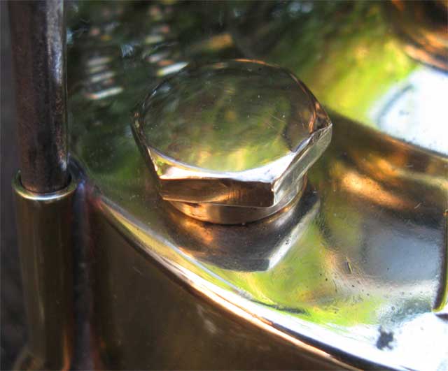

    Overall it is very nicely made with quality stamping on the tank. I peered down the pump tube & was surprised to see no NRV. When I took the filler cap off I saw why! The valve is under the filler cap held by a bracket on the inside of the tank with a pipe leading to the pump tube - similar to the external NRV design. The stove comes with a funnel that accommodates the NRV in the filler neck.
    It also features an unusual silent burner. I couldn't get it to burn well however despite giving the burner a good clean. Despite the quality of the rest of the stove the hole for the jet has been drilled off-centre & too close to the edge of the tube & has a small split in the edge. Fixing the split & changing the jet didn't help. I will have to see if it works ok with a good conventional burner - it may be the fuel pickup.
    The tin has holders for the legs & burner cap & slots - maybe for prickers, although they'd need to have narrower handles than the norm.
    The only thing it appears to be missing is a spanner & any paperwork. I had to tidy up a solder repair around the pump & change the usual washers.

    A most fascinating silent burner! I keep staring at it! :oops: It seems like a lot of metal for a standard jet/vapo chamber to be driving. I'm intrigued that it burns as well as it does.
    I'm inclined to think that the "spigot tube" that extends down from the bottom of the cap through the burner seems too long and may be interfering with the draw of enough air into the burner resulting in a "rich" yellow burn. A feller could try gently grasping the cap with channel locks (slip joint pliers) whilst the stove is in operation and lifting the cap vertically a wee bit. It might improve the fuel-air mix. Not a permanent fix, obviously, but might give some indications of directions in which to move.
    Just a thought. Good luck and be careful. Thanks for sharing this interesting and lovely kit.
    Gary
  7. Spiritburner
    11,667
    Thanks Gary. Wasn't really too much to do on bar a little desoldering & clean plus derusting the tin.
    I did actually try lifting the burner cap with tongues while it was lit - made a big difference. I don't think there's anything missing - the other 2 Mohas I've seen look like the same set up for the burner. I think lifting it just compensated for a problem further back down the line.
