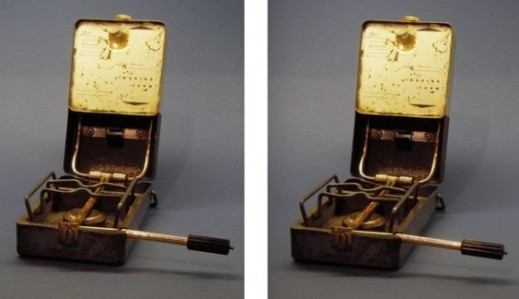

    ... but thought I'd post details in the Reference Gallery too and try an experiment in 'Stereo Pairs'. Take a look at this to prepare yourself for viewing the Turm in 3D
    Viewing in 3D

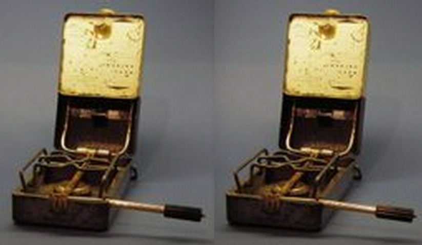

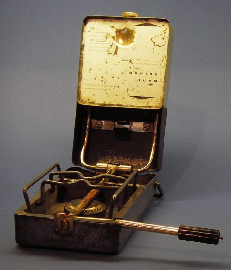

    Ok, the stereo pair
    The stereo effect is visible on screen with those cameo-sized photos side-by-side, using that technique the web article describes.

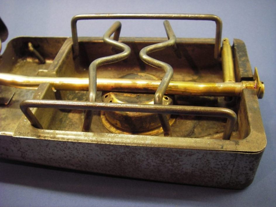

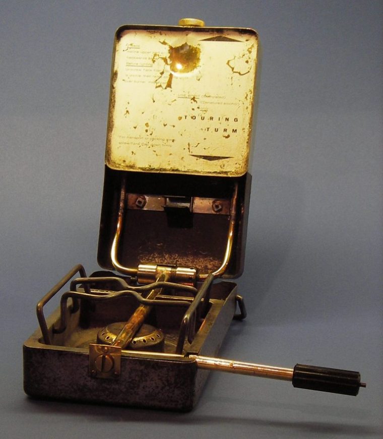

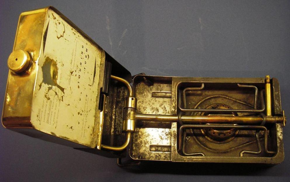

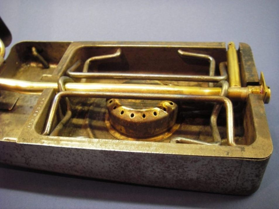

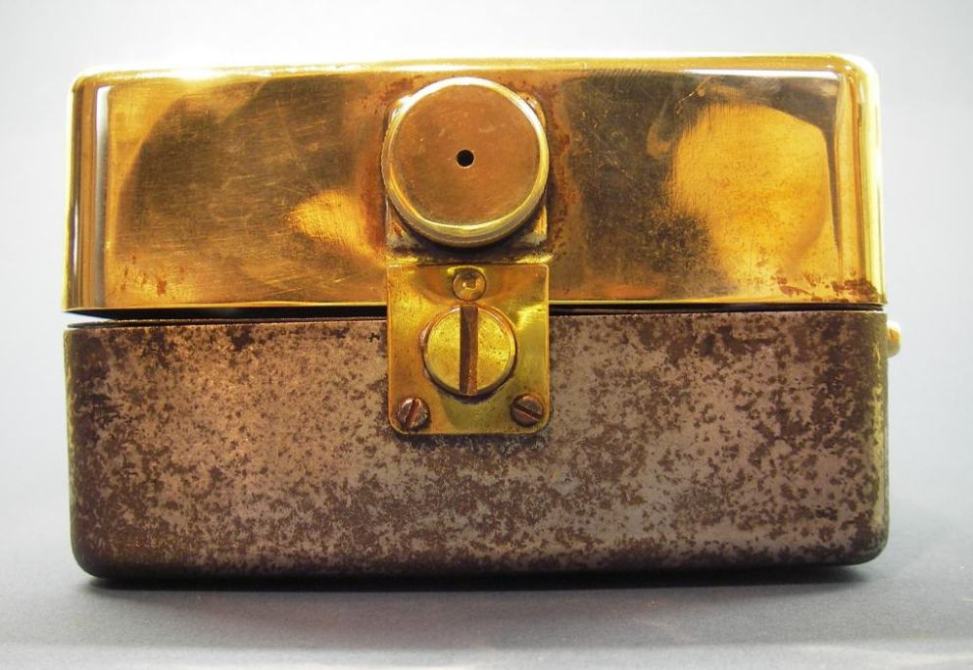

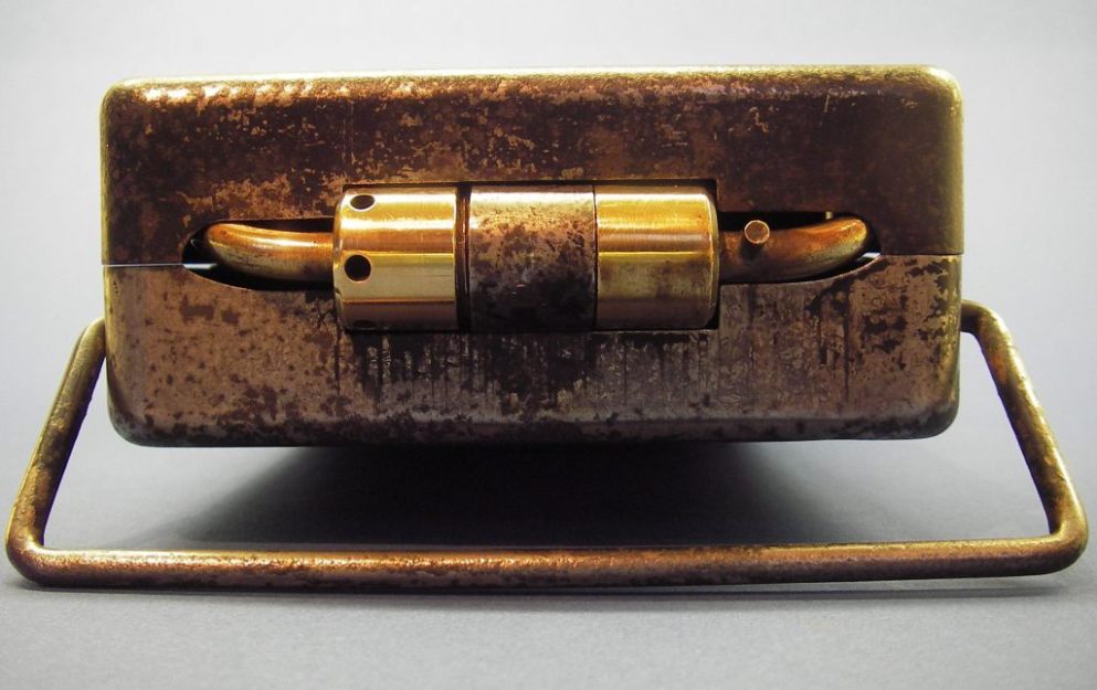

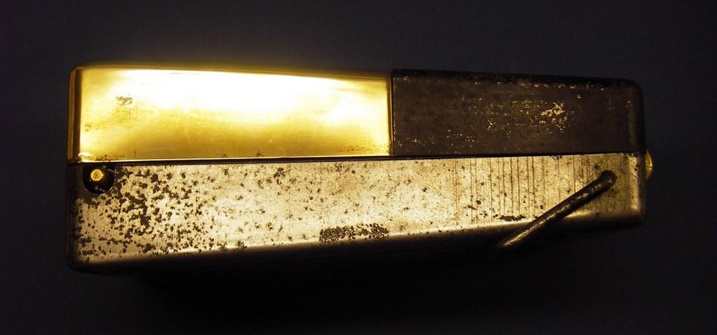

    Some other, 2D, shots of the stove
    1270035833-3a.JPG 1270035847-4a.JPG 1270035928-5a.JPG 1270035943-6a.JPG 1270035955-7a.JPG 1270035970-8a.JPG 1270035988-9a.JPG

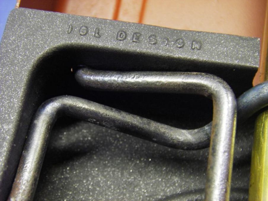

    The case and burner tray have been stripped ready for paint. I'll be using a satin, heat-resistant stove black for the burner tray (lanevitt recommended one by Plasti-Kote) and I'm considering a gloss high-heat maroon colour for the steel case.

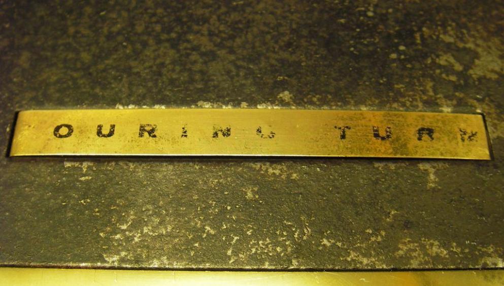

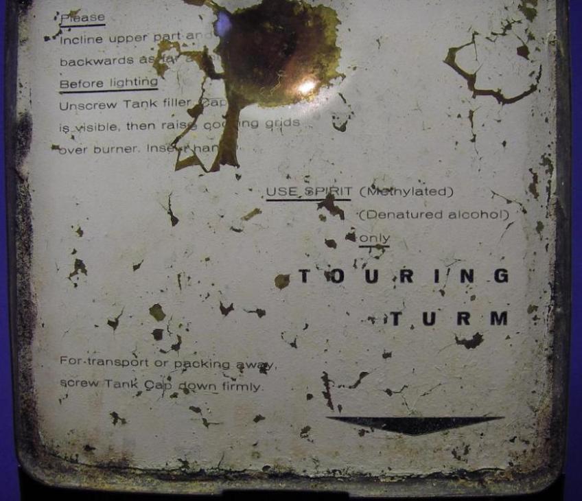

    Not much I can do about the worn user instruction panel though
    I might be able to restore the lettering on the nameplate however

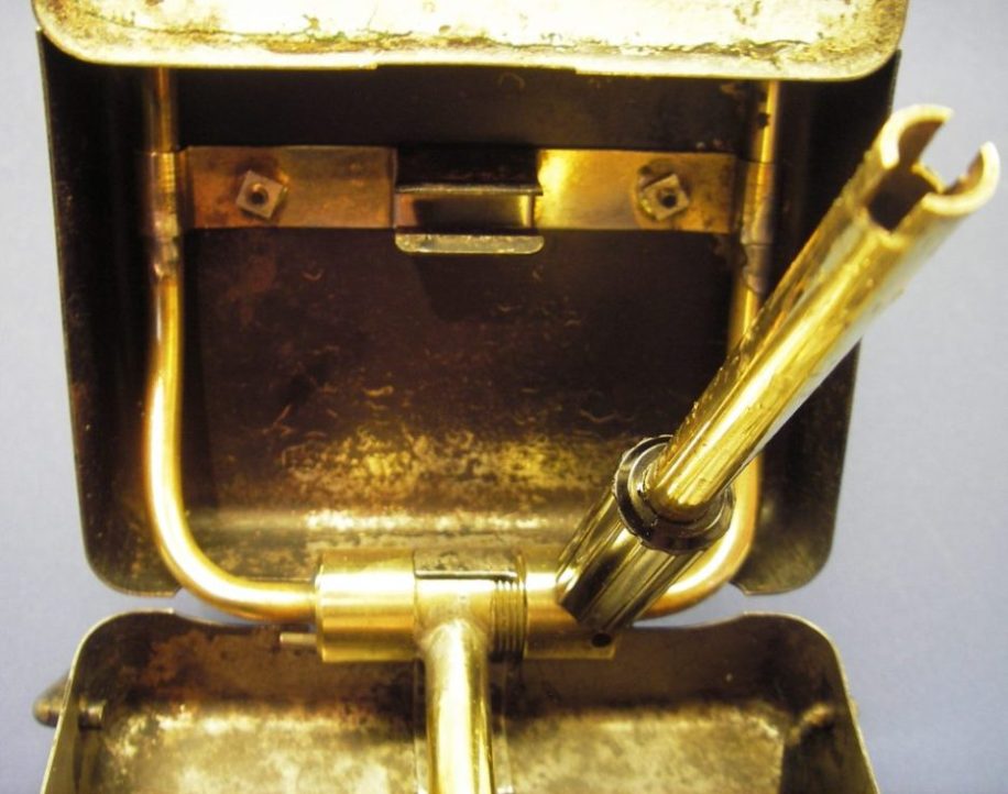

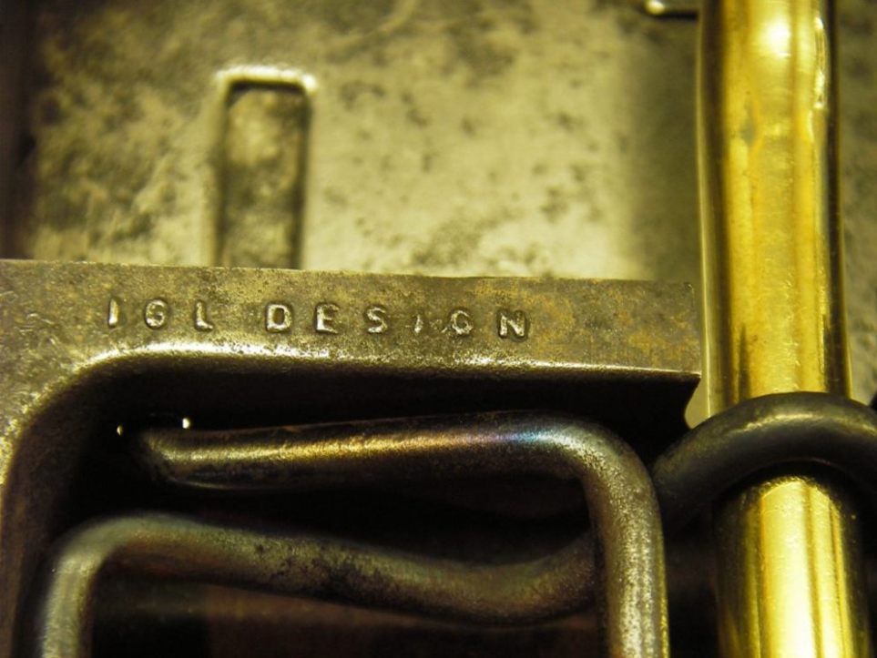

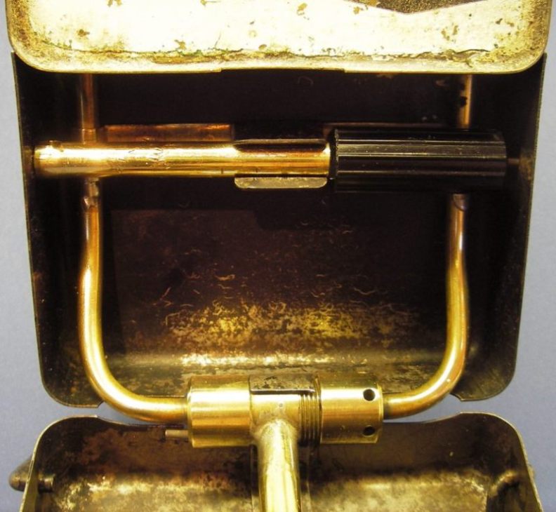

    Some more details

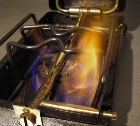

    Priming and firing the stove, including that distinctive 'Predator-face' burner/grid pattern

    Try grouping the 2 photos together as one pic so when you get a bigger pic you can view them.
  3. presscall
    13,948
    I haven't worked out how to do that on screen, Barra. I printed the 'left' and 'right' screen shots as hard copies and got the 3D effect of the larger images by holding them side-by-side though. That worked ok.
    I guess the right photo sofware could get a larger stereo pair image on screen, sure.

    Hi John, I have worked with stereo pairs in the past and had no problem seeing your Stove in wonderful 3-D.
    Unfortunately I can actually see three good 3-D images side by side.
    I have never had this problem before, and I haven't yet started drinking today.
    Should I visit the Optician?

    No, George, all's well. I see the 3-D image flanked by the left and right shots in 2-D so it's some peculiarity of the spacing of the photos or how they were photographed.
    I took the pair of photos by setting up the shot with the camera on a tripod and taking the left-hand photo, then moving the tripod and camera 6cm to the right (approximate distance between the eyes). I'd set the camera-to-stove distance such that I got a fair amount of background in as well as the stove and cropped each shot down with the photo software to frame just the stove for the final images. With tighter framing in camera I'd have had to pan the camera on the tripod to keep the stove in frame for the second image and I avoided doing that because I wasn't sure it wouldn't mess up the stereo effect. Landscape subjects aren't so fussy as close-ups for stereo pair photography and greater separation of the two camera lens positions is possible.

    Please don't think me ungrateful, but the 3-D effect doesn't really work with the bigger photos!
    On my screen at least, the distance between the same part of the image (end of the control handle for example) on each of your images exceeds the distance between the eyes (60mm or around two-and-a-half inches) by a fairly wide margin. That seems to destroy the stereo effect.
    I've practised on hard copy 'left' and 'right' images of different sizes now and different spacing between them and the optimum is images where there's a small margin separating them (3mm, or eigth-of-an-inch or so) and that distance I've quoted between the same point on each image. In other words, images larger than my original ones but a bit smaller (screen size) than those you've provided would be ideal.
    It may be that greater separation between the camera lens positions than the 60mm would give more flexibility in the viewing arrangements? Don't know, that's another variable I need to try!
    Thanks again,

    Hi John, This is such a great idea and the 3D effect will be fantastic with the smaller parts of a stove, with the larger image I can sit 3 feet away and enjoy the 3D effect, a trick when photographing distant scenes is to move the camera to the side even further (say 5 feet) to get the effect as 3 inches will not create the effect, for your images I right clicked on the image files (L & R) and saved them to disk, then made up a new blank image with a black background that was slightly more than twice the width of your two images and a little larger that the height, then copy the left image into memory and past it into the newly created blank image as a New Selection, then copy the right image into memory and paste it as a New Selection so that it just touches the right side of the left image, then Crop the newly created image, the program I use is a vintage version of Paint Shop Pro.

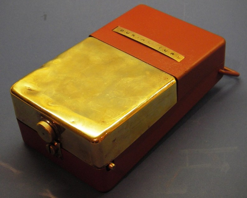

  19. presscall
    13,948

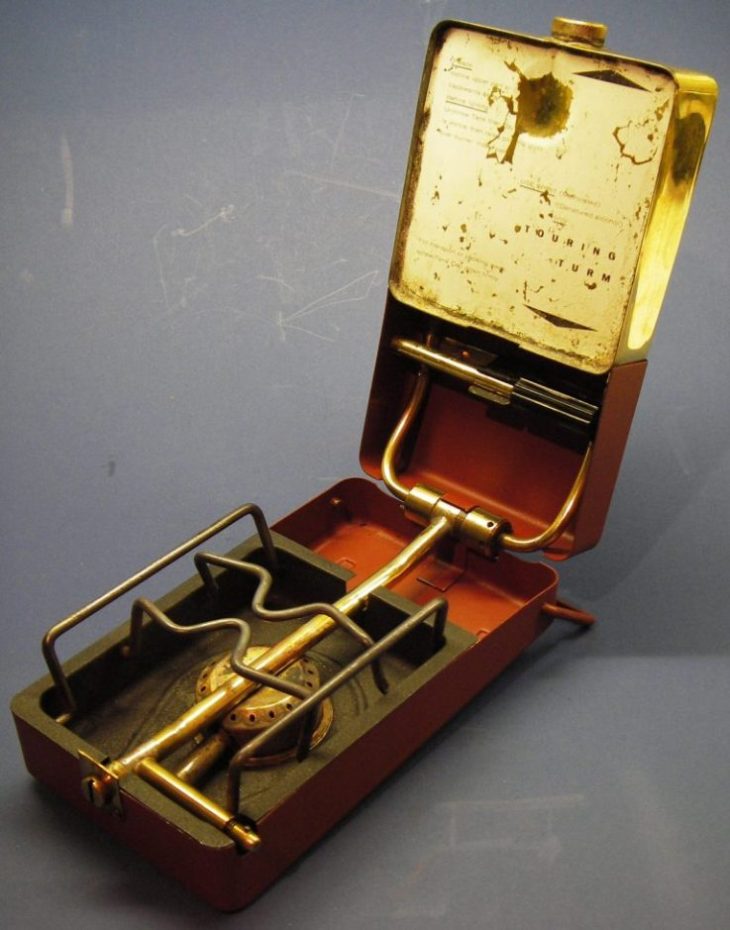

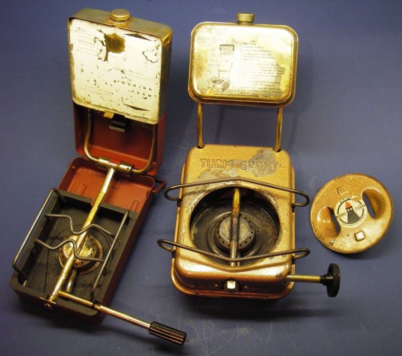

    I got around to painting the Touring Turm, using high-temp maroon ('Mojave Red' was the name on the can) and high-temp metalflake black for the burner tray
    Here's the Touring Turm alongside a Turm Sport I've also featured in the Stove Reference Gallery

    I have to say that I don't think the repaint does the Touring justice. The black and gold look really classy. But eye of the beholder and all that!
    Btw, your article on fettling the beast was awesome, and responsible for me hunting one of these beauties down!
