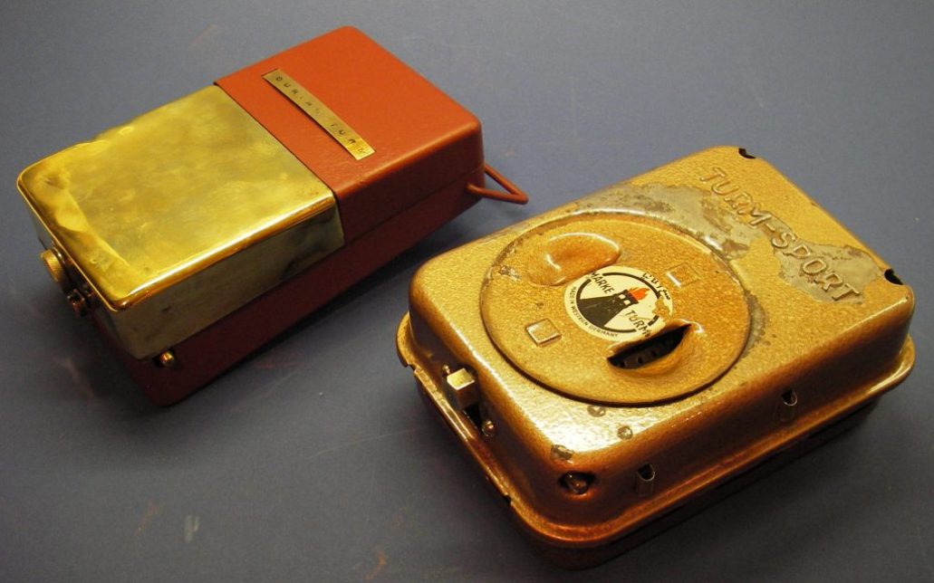

    A peaceful calm has descended on home and countryside since I've taken a break (temporarily) from roarer burner stoving with Gary's minicap on the Svea 123 and the use of meths-burning stoves. Latest of these is this Turm Sport
    I've given the Touring Turm a coat of high-temp paint since I featured it in the Stove Ref Gallery

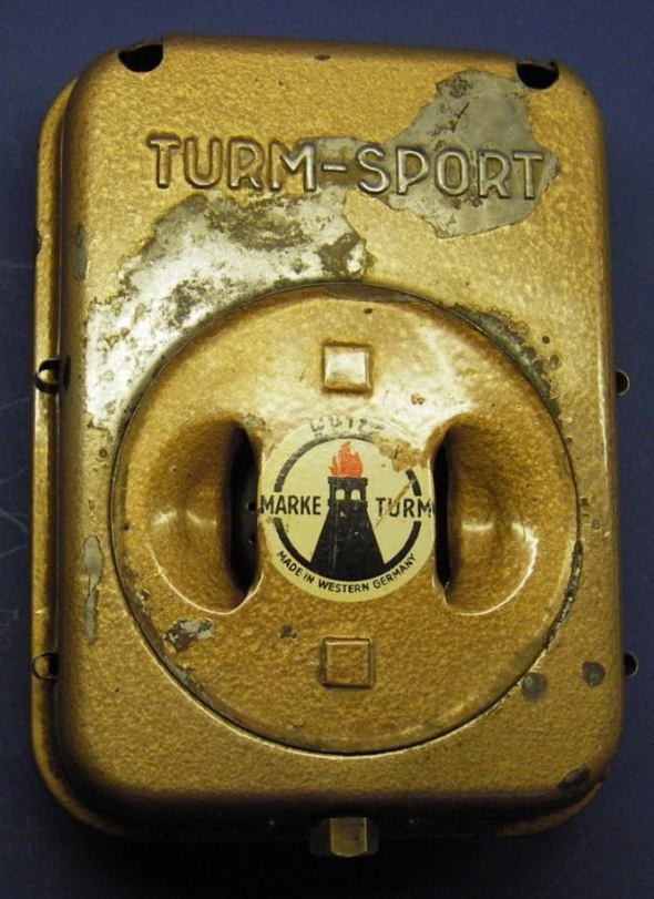

    The Turm Sport's got some amazing bodywork made up of complex steel pressings. This spring-loaded button ...
    ... and this folded lip at the other end of the case ...
    ... are part of the arrangement to pack the stove and open it up for use

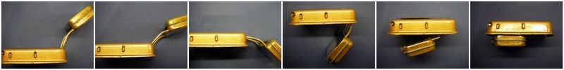

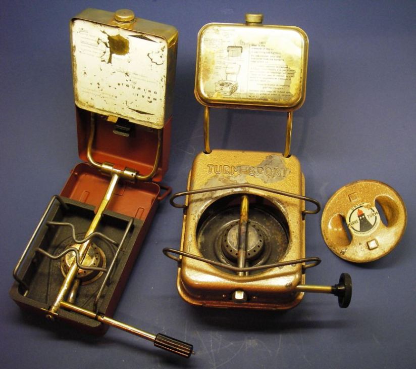

    Here's the stove ready for folding, with the 'lid' set to one side ...
    ... while the fuel tank flips around and into the storage position
    The action has been well thought out, making sure that clearances are just enough to allow everything to stow away

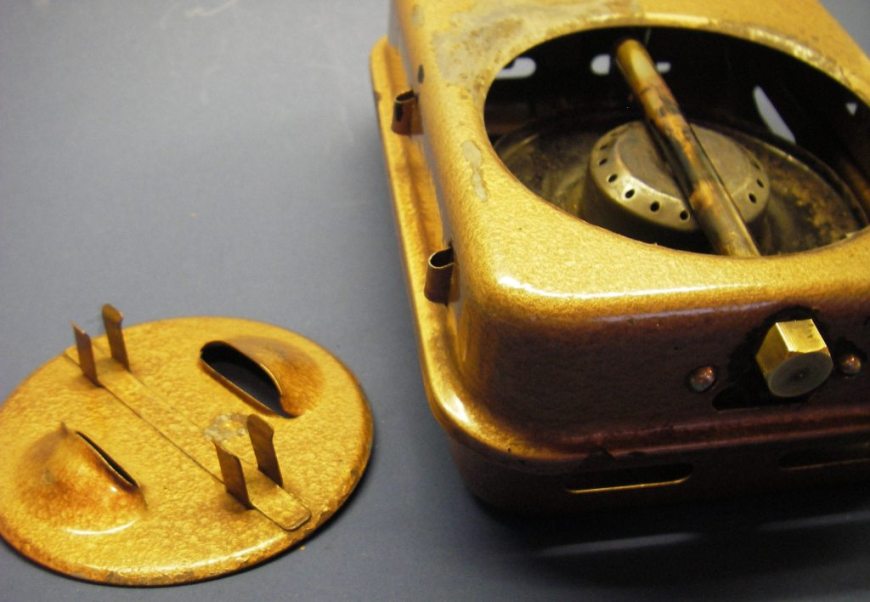

    The cover set aside while the tank was stowed goes over this ...
    ... and a circular plate clips onto the burner tube

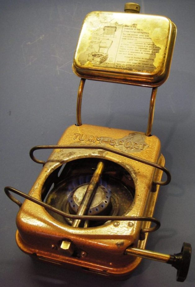

    I set the flash on the camera to pick out the complexity of the internal ribs and brackets for stowing the pot rests away

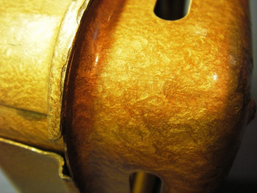

    The paint has a lustrous quality I like, so although it's flaked off in places I'll not be stripping this like I did with the Touring Turm

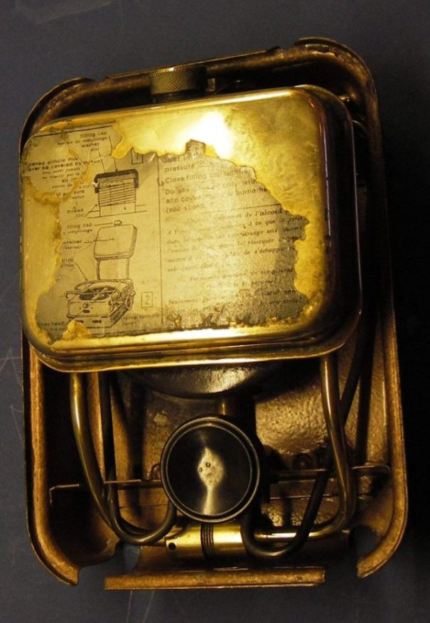

    The instructions (what's left of them) printed on the fuel tank

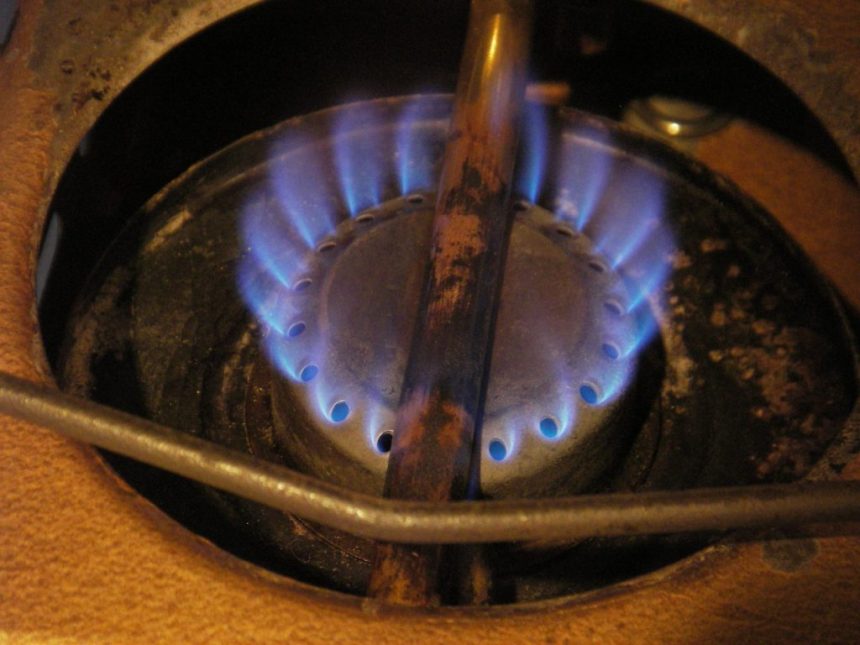

    The filter was in poor shape, so I made a new one as I did for the Touring Turm, taking more strands of fibreglass from the solder mat. It made all the difference to the burner's effectiveness

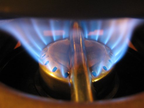

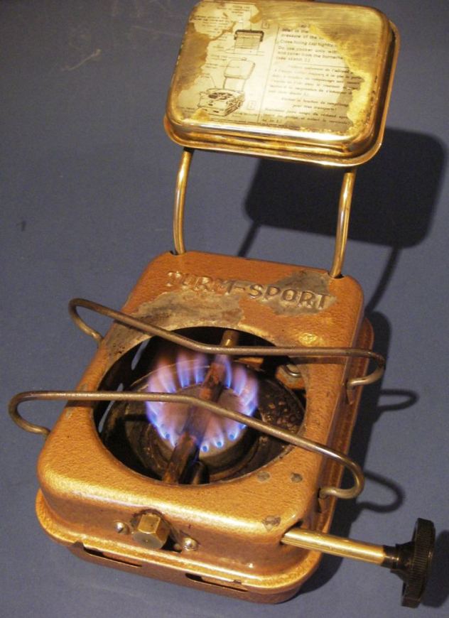

    The flame's controllable from a really low simmer right up to full pitch. I've noticed too that a replacement filter prevents the tendency of these stoves to flood when the burner's adjusted to full heat. With a decent filter, it just reaches a maximum and goes no further

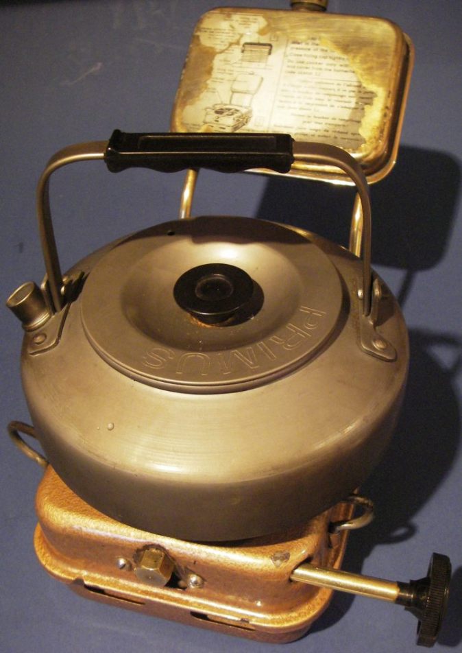

    Those pot-rests allow for a variation in pot base size, from a 'wide' setting ...
    ... to a 'narrow' setting for pots with a narrower base

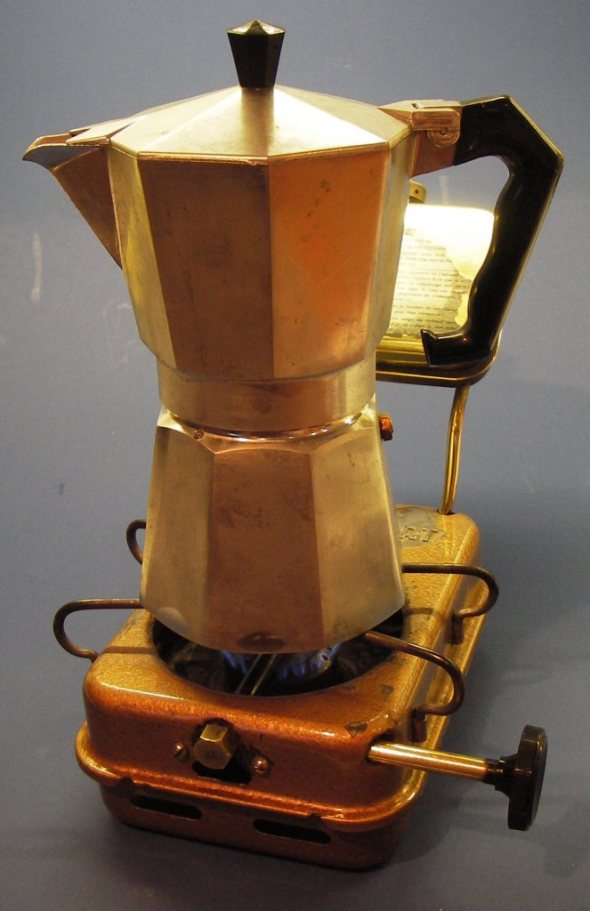

    The styling of these Turm packaway stoves is distinctive. I reckon the '50's styling of the Sport model and the 70's styling of the Touring version mirror the styling of automobiles of those decades - curvy '50's and wedge-shaped, angular '70's designs
    Maybe the notion of automobile styling isn't so far-fetched. The 'hood' air vents on the Turm Sport reveal the carburettor beneath

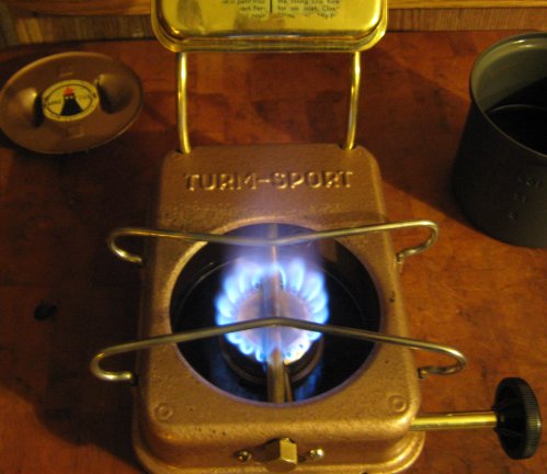

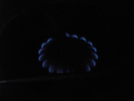

    Well after a few minutes the flame started to dye out - I scratched my head and then remembered from my other gravity fed meths stoves, the filler lid must be able to pass air to allow for the flow of meths. My Punkers have a hole in the top of the cap to allow for air to pass in . Well the Turm Sport does not have such a design , so the filler cap must be loosened to allow for air to pass into the tank. I loosened the cap a little and she runs fine. But then when you go to stow the stove you must remember to tighten it back down tight and of course when you use it again , one must remember to un-tightnen it for running. This is the only issue I have with these otherwise super running meths stove
    here's mine :
    Fullout
    Lovely simmer

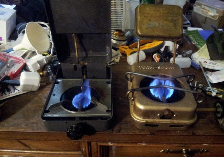

    I finally procured myself a Turm Sport... Shown here with my Vulcano. If you look closely at the pot stands, you'll see that they're not the original ones. I had to fabricate a pair to fit this one. Let me tell you, it wasn't easy to bend the rods. In fact, they broke, so I had to weld smaller rods at the base of the curl. I had contemplated using brass, and I still might. Anyway, for your approval... 1367890320-3.5_x_5_in.__4_.jpg
