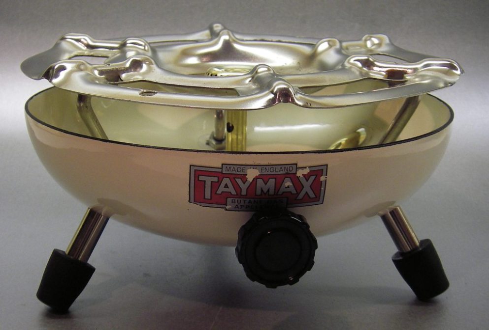

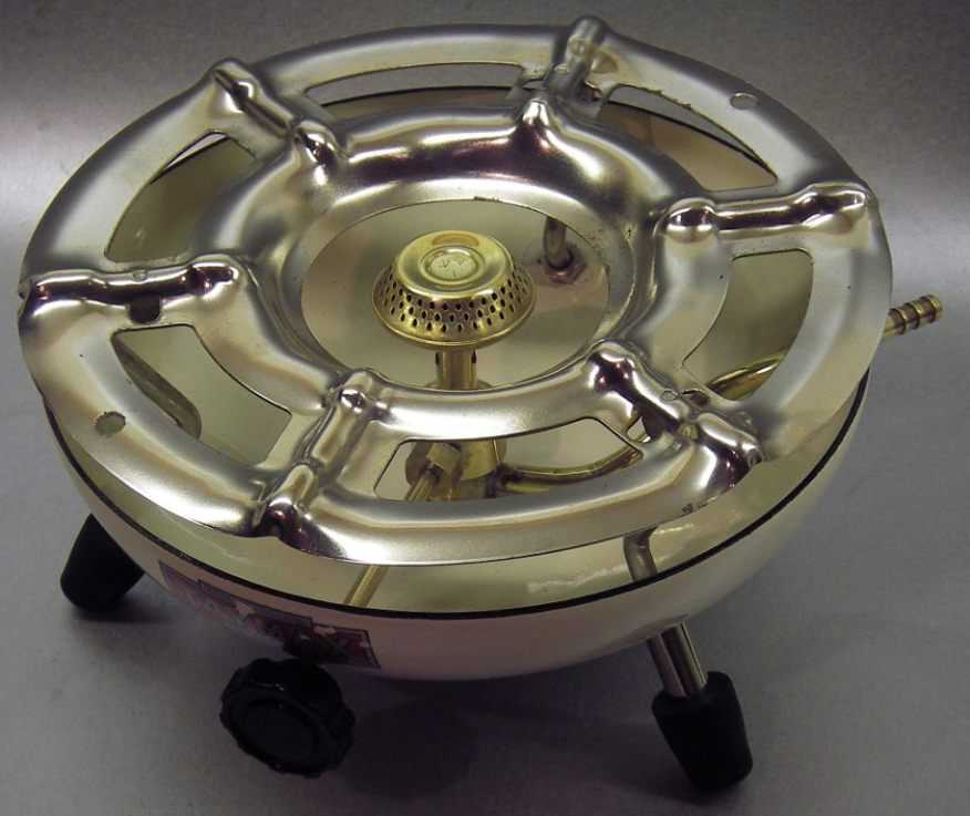

    Ok, the reveal, it's a Taymax butane stove

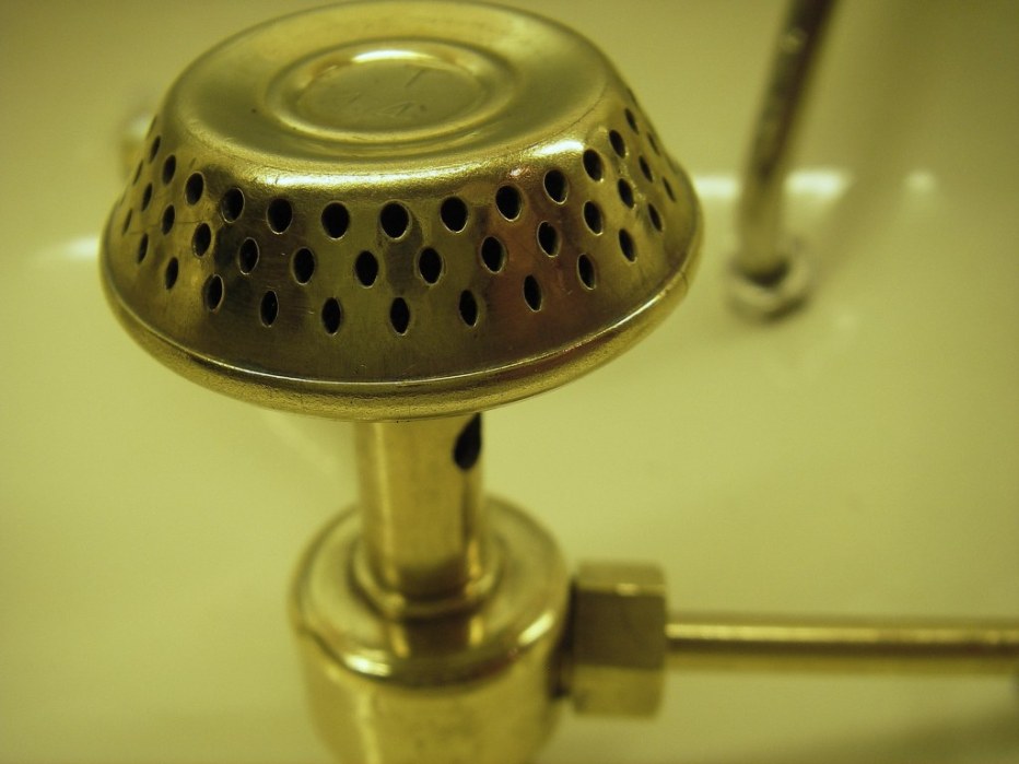

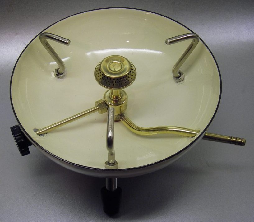

    The pan ring, a kero 'brassie' No.5-sized stove pattern, unclips and gives access to the burner.
    That bowl is of heavy-gauge enamelled steel and though it's functional in that it holds the components together, it's just a design feature to create the low-slung flying-saucer look
    The burner's equipped with a jet nipple that would work fine on a British paraffin stove. I tried it and it did
    Definitely a butane burner though
    The burner's bolted to the bowl

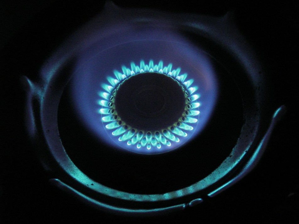

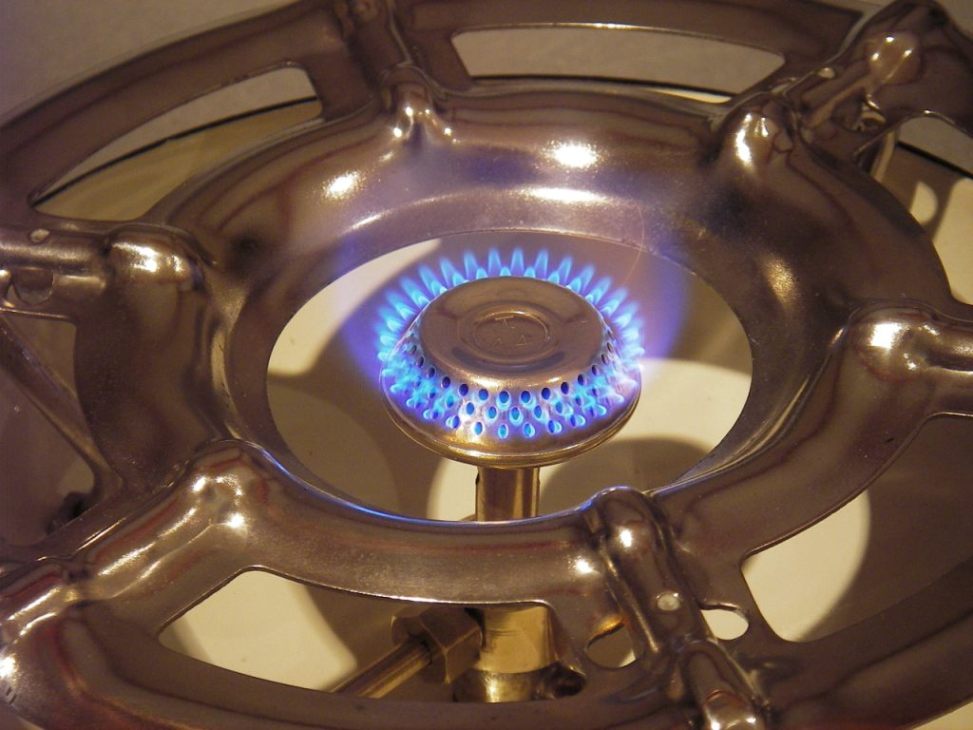

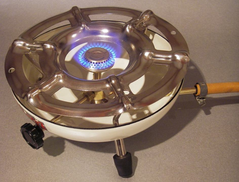

    Tempting to connect a gas bottle ...
    ... so I did

    Neat stove. Looks to be very stable and designed to fit into the kitchen.
    Thanks for the post and great pictures!
    What is the age of this stove John?

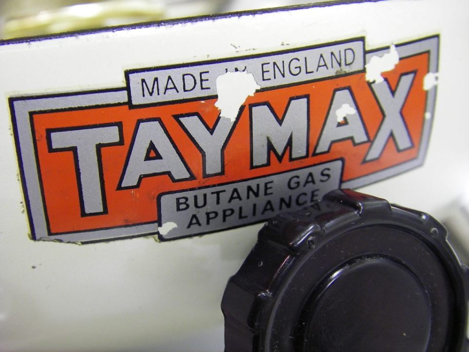

  5. presscall
    13,939
    I'm guessing seventies, Jeff. I've an idea it was produced by Taymar, who still make gas appliances (blowtorches as far as I can make out).
    That pattern of control knob is theirs. How do I know? First butane blowtorch I owned (no longer have it) was a seventies purchase from new. I'd recognise that knob anywhere (if you'll pardon the expression).
    You're right about it being a kitchen 'appliance', the cream enamel is the clue.

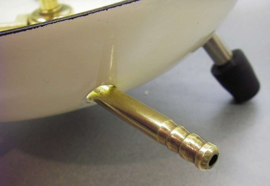

    John, very cute stove , nice runner too
    Does it have a regulator involved or do you hook it up straight to a propane bottle without a regulator ? Do you know the running PSI ?
    Sure looks good !
    Tom
  14. presscall
    13,939
    and
    No regulator. For the firing test (and out of the photo) was an ordinary screw-fitting butane/propane mix camp stove canister, an adaptor and flexi pipe from a 'donor' cheap import gas stove connected to a short length of rubber hose equipped with hose clamps, one of which appears in the photo.
    It was a clumsy-looking (but gas-tight) arrangement that I kept out of shot because that dreadful gas canister tragedy in Norway was topical news and I didn't want my jury-rigged arrangement to appear disrespectful by suggesting that I was at all casual about stove safety. If I were to put the stove into regular use I would of course equip it with a proper gas supply.

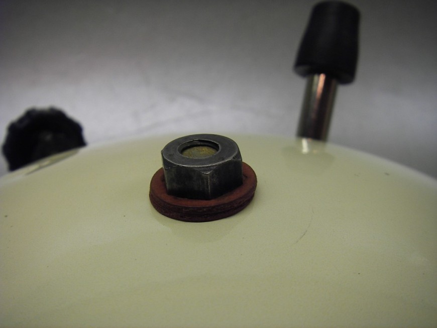

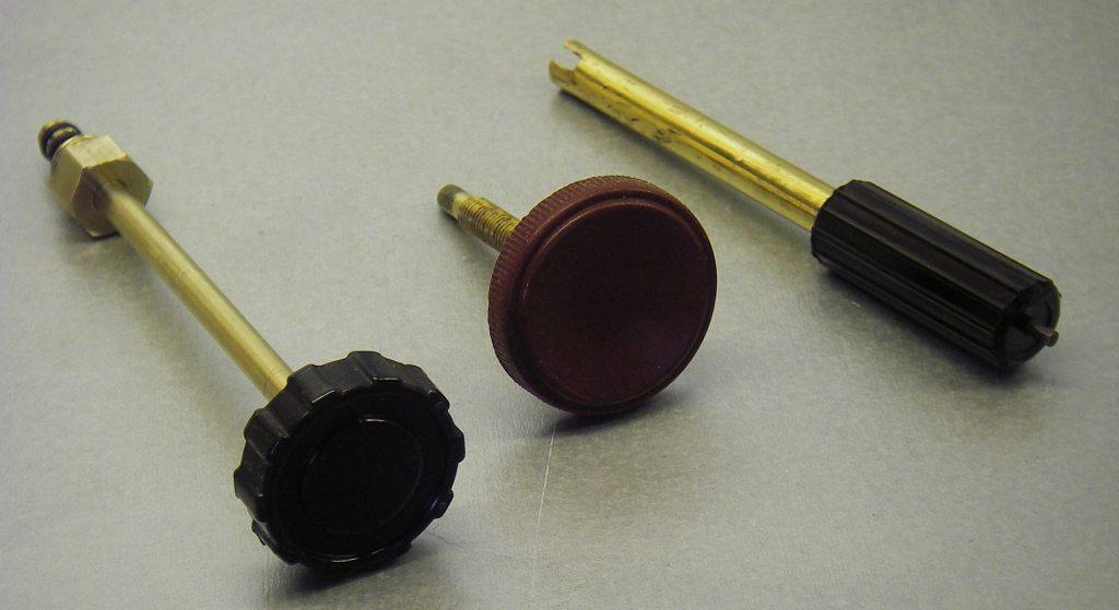

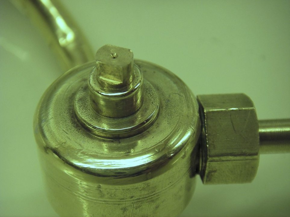

    Could be wrong but I think Takeshi's possibly referring to the regulated burner, John - the control knob and spindle seems to have gone adrift in one of your images on the 'Stove Trail' thread...
  16. presscall
    13,939
    Yes, see what you mean. I took the control knob and spindle out of the burner to provide another 'clue' then forgot to include it! This was the picture, caption would have gone "Turn, Turm, Turm" (paraphrasing Bob Dylan)
