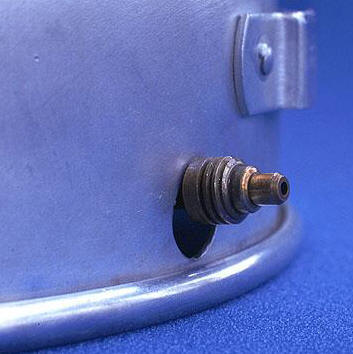

    The KAP-Arctic consists of a Trangia stove with a built-in kerosene burner. The pump is located in the fuel bottle, and is connected to the burner by a flexible fuel hose. The flame adjuster valve is situated on the burner, and the flame can be regulated with high precision. Turning the valve beyond maximum will bring up a small needle that cleans the jet from debris.

    The burner with its holder, ignition groove and fuel pipe at the bottom.
    The holder for the burner has an ignition groove provided with a wick.
    The holder makes the burner fit nicely into the lower Trangia windshield. In the ignition groove to the right it is
    easy to poor a small volume of alcohol, and thanks to the wick it is also possible to ignite it here.
    The end of the fuel pipe snaps to the upper edge of the hole, and fixes the burner firmly to the lower Trangia windshield.
