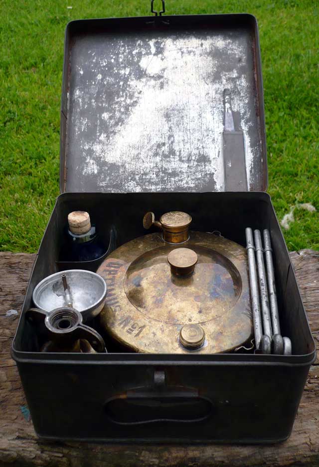

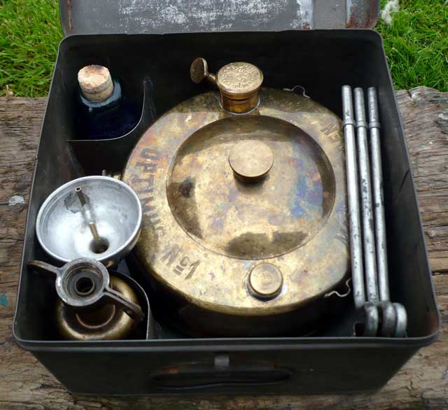

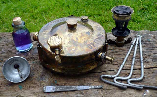

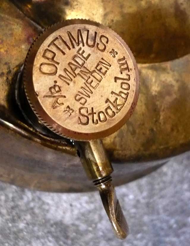

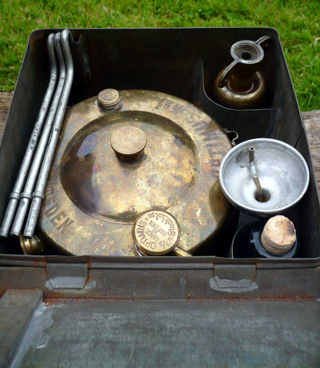

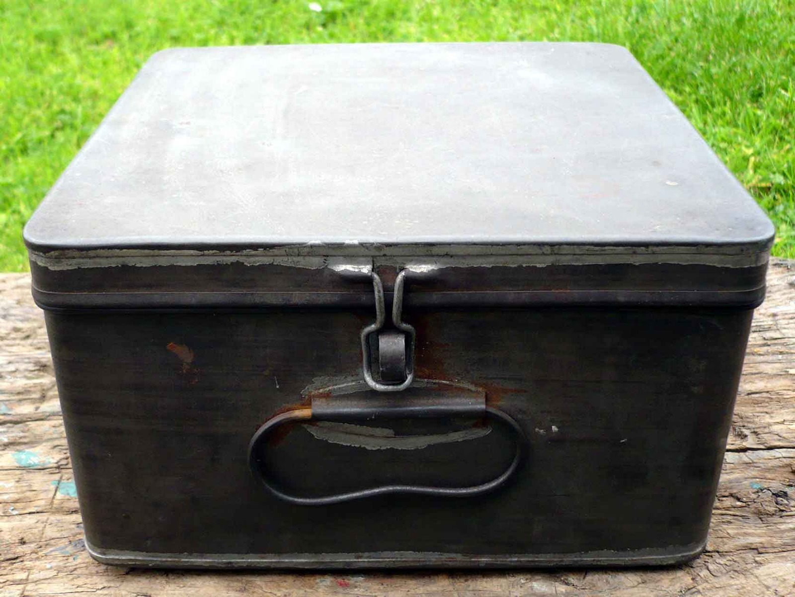

    Hi Here are some photos of an early Optimus No.1 Traveller outfit which I was very generously gifted recently:
    What a wonderful gift and great stove.
    I eventually managed to free the cover-cap to give me access to the NRV. I then removed the NRV after soaking it for 36 hours in releasing fluid.
    The original (almost 100 year-old) cork washer had dried out to about the size of a small grain of rice, so I replaced it with a nitrile "pip" and added a new brass spring.
    This NRV cover cap has to be kerosene-tight, and originally relied on a thin lead washer. I have now made a thin nitrile washer for this joint and eventually managed to get it sealed.

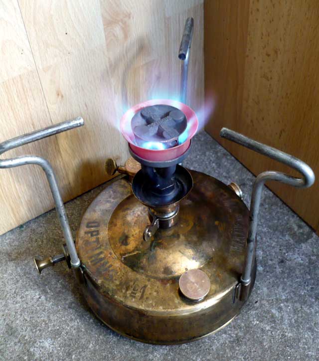

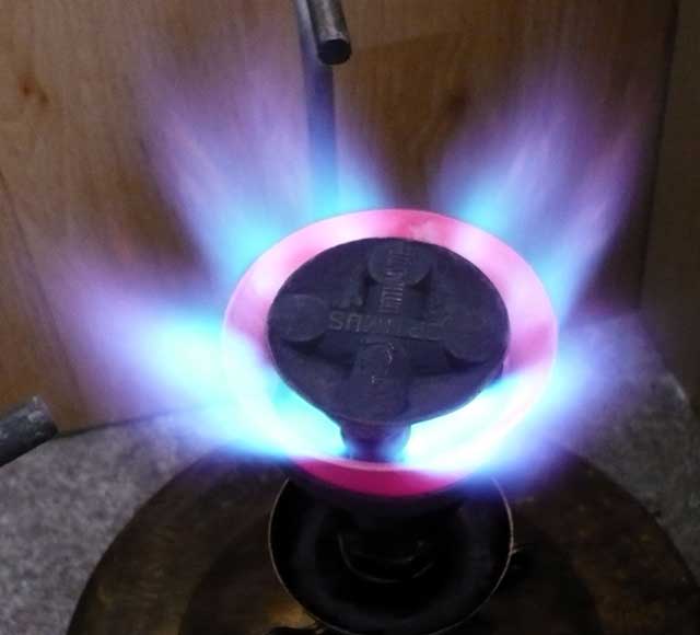

    The stove is beautiful, and easily passed the "Tea Test". The flame is very powerful, and a beautiful blue colour, which continues to improve with use.
    I believe this stove probably dates from around 1914/18, so it is not far off 100 years old. How many of our current manufactured goods will be performing to original specification in another 100 years?
    I have replaced both the glass spirit bottle and filler funnel with, hopefully, near contemporary items.

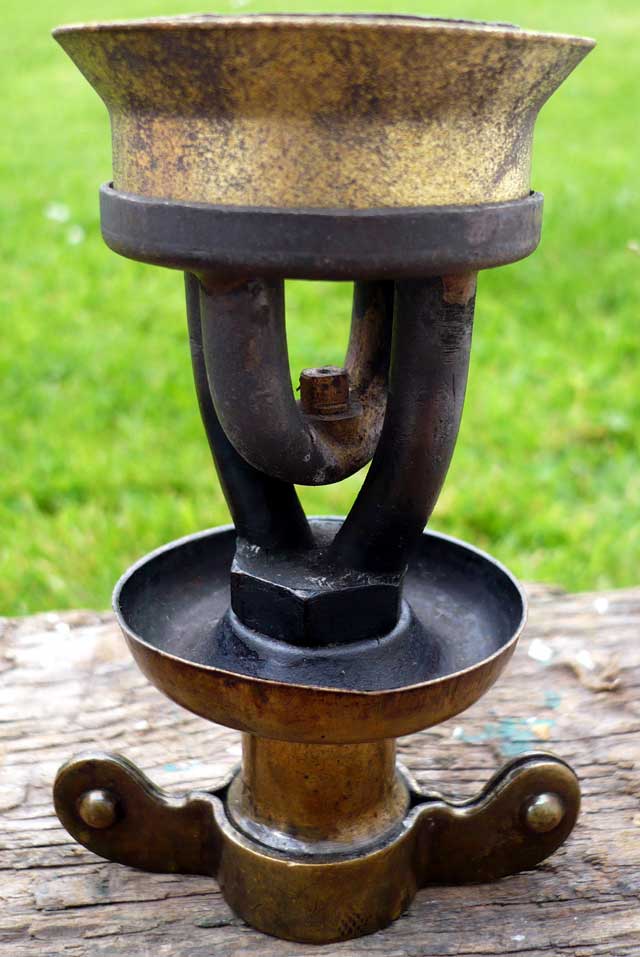

    I like the wing nut Idea,shame that never carried on.

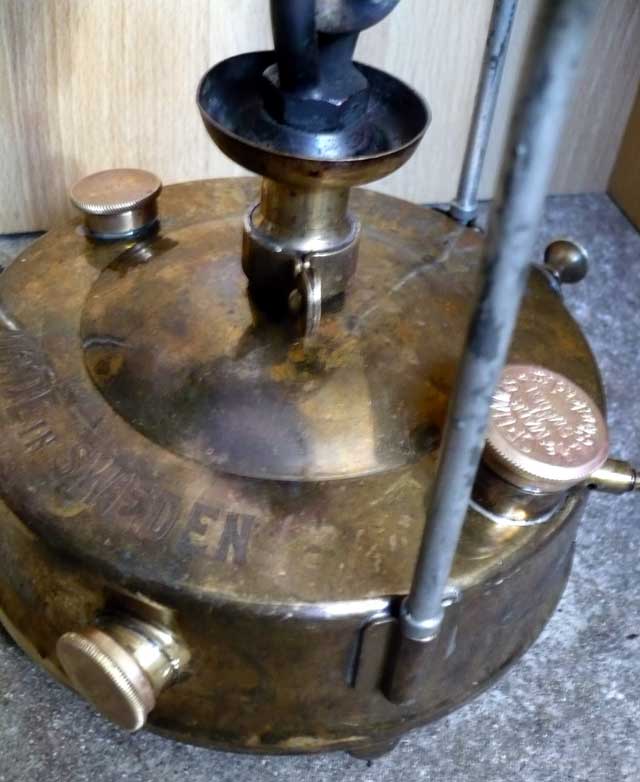

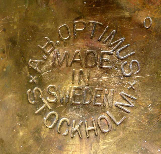

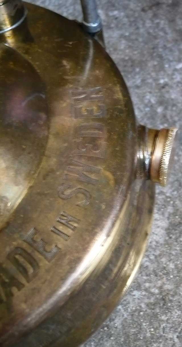

    George, is that raised lettering on the bottom of the tank?
    If so, I wonder how it was done, is each letter soldered on.
  6. kerophile
    14,341
    Hi Gordon, yes it is! I only really appreciated it when examiing the photo. It is achieved by using a die with female letters, and a bloody big press or rollers, I believe. Of course it has to be done before the bottom section is attached to the tank.
    George.

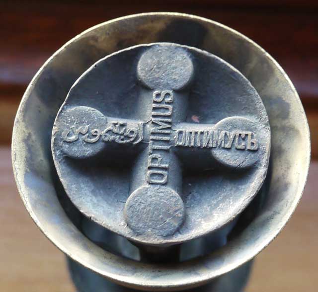

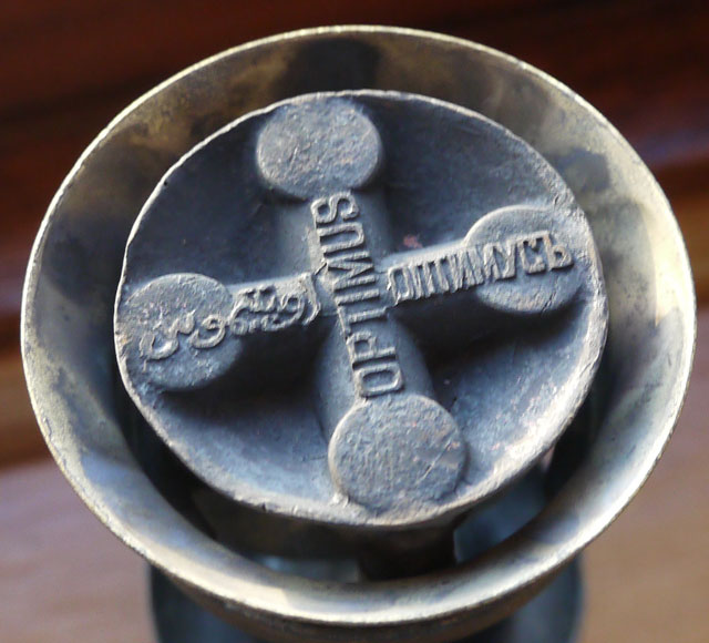

    Hi, here are a couple of photos of the top of the burner head of this stove:
    1383753534-St.329.-Op.No.1-outfit-1.jpg 1383753557-St.329.-Op.No.1-outfit-2.jpg
    The Cyrillic lettering is in the "old", pre-1918 style with the "hard" symbol, later dropped.
