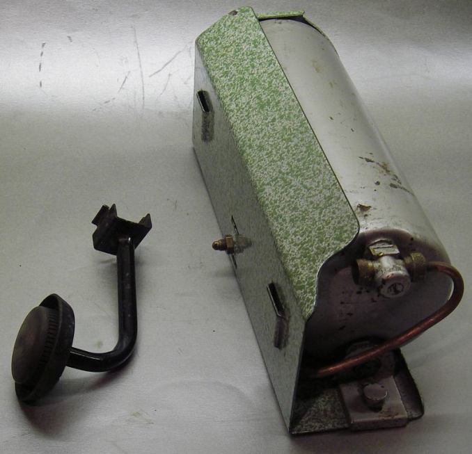

    Lilor Camping "363" Repliable (repliable = folding) is how this butane stove's named in the instructions that came with it.
    Its 'folding' abilities are somewhat limited however ...

    ... well that's about it as a 'folding' stove, and its a fair size too.
    Here I've set it alongside a Svea 123 and one of the cheap imported butane cartridges I've used to replenish the Lilor's gas tank - three so far and with room for more
    The jet nipple emerges from the pipework behind the enamelled heat shield ...
    ... and the burner just hooks onto the slots in the shield
    That spatter-finish green and cream enamelling is quite something!
    Here's the other end of the tank and housing ...
    ... and the end with the control valve
    Here's the gas tank separated from the heat shield, exposing the copper tubing feeding the gas from the control valve to the jet nipple
    Some details of the control valve and the 'Lilor' name embossing on the tank and incorporated into the valve casting

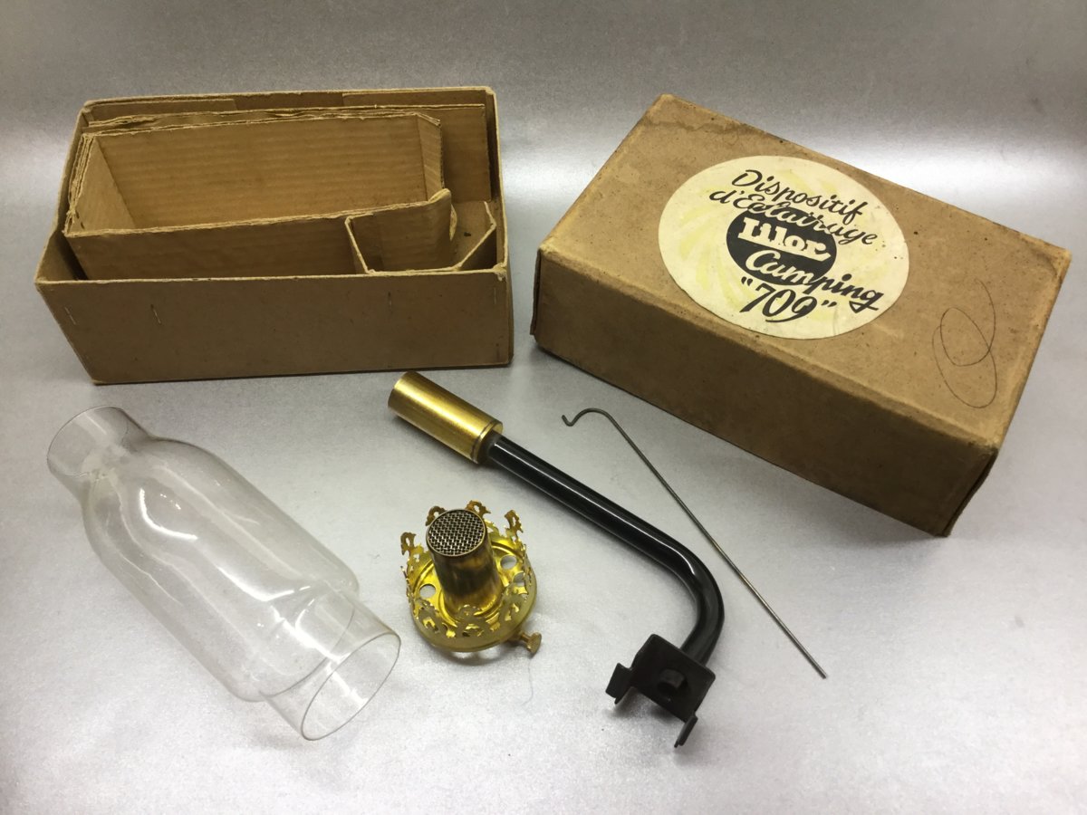

    Just seven years later (!!!) I finally acquired the lighting attachment. @richmay. Thank you Richard for the heads up on the auction.

    Excellent! :thumbup:
    Seven years... as @Matty said to me recently, "Grasshopper, patience".
