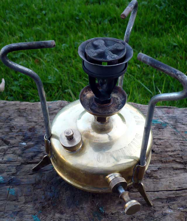

Hi, here are some photos of an Optimus No.00 which I acquired recently. This Optimus No.00 has a Primus style tin, and a burner marked Optimus-Primus, so I reckon it dates from fairly soon after the formation of the PTC in 1962. Best Regards, Kerophile

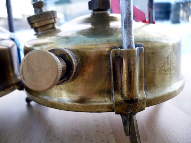

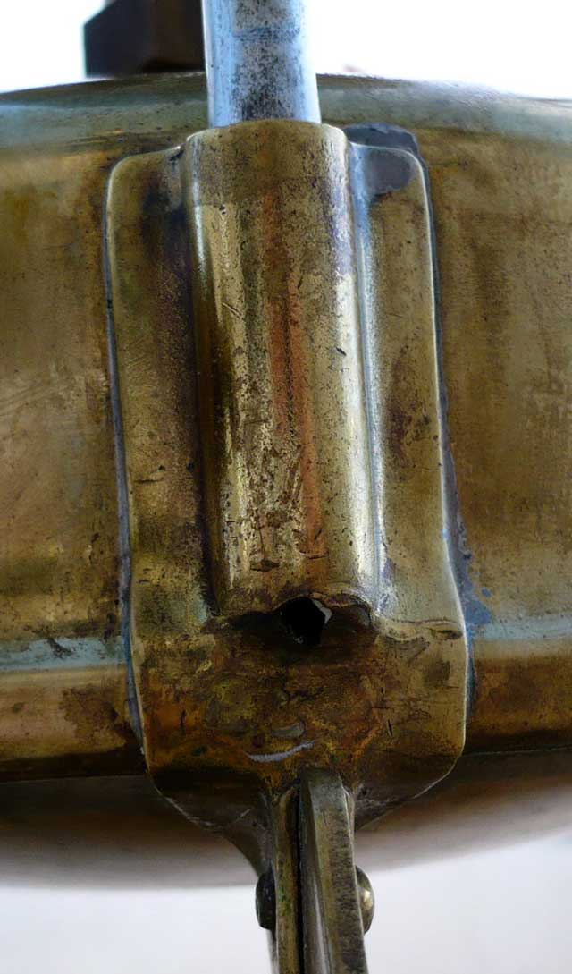

Hi, I have taken some additional photos of this post-1962 Op.00 to illustrate the distance from the pump-tube to the nearest leg-socket: and to show that this particular Op.00 has "drain-holes" at the base of the leg sockets: Best Regards, Kerophile.
