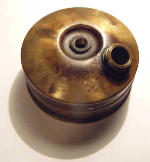

    Finally. This SVEA 123 First Generation Sievert has been sitting in the queue for months. I was able to do a tear down of it and replace the wick and the filler cap gasket.
    During the tear-down I found some really interesting parts compared to contemporary 123s. The valve stem is quite different than later models, along with a few other differences.
    As it turns out, it took just a few minutes to clean it up and put it back into service. I thought about doing a full polish and then decided against that so that we can preserve the fact that this beauty was well used and well taken care of. I did nothing to the stove except for what I mentioned above.
    Some interesting points about this stove:
    • It's old and still works!
    • The jet has some engraving on it.
    • The control key is longer than later model 123s.
    • The pot handle has some engraving on it.
    • The tank cap has engraving and lettering.
    • The flame spreader is marked as well, '9400'
    • The windscreen is engraved SVEA 123
    • The valve stem is a different shape and threading.
    • The tank cap has a bulbous SRV container versus a straight cylinder on later models.
    • Burner bell has some engraving on it as well.
    • The wire holding the wick is thick and rigid.
    • The chain is similar to that used on Primus 71s, etc.

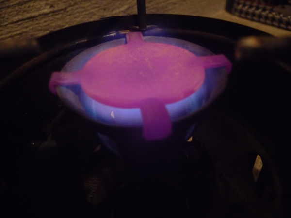

    Here are the flames:

    Hi, Perfect flame! Nice photo-essay too.

    Great pictures and flames!!!
    With that tank lid and key that is a 3rd generation 123.
    That said caps and keys can change over time.
    Awesome stove! Thanks

    Gosh darn that's a pretty blue flame. A very nice old Svea 123 -- and a very nice photo shoot.
    Thanks!
