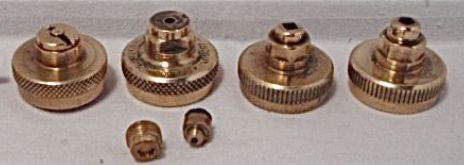

    I think that the sequence of the Optimus petrol tank lids is as follows
    Sorry for the quality of the photos but they have been cropped from other photos. The pressure release valve was inside the lid. The centre of the lid unscrewed to expose the spring and piston. These were in use in the 1930s but were probably also in use in the 1920s when Optimus first introduced the extending type of petrol stove
    These are a sequence of later Optimus petrol tank lids
    The left one was definitely in use by 1958 but was probably in use earlier. It continued in use up to the mid 1970s.
    I think that the next one was made by Sieverts and if so it could be an original fitting on Optimus stoves from 1969.
    The third one appears to have been used for a short period of time as it is relatively rare. The last one is the one that I believe is the last one used by Optimus. Rick has mentioned that it was on a stove bought by him in 1976 so it looks if that was when it was introduced.
    However the left lid was definitely in use when the 99s were introduced so there may be some about with that lid.
    Unfortunately lids are easily changed so whilst they are indicative of the age of a stove they are not positive proof that the stove came from the same period as the lid when a stove has been bought from a previous owner and user.
    Regards Bryan

    I have been trying to pin down the date of the change between the tank lid on the left and the vertical knurled one two to the right.
    It transpires there are at least three other tank lids in use on Optimus petrol stoves in the period between 1962 and 1976.
    1300134726-60s_80_stove.JPG 1300134746-60s_71_stove.jpg 1300134767-70s71L_tank_lid.JPG
    The two left ones are from Optimus made stoves with burners made no later than around 1970 so I assume come from the 1960s although this is not definite.
    The right one is from an Optimus made stove fitted with a burner that Optimus first produced in about 1970 so I assume that the stove was made between 1970 and 1976 when Optimus stopped making Primus stoves.
    It looks as if there were numerous versions of the petrol tank lids in use in the early 1970s
    Sorry for the confusion that I caused
    Regards Bryan
