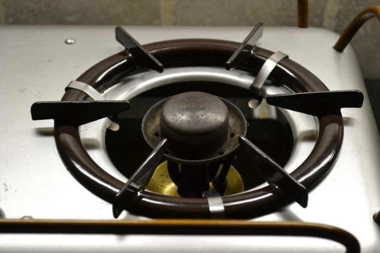

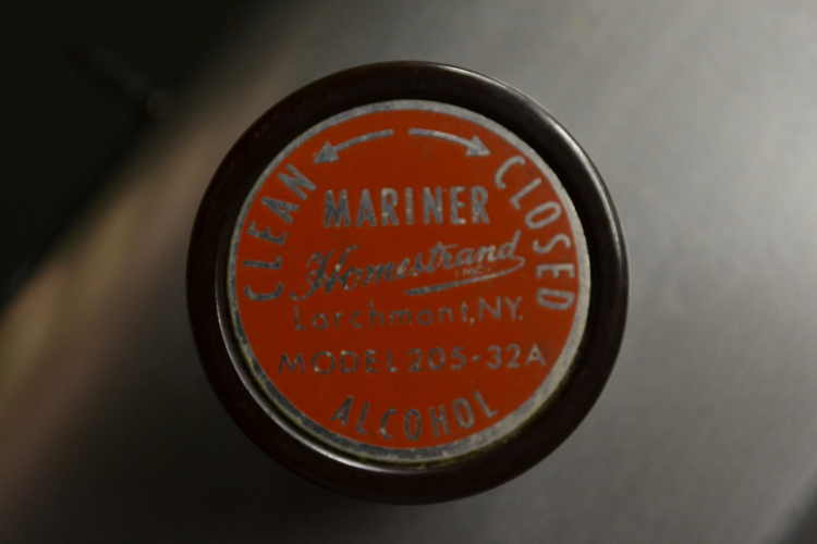

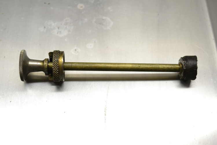

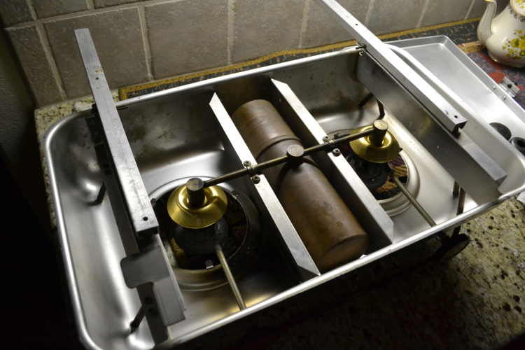

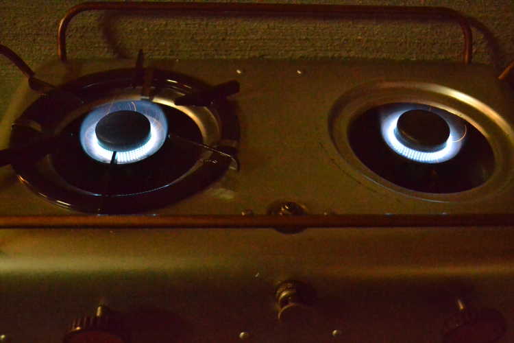

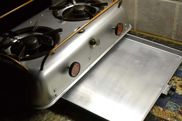

    Here's my Homestrand Mariner alcohol marine stove. A very nice item to add to the collection. In another thread I asked about converting this unit over to kerosene. This is a show of the stove after the conversion. All I had to do was change the jet, the cleaning needle and remove the air restrictor tube. Flame shots will follow.

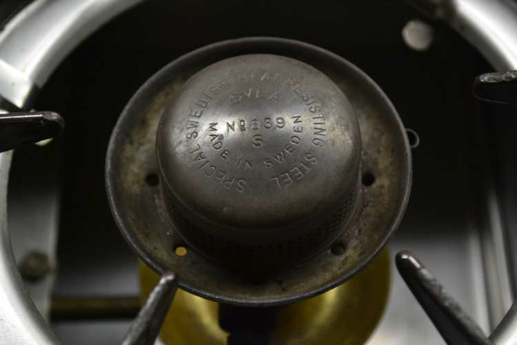

    This stove has the Svea 1915 burners with Svea inner caps and the Svea outer caps. A very fine sample. The caps are numbered 839 with a letter 'S' for spirit. The same stamp is on the jet as well.

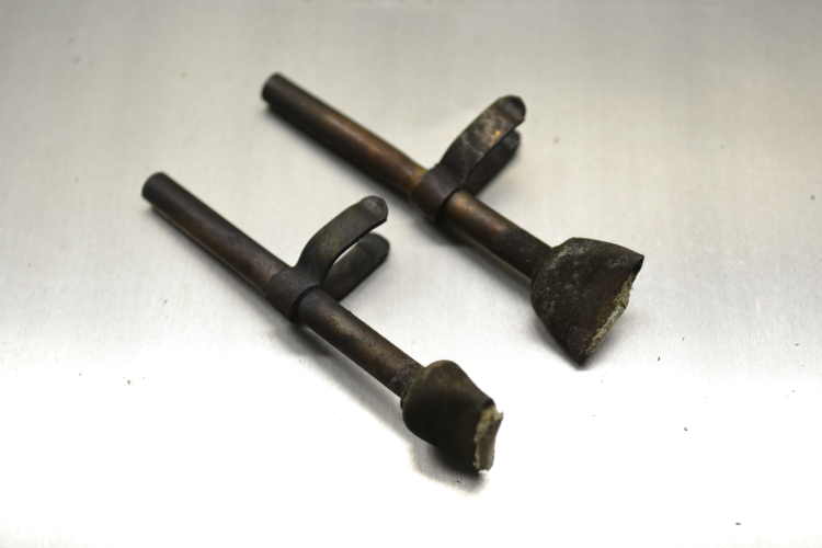

    I fortunate enough to get the drip pan, lighting tubes, inner caps, and mounting rails. Looks as though this stove has had very little use.
    sam

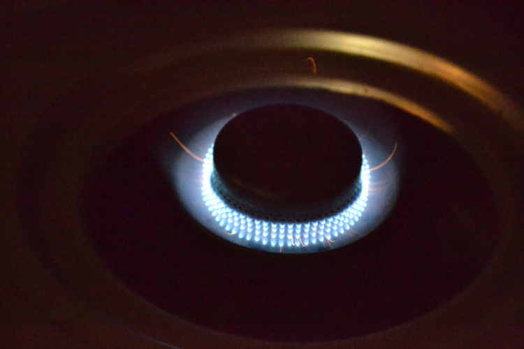

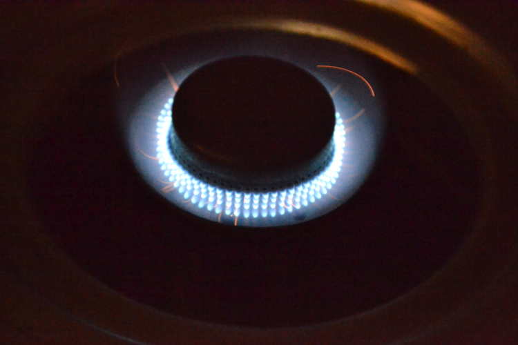

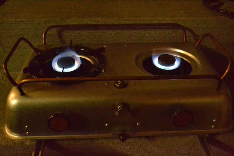

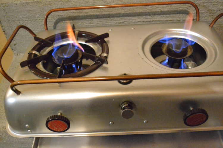

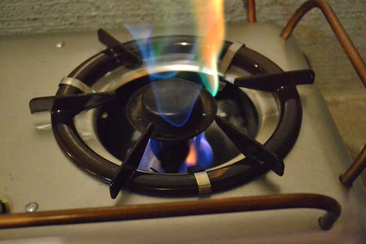

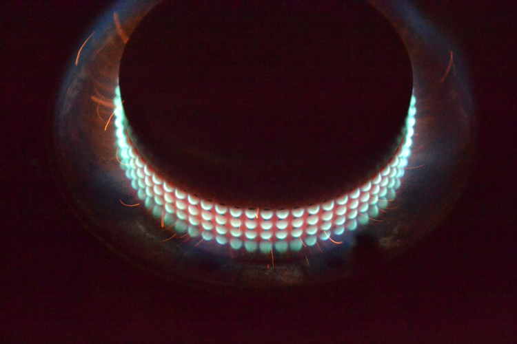

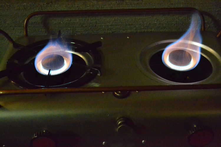

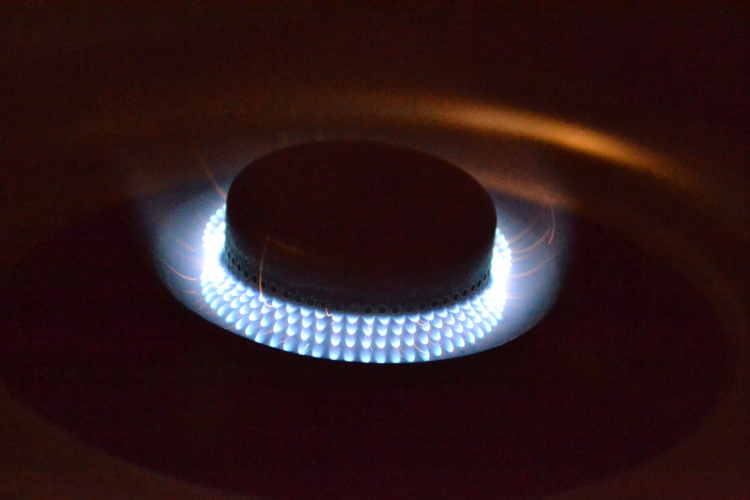

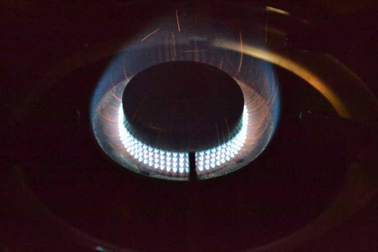

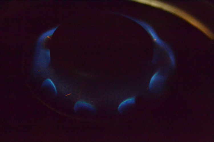

    And here are the flames...most on based on kerosene...

    Great job on that Homestrand :clap: . It appears to be in great shape and you were lucky to get the inner caps with the stove as all of mine only came with outers. Great flame shots too :) .

    What I have found is that these are very nice stoves. I can't believe how nice this one is and how really nice it operates. The flame control is excellent. The stove top is excellent. I did some boil tests on these burners and found them to match that of my 111Ts. Simmering is excellent. I should have gotten one a long time ago. I finally had to get the ball rolling and found this one.

    You are right about that statement. Gary and Doc turned me on to this model some time ago as I wanted a good kero double burner, but didn't want to spend the big money for a Optimus 22. The flame control is fantastic on the Svea 1915 burners and probably my favorite regulated burner of all I own. Have fun with it and don't forget how to convert them as I am sure it will not be your last .
