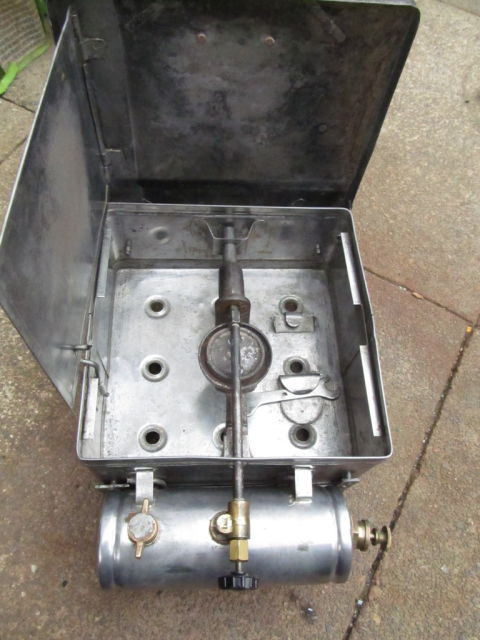

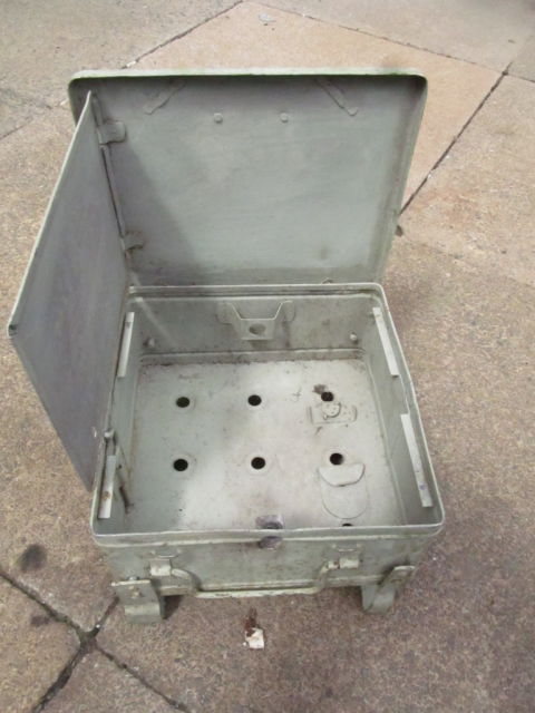

    Just a few before and after shots of this stove.
    Although this is dated 1942 on the badge, it bears a striking similarity to " The "Safety" Junior Portable ", by Turley & Williams, link below, Image 4 :
    https://classiccampstoves.com/threads/220

    Looks identical to the Turley. It also looks like half a Coleman suitcase.

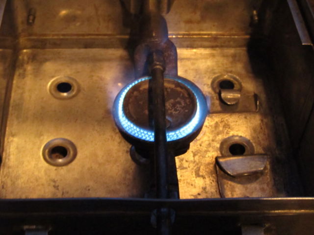

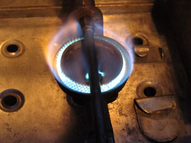

    I have just purchased a rather battered one of these, and have got it burning again. Unfortunately, it seems to underburn very easily/quickly. I am unsure why this happens, though I suspect that I am missing a heat-proof gasket under the burner.
    Would it be any trouble for you to break down your burner assembly, and take some close-up pictures? I would greatly appreciate any assistance you could offer as the under-burn thing is all that holds it back.

    That might help me as well. The only way the screws are coming out of mine will be with a drill and I don't want to drill too deep. That type of burner should only underburn if the fuel isn't vaporized in the generator properly.

    It underburns because there is fuel burning from beneath the burner grid. I reckon that I'm missing a heat-proof gasket that goes between the burner body, and the brace that it screws to. When they come apart, there is a pair of surfaces that do not seal together.
    I am aware of the usual causes of under-burn, but this is different. I just need to know if there's a heat-proof gasket between the two components, and what it looks like. I have plenty of flame otherwise.

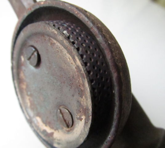

    The underburn is probably due to lack of a gasket. I was lucky enough to keep mine.
    The screws that held the burner plate were as rusty as hell, but I got the blowtorch on them and gently slackened them off whilst it was still hot, but not too much downward pressure, as it can knacker the flame ring.
    Kerophile
    Can you help with the lovely black stuff for the gaskets. It is roughly 2" x 1 3/4"ish, as I have got one similar to this.

    A few pictures of the burner, I dont think that the exhaust cement will last long term.

    You may be able to use something like this:
    Mr. Gasket Exhaust Gasket Material
    I've used it as a heat-proof gasket in between many items, including stoves. Good up to 2000F.
