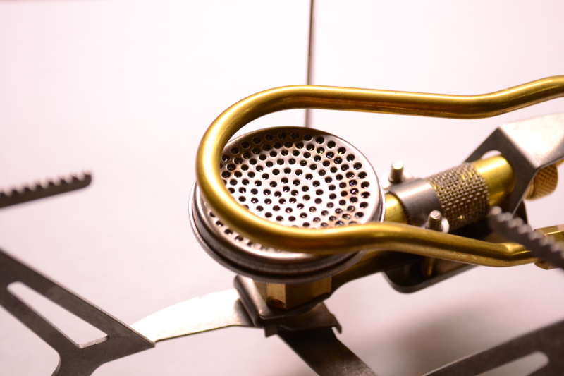

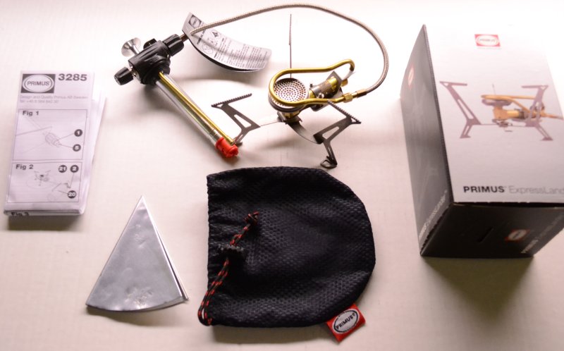

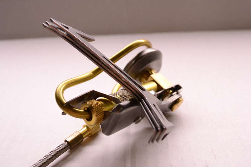

    The Primus ExpressLander VF is not much of a stove in size but in quality. It's been engineered for light weight backpacking. It's not a classic.
    It has the usual quality of which Primus has always delivered. It is definitely small. It would not be ideal for more than one person to cook for since weight instead of high output was the concern.
    Other than lacking high output, this stove is actually a muti-fuel stove. As a test, I ran Coleman fuel and then proceeded on to "the other white fuel", kerosene, which did a little better job. The numbers were a bit disappointing, but then, maybe the conditions were not ideal. I used a brass kettle, with starting water temperature of 43F for 1 liter. The ambient temperature was recorded at 18F at 4600F elevation. So these factors may have contributed to the stove's performance. I also did not use any type of windscreen, which would contribute to better performance. No wind was blowing.
    For Coleman Fuel, running the stove at maximum, I achieved an average score of 18 minutes to reach boil. I blame the jet size for the slow time. The unusual thing about this stoves is that it is quite small but has been designed to burn multiple fuels so the aperture of the jet has to be at some happy medium to allow both to burn. I believe any larger of a jet, wouldn't not allow some heavier liquids to burn. Kerosene did a little better at 12 minutes to boil with same conditions.
    The stove is capable of using white gas, unleaded gasoline, kerosene, and other equivalent fuels, so I'm guessing diesel would also be included on the list. With the jet size, I'm pretty sure that it won't be able to burn alcohol well. There are probably jet replacements but haven't seen them. The stove with the installed jet burns better on kerosene.
    I took a picture of the output rating and it talks about the stove as being able to put out about 8000BTUs whether or not it is gas or kerosene, but I believe that these claims must be somewhat exaggerated.

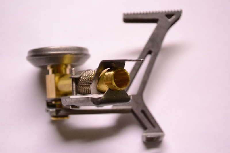

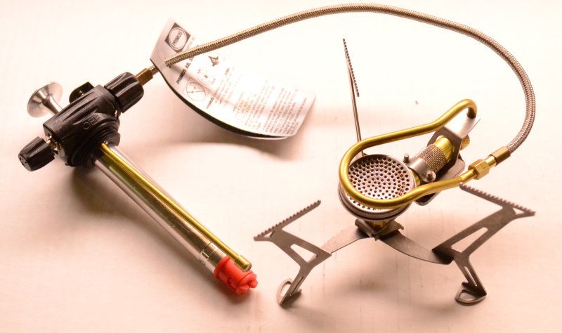

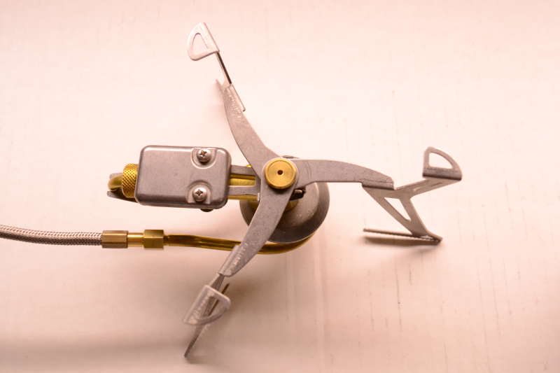

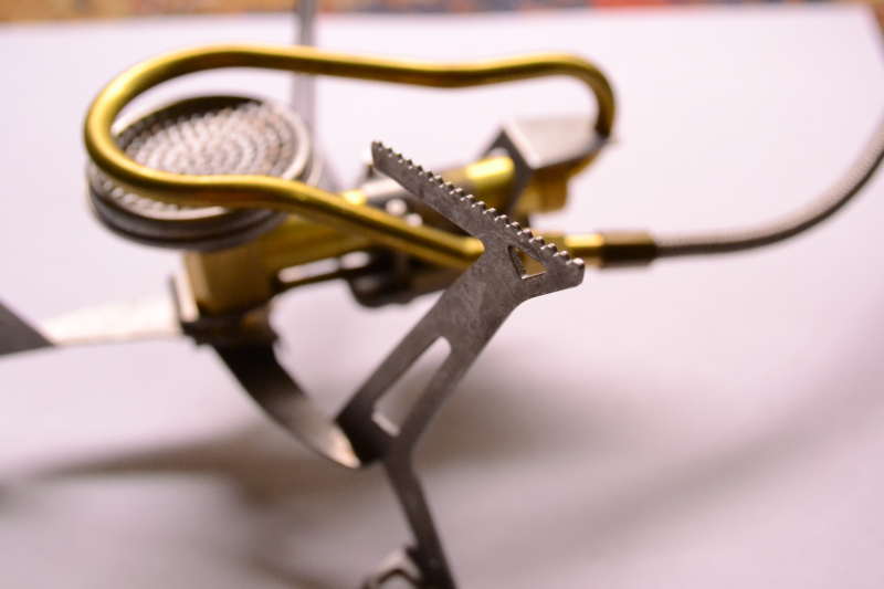

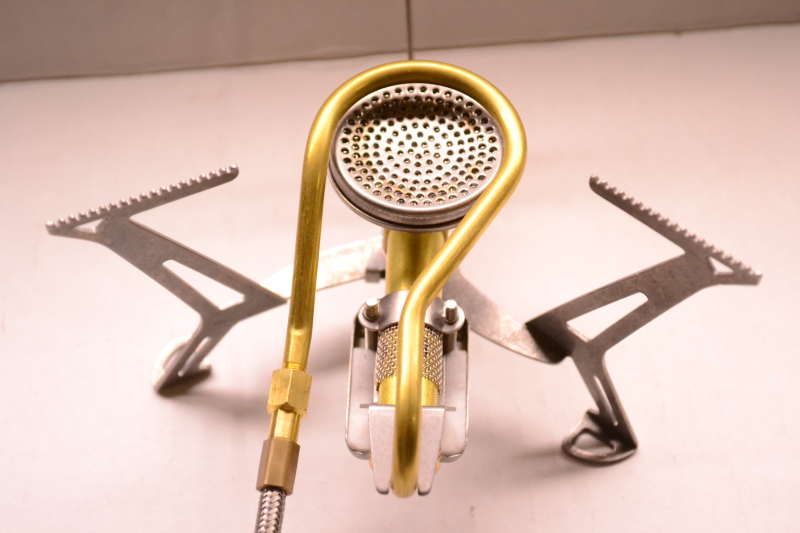

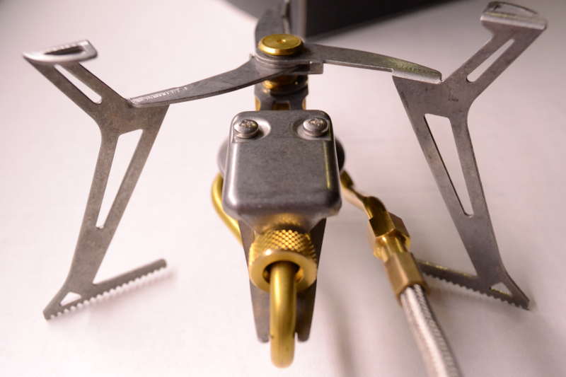

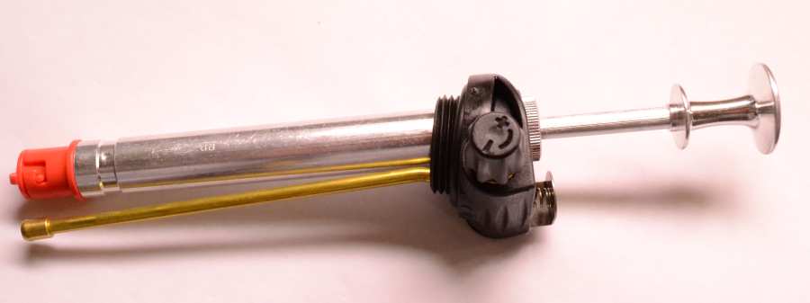

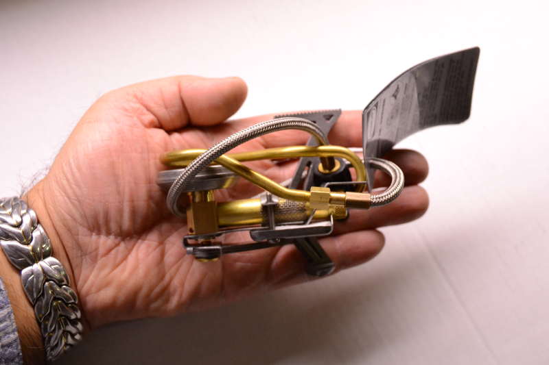

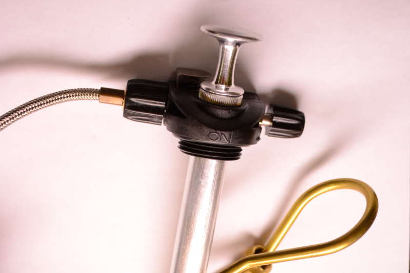

    Other than the above, let's get on with the photo sharing opportunity.
    1322889202-ExpressLanderVF_004.jpg 1322889210-ExpressLanderVF_005.jpg 1322889228-ExpressLanderVF_006.jpg 1322889239-ExpressLanderVF_007.jpg 1322889247-ExpressLanderVF_008.jpg 1322889262-ExpressLanderVF_009.jpg 1322889299-ExpressLanderVF_010.jpg 1322889319-ExpressLanderVF_012.jpg 1322889353-ExpressLanderVF_013.jpg 1322889382-ExpressLanderVF_014.jpg 1322889400-ExpressLanderVF_015.jpg 1322889410-ExpressLanderVF_016.jpg 1322889426-ExpressLanderVF_018.jpg 1322889465-ExpressLanderVF_019.jpg 1322889503-ExpressLanderVF_020.jpg 1322889519-ExpressLanderVF_021.jpg 1322889555-ExpressLanderVF_022.jpg 1322889610-ExpressLanderVF_024.jpg 1322889647-ExpressLanderVF_025.jpg
    Continued.

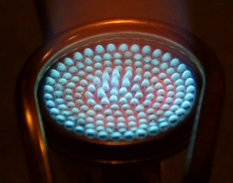

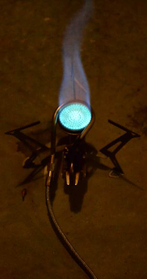

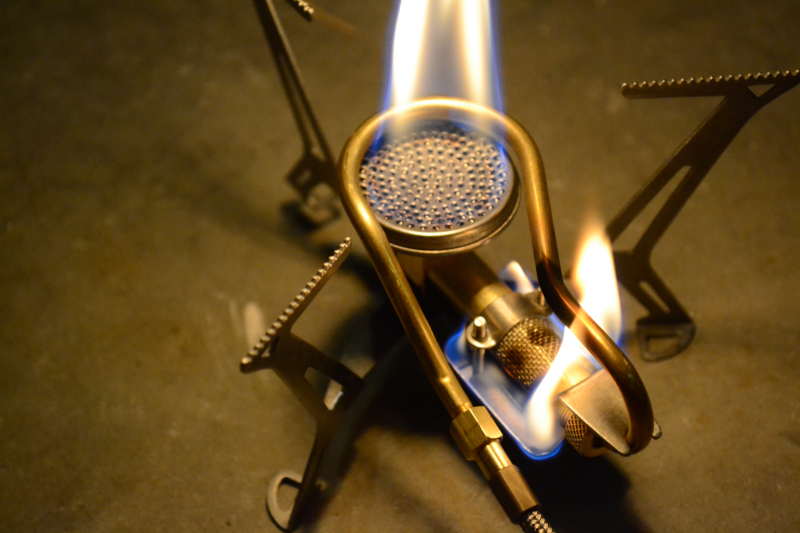

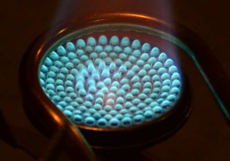

    Here's the ExpressLander fired up. One thing I didn't mention in the previous post was this stove has a difficult time simmering. The flame turns yellow with Kerosene at a very low setting. Otherwise, it provided some good heat for such a small contender.
    1322891030-ExpressLanderVF_026.jpg 1322891040-ExpressLanderVF_027.jpg 1322891045-ExpressLanderVF_028.jpg 1322891059-ExpressLanderVF_031.jpg |imgRemoved|'thumb' 1322891072-ExpressLanderVF_045.jpg 1322891358-ExpressLanderVF_034.jpg

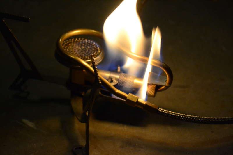

    Hey Sam, quick question, how close it the priming pan to the connector as it looks to me like the hose is too close that on a windy situation it would lick the braided line and degrade the rubber hose underneath. What is your take on that? I have not really read reviews on this particular stove so do give your opinion.

    Is it just a racket or a actual necessity to use only a Primus fuel bottle? I don't like that idea if it means the Primus fuel bottles are more expensive. If you had other fuel bottles you naturally would like to carry on using them.

    The distance between priming pan and fuel line is quite adequate. Picture angles don't show this. It's about an inch and a half away, so plenty of room.
    I used an MSR 20oz fuel bottle. I tried an 11oz fuel bottle could not attach the pump because the diameter of the bottle was too small. The pump's threads are designed at an angle to aim the fuel tube pickup to the side wall of the fuel bottle. I have a few large diameter fuel bottles from Brunton that are too large and would not be able to pick up fuel once the level became too low, so about the only size that can be used where the fuel pickup tube makes contact with the sides of the fuel bottle is the 20oz size. I did not try a Primus fuel bottle since this stove did not come with one.

    That was 18 minutes on CF. The 12 minute mark was met by kerosene.
    Both burn times were not ideal conditions. I didn't use a windscreen and it was 18F ambient temperature, which is quite cold. Not only that but the kettle was one that I had kept outside with the water in it! The water had not frozen so I took a quick measurement and found it at 43F. Cold, but not too cold.
    I really believe that the CF output is due to the jet size of the stove. There wasn't another larger jet so to be universal on fuel the 28 jet is provided. Kerosene works best.
    I think I would rather carry my Svea 123 than this stove. It's just not powerful enough for my needs and wants.

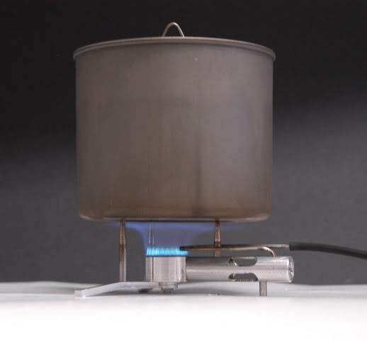

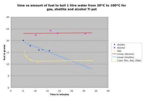

    To me fast boil times are a waste of fuel, and I am wondering if the Primus ExpressLander has been tuned to do the most efficient boil times.
    My testing with using a standard 150 mm (6") pot has shown that if you boil 1 liter water faster than 12 minutes it is a waste of fuel, below is a graph of time vs fuel usage for a Trangia 27-1, a MSR Whisperlite and MSR Pocket Rocket.
    Note that on the graph at around 12 minutes to boil one liter, the PR hits optimum speed vs fuel usage, the PR also does not loose efficiency with very slow boil times, also note the Trangia at its fastest takes around 12 minutes to boil one liter and does not loose efficiency when the simmer ring is used to slow the boil times down.
    The same with the Whisperlite, it gained efficiency as the boil times increased and after 12 minutes there where very little gain in efficiency.
    For interest this is a low profile stove I designed and built in 2007.

    Those are interesting numbers. I'll have to remember to not be in a hurry to boil up something. I suppose with windscreen and less than maximum output combination, one could get a little better boil time and not waste fuel. Interesting for those that go on a little longer trip and can't be carrying too much fuel.
    edit: by the way, your stove looks really cool and quite similar to the ExressLander. Did you sell you idea to MSR?

    Hi Sam,
    These test where done without a windscreen but in a windless environment, but I am not sure with no wind a windscreen makes much difference if any at all, Some time ago I did Some windscreen tests measuring the temperature of the gasses rising up the side of a pot with and without a windscreen and if anything in some cases a windscreen could help drag heat away from a pot when the water is at lower temperatures.
    As for me selling my ideas to any stove manufactures, in my dreams, besides designing, making and publishing on BPL the low profile stove concept sometime before Primus released theirs, I also modified a JetBoil to add a pre-heat tube long before JetBoil brought out the Helios. When the JetBoil Sol Ti comes out in Australia I have plans to make some mods to it.
    But to me it all just fun.

    I tend not to use wind shields, but some stoves really need them. The best example I can think of is the MSR dragonfly, It has a large distance between the burner and the pot. It benefits greatly from wind / breeze protection.
