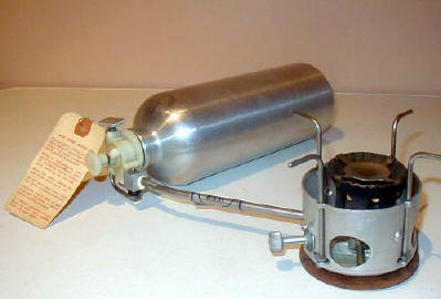

    I'm no expert on these but I've had a few. Beware of the label often attached to the pump that has Model No:9 written on it. They carried on using these labels on the MF (later GK) after the No:9 was finished. The No:9 finished sometime around 1975. I think your stove will be an early "G"
    The No:9 can be distinguised by the wavy, scalloped edge around the burner bell. It also had a hard fibre base.
    This is a picture of the one I had but it is not too clear. Note the early pump with square control knob. From memory I think this was 1972 or 74.
    This is a MF from 1976 predessor to the GK. This came with a "No:9" pump label.

    I had a trawl through my photo archives & found some more pics of the No:9 which show the scalloped burner bell & pump in better detail.

    I've done some more reading. Yes, different models but only the GK had the loop-over fuel line. The model name XGK did not come out until some time after 1981. I have some more detail below which may help with the chronology.
    In one publication, Off Belay - Stoves for Mountaineering from 1975, I have found reference to the No:9 being 'improved' with a fine needle control valve. In the Backpackers Equipment Buyers Guide from 1978 it lists the No:9A (the A maybe denoting the 'improved' version) along with the MF (multi-fuel). These are the only 2 MSR stoves listed in this extensive guide. It also contradicts my belief that the MF superceded the white gas only No:9. Looks like it was made for a few more years. The MF has the loop-over fuel line.
    By 1981 in MSR's own brochure the only 2 stoves listed are the G & GK. From the fuels they burn & the design ,I think it's safe to say the G was the replacement for the No:9 as it burnt white gas only &, like the 9 did not have the loop-over fuel line while the GK was the replacement for the MF.
