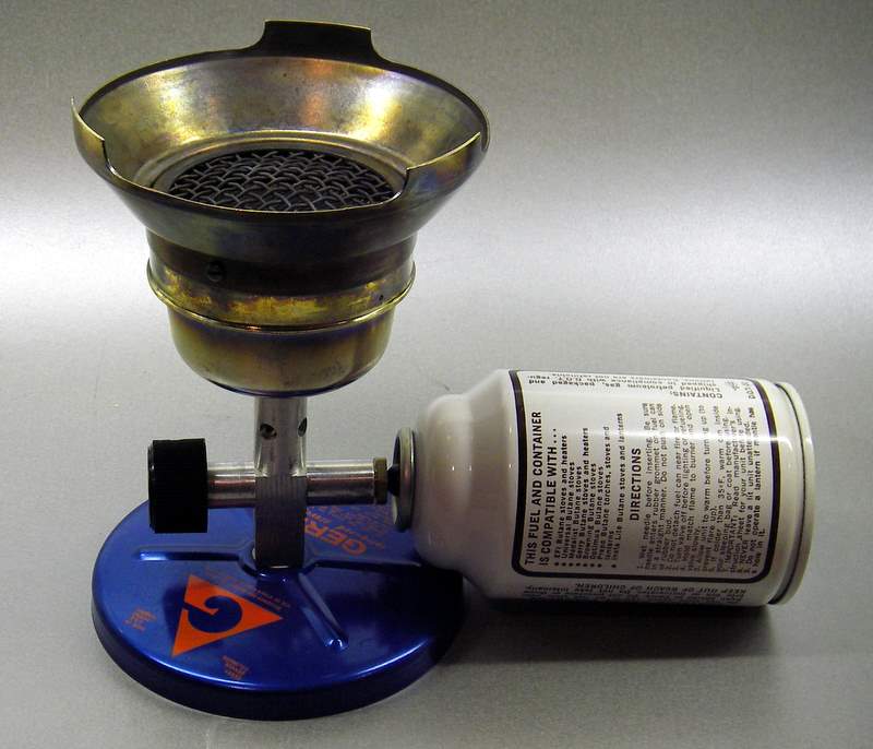

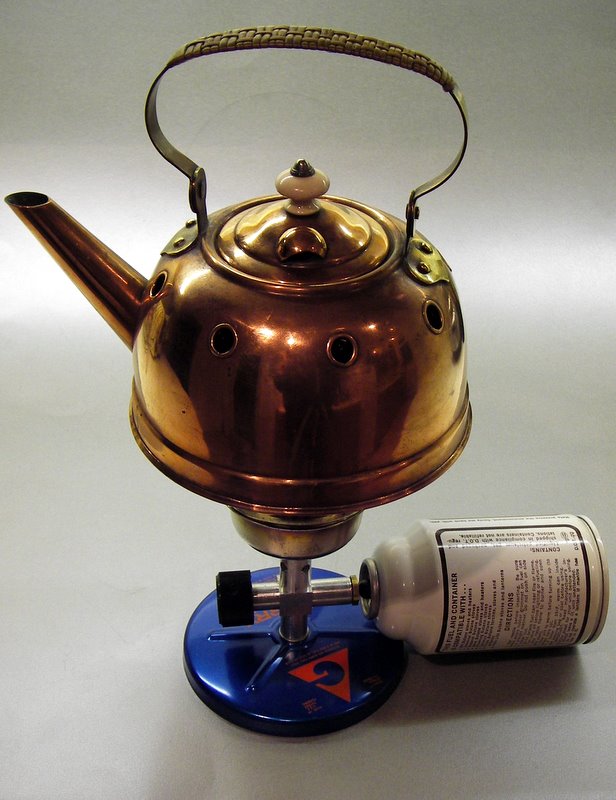

    Shipped from the States, not mint but complete, boxed and with the instructions, a Gerry infra-red stove with accessory arm to tilt it for use as a heater

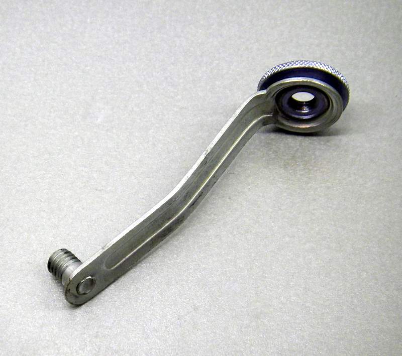

    The accessory arm ...
    ... tilts the burner head to turn the stove into a heater

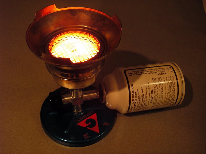

    I got marginally more output with an original wick-fed butane cartridge that gets liquefied gas to the burner. I've found with a Hank Roberts stove taking that cartridge that it offers more power than even an inverted remote cartridge on a flexi hose does.

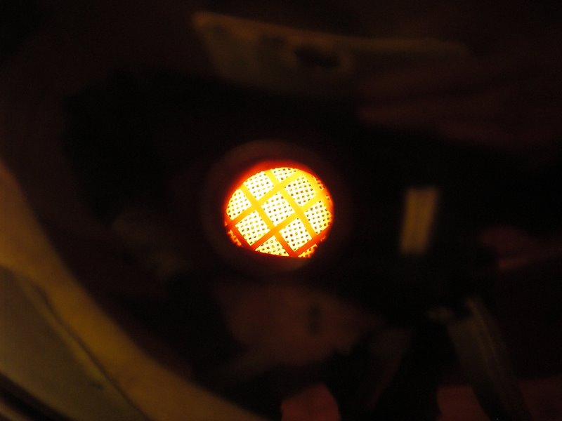

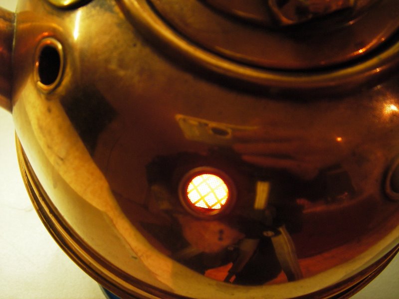

    However it takes ages for that mass of metal in the burner head to heat up and until then the stove is tricky to get going without flaring, requiring constant adjustment of the control knob. Once heated up it provides a reliable and steady output
    Ten minutes to boil water and not a lively rolling boil at that

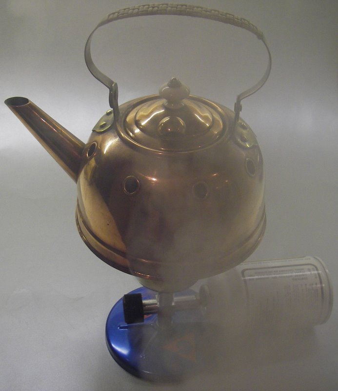

    I knew I could get more out of it, having adapted a Hank Roberts clone to put out more power
    Turbo-powered Hank Roberts clone
    Borrowing the burner control valve, and bored out riser tube and jet, sure enough the potential of the Gerry stove was unleashed. Three minutes to boil water this time ...
