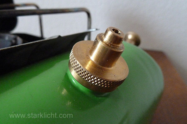

    Here my new greeny Optimus Hiker +.
    1334855645-P1150849_k.jpg 1334855672-P1150857_k.jpg 1334855686-P1150853_k.jpg 1334855759-P1150844_k.jpg 1334855776-P1150845_k.jpg

    It appears that you have a pump type cap normally found on a smaller backpacking stove on the fuel tank. It will accept a mini or midi pump for improved performance. This cap is redundant in this case but would serve well on an Opti 8r or Svea 123.

    I may be wrong, but is this not an SRV you're seeing there Harold?

    I am quite certain this is an SRV, designed to open at a certain pressure (when things get to hot).

    The pump on this stove is the normal one.
    There is certainly no need for a mini/midi pump.

    Note however that Optimus had gone to a more standard hex rather than the pentagon hole for the cap SRV.
