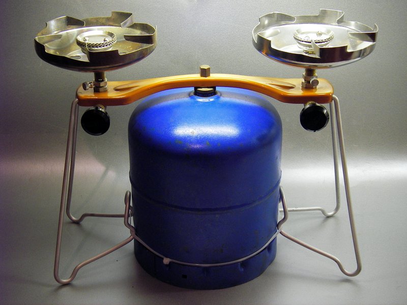

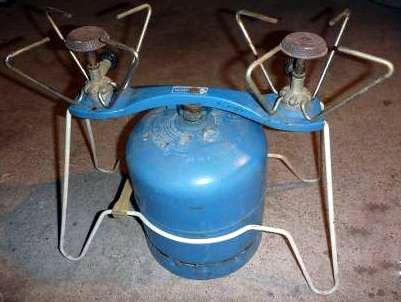

    I was surprised to find this dual-burner Meva stove on sale in the UK, since I'd to locate the single burner example I have in its country of origin
    Those aluminium rod pot rest supports are an optional extra but not really necessary for anything but the heaviest pots

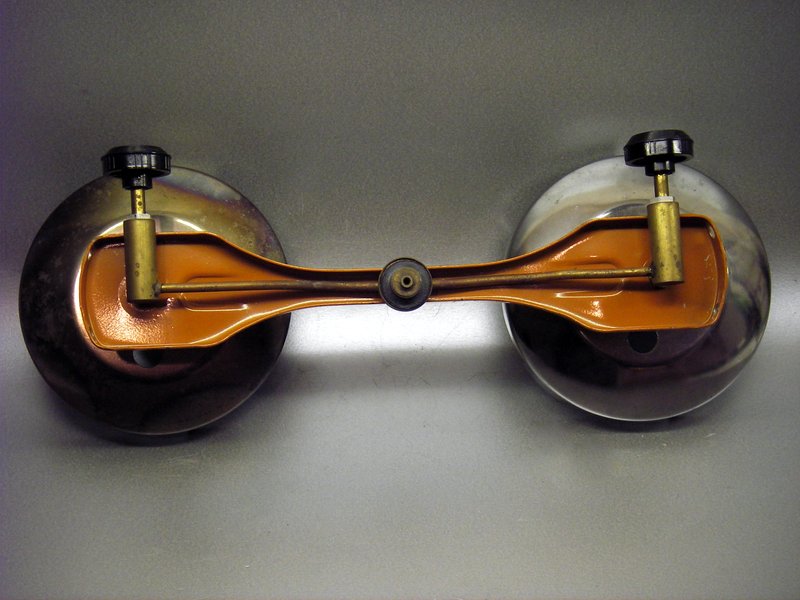

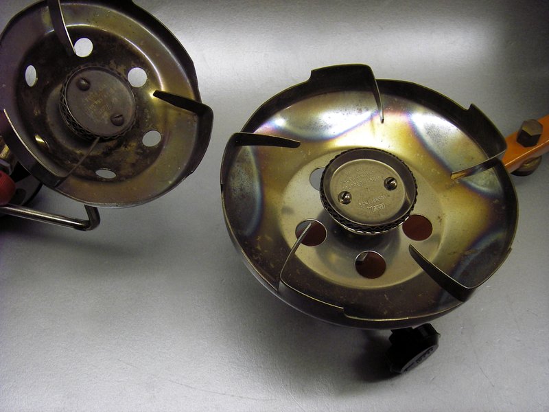

    Though burners and windshield/pot rests resemble those on the single burner Meva those on the dual-burner stove are bigger ...
    ... and those are the only components anything like the same

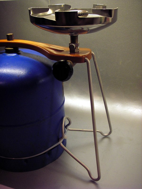

    It's a well-made device and that Campingaz 907 cylinder could keep it running for days at base camp
    Like the single-burner Meva, there's an air inlet control on the burner risers, Bunsen burner style. The mixture control ensures maximum output and allows a propane or butane source to be used with appropriate adjustment

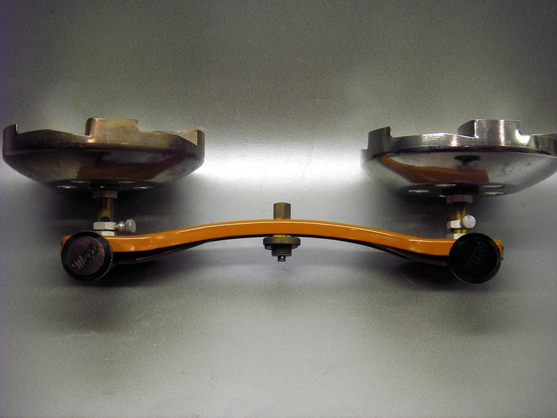

    Pipework and gas cylinder connector

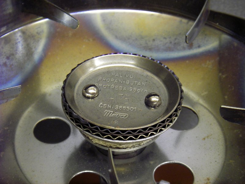

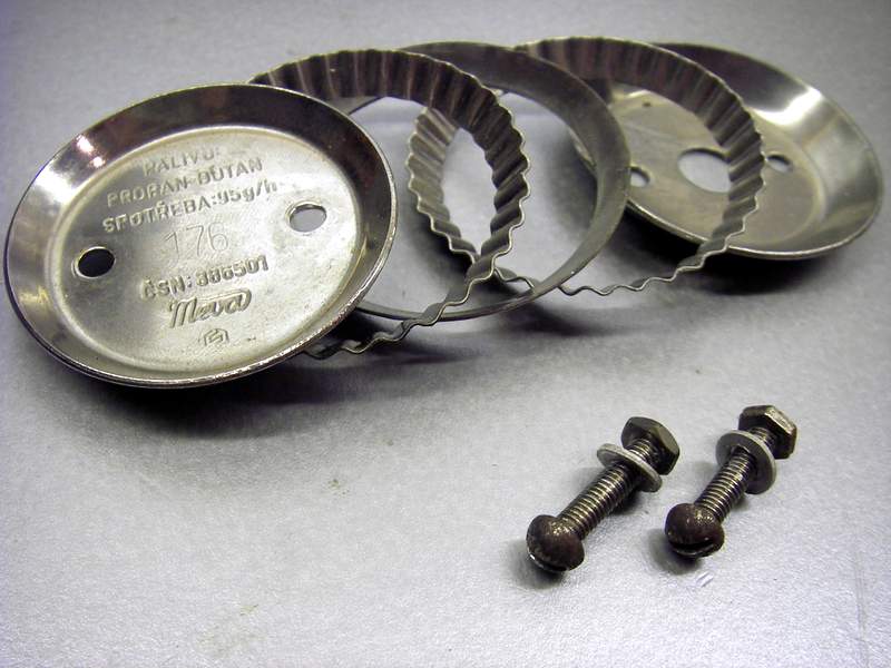

    The burner head is a clever design
    There's an asbestos insulating disc under the burner head to prevent heat conduction to the frame and control spindle

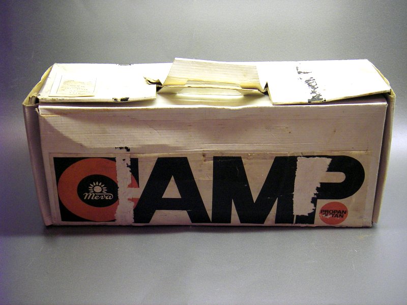

    Box

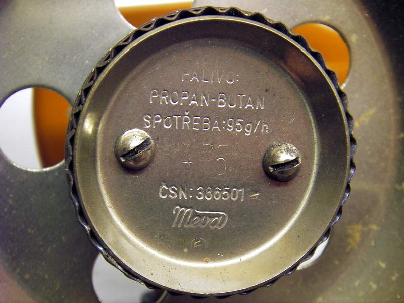

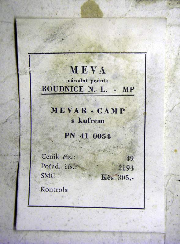

    What I'm guessing is a quality control label, but I've yet to get around to Google-translating the Czech inscription

    Nice kit but not the sort of thing we would ever see on this side of the pond. I see you have a rubber band around the legs. I bet they are made for the underside of the tank to snap into...

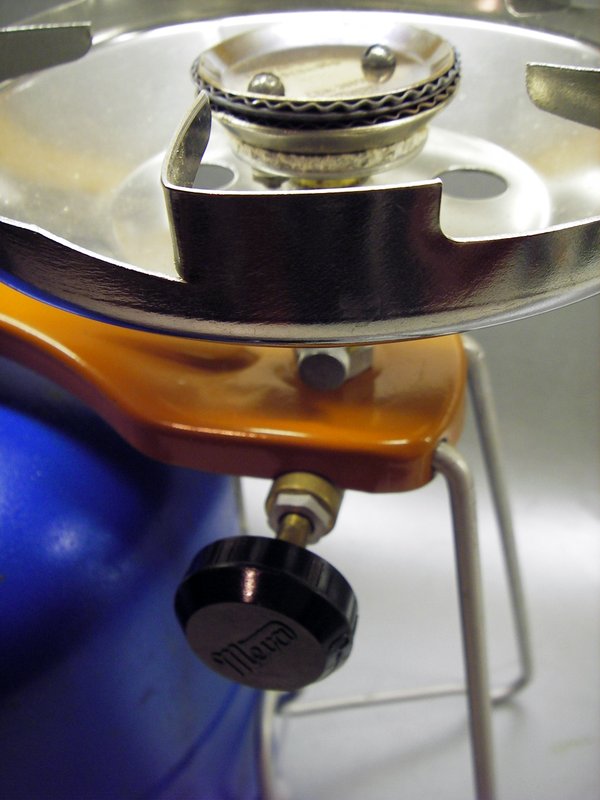

    I know you're right Dave, but I couldn't bring myself to lever the things into position. They protested too much!
    I'll have another go ...
  6. presscall
    13,783
    Nope. Those stabilising legs won't clip under the 907 gas cylinder.
    I see now the stove was intended for the 904 cylinder, same diameter (I recall) but stubbier. Legs would clip under that I expect.

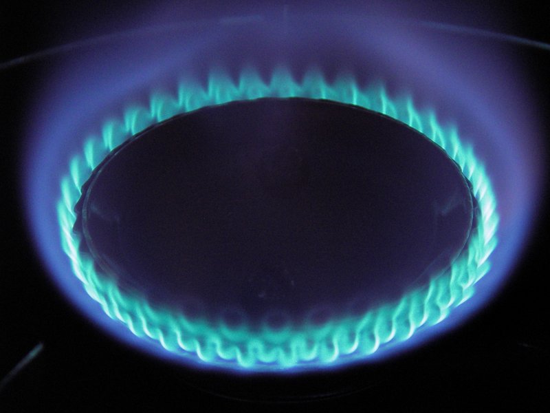

    I've been using the stove today outdoors and in mildly breezy conditions. Those pot rests provide efficient windshielding, though supplementary windshielding is (as ever) essential to prevent cooling of the pot to speed things up.
    I changed the jets too. The two spares and the ones installed on the stove had jet orifices that were far too small - probably ok for a propane source without a regulator as with Primus propane gassies - but way too mean with the fuel for butane.
    I popped in a couple of Primus 0.32mm jets and the burners now put out much more heat on maximum. The air adjustment sleeves were a handy feature to enable this sort of tuning. Backed off to allow more air into the fuel/air mixing riser tube, I've now got a far more powerful flame at each burner that are still controllable down to a simmering level.

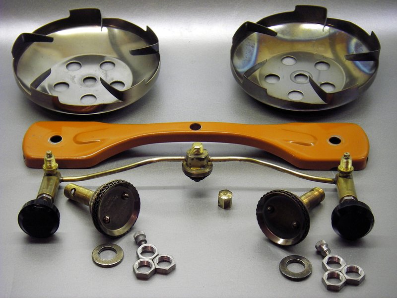

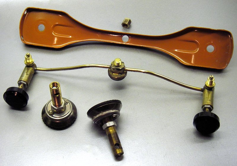

    Stove stripped down to component parts - burners previously disassembled and cleaned
    The fuel pipe connections are soldered up and not brazed, another good reason for having the asbestos insulating washer in each of the burner heads to keep conducted heat away from the pipe and the control valves
    Burner, lock-washers and air control sleeve nut and screw
    Reassembly

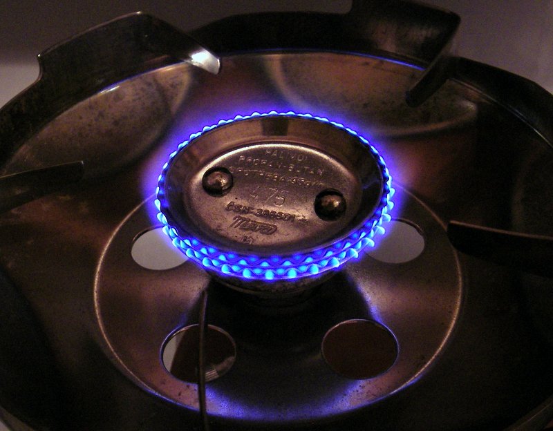

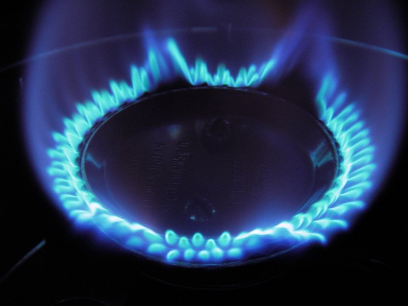

    Even with the larger jets it's still possible to dial in too much air, from this effective maximum ...
    ... to the point where the flames lift off the burner outlets
    Good simmer
    Useful maximum output
    ... and the opportunity to dial in a lively flame pattern at will - just for fun
