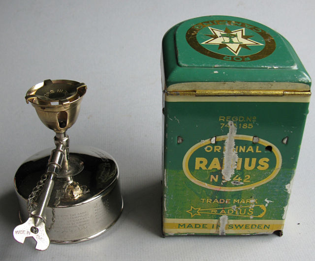

    A nickel-plated Radius No. 42 stove. Unsure of her date of manufacture. She has the Radius shooting star logo and no 'Ltd' anywhere so that would put per pre-1938. The winged fuel cap on the underside of her tank is also indicative of an early model 42.
    She came with 1 Radius-labelled pricker, the green-painted colorful tin case but no instructions or any of the burner accessory (lamp/torch).
    MADE IN SWEDEN embossed on her burner plate.

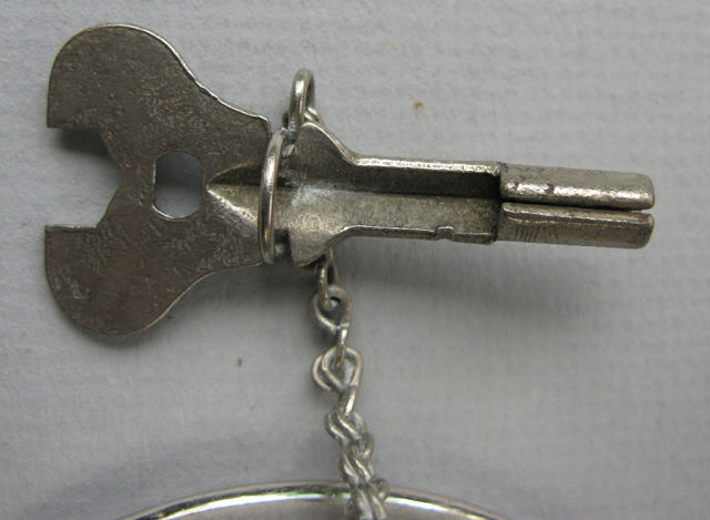

    Standard all-metal fuel control key/multitool. MADE IN SWEDEN stamped into her handle, hole for jet removal/replacement and the spanner/wrench to tighten the fuel control nut.
    Unmarked otherside

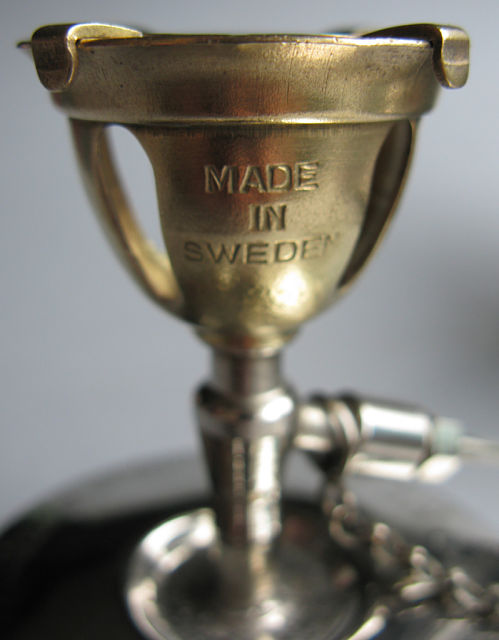

    MADE IN SWEDEN stamped burner bell.

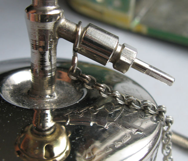

    An interesting, nice cosmetic touch on these stoves (versus equivalent Primus/Optimus/Svea/etc) is that everything is nickel plated, including the fuel control valve stem and chain. The only non-nickeled parts visible are the bell, jet and plate.

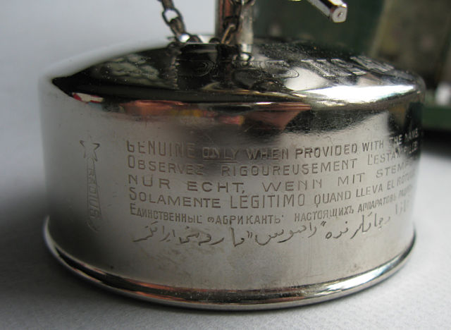

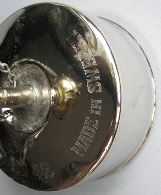

    MADE IN SWEDEN and RADIUS No. 42 stamping on top of tank.
    RADIUS Shooting star logo and the trademark GENUINE ONLY WHEN PROVIDED WITH THE NAME "RADIUS" in 6 languages down the side of her tank.
    RADIUS-labelled pricker

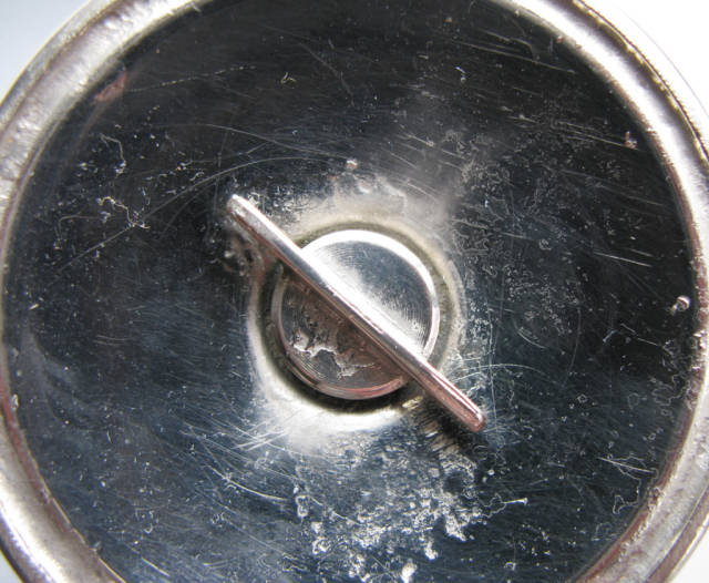

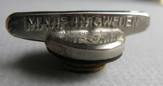

    Winged fuel-cap on the bottom of her fuel tank.
    In my opinion this is a drawback: it increases the chance of dirt getting into the fuel tank during filling; you cannot verify the fuel level due to the proximity of the wick to the opening blocking the view; two handed refuelling - you have to hold the stove upside during filling (too tippy if resting on burner head); some spilled fuel can remain in grooves on bottom of stove if overfilled or using no funnel; difficult to empty stove fully for storage; etc.

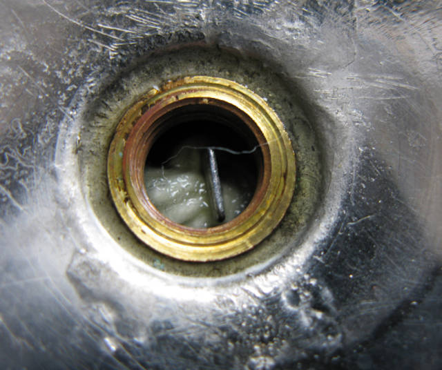

    The wicks are held in place by a metal stem just below (or above, depending on your perspective) the fuel cap.

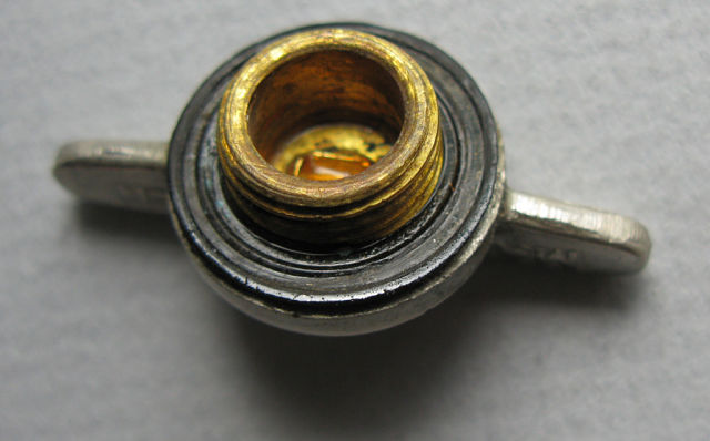

    Winged fuel cap with rubber gasket

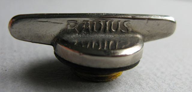

    MADE IN SWEDEN on one wing of the fuel cap.
    RADIUS on the other

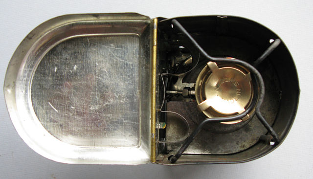

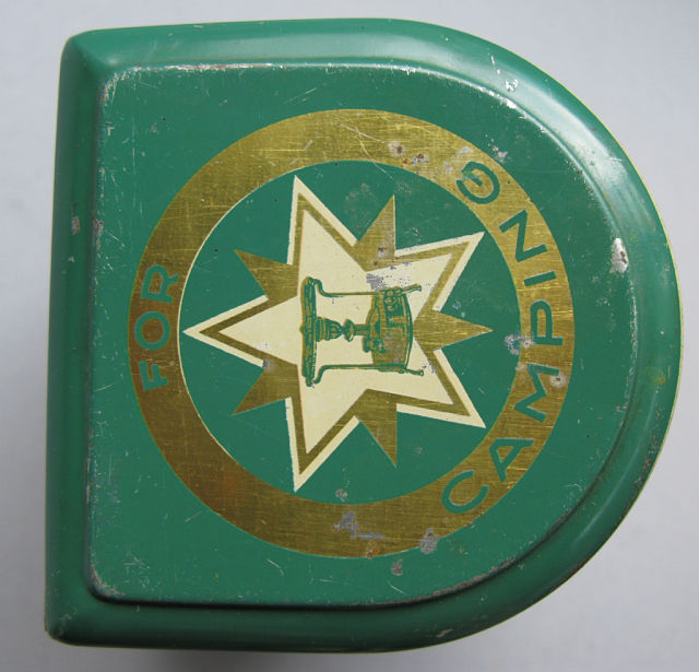

    The tin, like the stove, was in used condition but no dings, just some paint loss, scrapes and discoloration. These tins were very flimsy and under-strength, and the paint used very sensitive to any heat, as so many have shown.
    Top with FOR CAMPING and the star/stove logo.

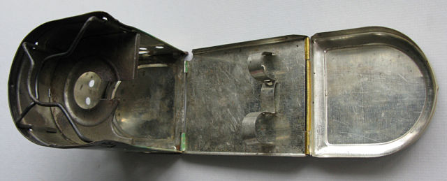

    Opening the case displays the two attachment holder affixed inside front but no writing (instructions) commonly found in other 42 tins.
    Stove neatly nests inside the case, the pricker is held in place between side of case and heat shield.

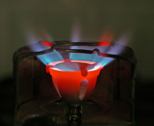

    Stove ran wonderfully loud and powerful, they are very quick to light and burn very hot.
    I don't think she had been used much, no yellow at all in her flame and she's in great condition. The two thin-wire pot support appear to be mis-aligned, judging by the little riser in the lower set - will reseat accordingly.

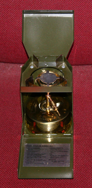

    Coupling a Radius 42 (winged fuel cap, no SRV) with the Army No. 7 case (new - many thanks Dave!).
    Great fit for all 3 model 42s tested:
    1) winged fuel cap under fount, no SRV (model with widest size fuel tank)
    2) winged fuel cap under fount, with SRV on top of fount
    3) standard knobby top-hat SRV'ed fuel cap.
    Army No. 7's case (right) much heavier and solid versus the flimsy tin of the 42's original case (shown on the left). Strong steel construction, vented on the backside with 3 slits, otherwise sides are seamless solid plates providing rigidity and durability. Case painted and has hinged top and front side plate.
    Perfect size for the 42 as noted in previous posts. 4 heavy duty solid steel riveted pot supports.
    Sufficient diameter of center hole in pot rest plate not to impede/deflect the flame downward onto fuel tank (for a non SRV'ed stove running on Coleman Fuel this is a key consideration/concern).
    Stove's bell a shade below top rim.
    The case will also fit the Primus 70 and older model (1930's) Optimus 80. Not 71's, Svea 123, which are either too tall and/or high-volume fuel tank won't sit flat or even fit inside the case. I wouldn't recommend using them with the 70. Due to the fixed riser plate at base of the case, to remove (or fit) any stove it has to be tipped at 45 degrees then dropped back down (bell goes up through the plate hole before slipping back). If one can't blow out the 70 (no regulator) removing it will be tricky and dangerous. Better off throwing the entire setup in the lake/river/swamp/fluffy snow pile as an instant-off (and bonus case cleaning) maneuver.
    These cases commonly show up on ebay UK and at the time of this writing average 10 GBP new. They are designed to support the British Army No. 7 stove (cross between a Svea 123 and a Radius 42).
