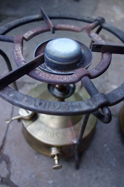

    The 1947 'AL' has been given a Liberty No.2 size silent burner which looks pretty close to original (from a distance):

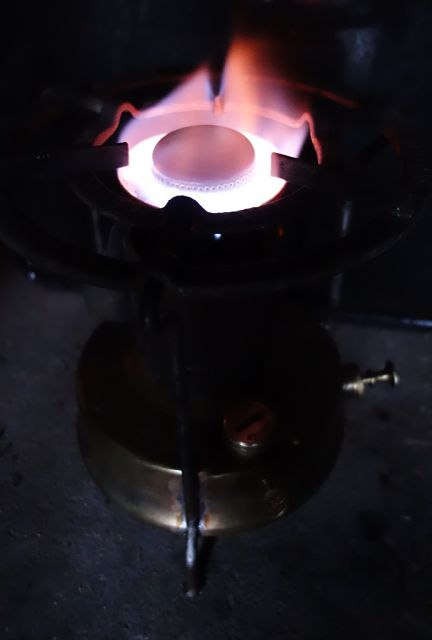

    Here is the No.10 with the Liberty No.2 roarer burner hard at work heating one of my wife's fleece cleaning and dying vats:
