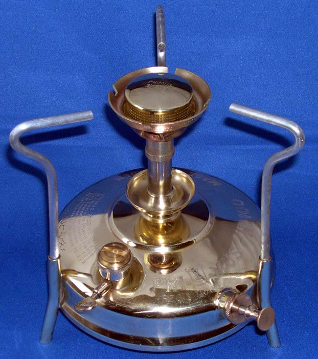

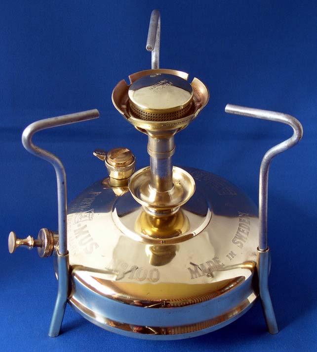

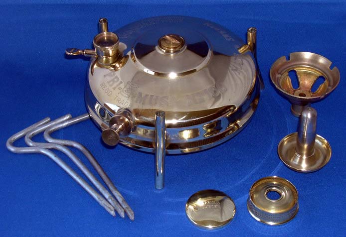

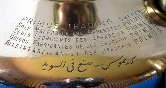

    Hi here are some images of a Primus No. 100 from 1911.
    https://classiccampstoves.com/threads/9286
    More than fifty years on, in the early 1960s, it is the era of the Primus Trading Company, and they are still manufacturing and selling the Primus No. 100:
    1223360443-DSCN0007_edited-1.jpg 1223360449-DSCN0008_edited-1.jpg 1223360457-DSCN0016_edited.jpg
    The stoves look the same, do the same job well, and the parts are inter-changeable!
    Are Paraffin Pressure stoves one of those rare items where the designers got it right very early on?
