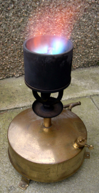

    Hi, about a couple of weeks ago Trevor teased us with some images of a Virgin Monitor stove.
    She was lovely and totally un-touched by the hand of man.
    Last weekend I was given a wonderful early Birthday present by a good friend and fellow CCS member from England.
    This is a large Monitor stove, a sister to Trevor's Monitor.... But my one has an over-size burner, some experience, and is no Virgin!
    I thought I would share some images with you:
    This is a gallon capacity, paraffin-fuelled stove fitted with a roarer burner. Here she is operating this afternoon:
    This is a seriously big stove but it is difficult to get an idea of scale, so I have included a Primus No 3 ( 7-pint capacity stove) in this shot, for comparison
    Here is the Monitor alongside a Primus No 1 ( 2-pint capacity) stove.
    The stove is currently fitted with an over-size roarer burner but I also have the standard Monitor burner for this model of stove.
    This burner has a rated fuel consumption of 3 litres per hour and I estimate peak heat output at 30kW. She roars like a low-flying Military Jet when operating
    A really powerful stove, yet surprisingly controllable for such a big Girl!

    What a belter George !
    . . . .. the question is of course, . . . how well does she simmer . ;)

    Hi Keith. The working pressure range of this particular burner is 20 - 50 psi.
    By adjusting the tank pressure using the pump and air-release knob I have found it possible to get a fairly wide range of power settings.
    I believe it produces over 30kW on full power and probably about 7-8kW on "Low" power.
    Next time I am making a big batch of porridge I will see if the 7kW setting gives a nice simmer!

    Hi Trevor, The "Proper" burner for this Monitor stove is the one you posted pictures of. I think it is the same size burner as that used on a Primus 85 and is rated at about 14.5 kW.
    I have such a Monitor burner in virginal state but I need a nipple ( or at least a knowledge of the aperture size so that I can make one).
    I am currently running the Monitor stove on a modern Indian burner ( the giant in the photos). I believe this burner is rated at over 20kW and gets through 3 litres of paraffin an hour, compared to 2 litres per hour for the Primus 85 burner.
    I would be really grateful if you could tell me the jet aperture size in your big Monitor burner.
    My stove is MoD circa 1975 and marked up as "Paraffin Only"
    George.
