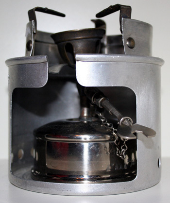

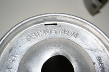

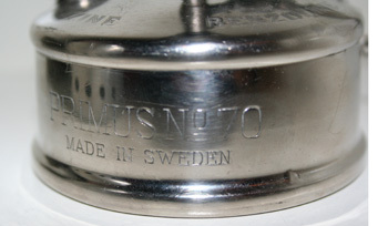

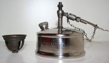

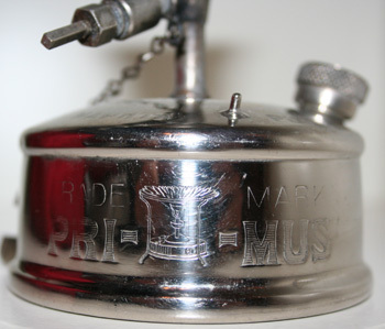

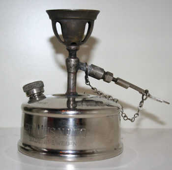

    Good evening!
    Below are some pictures from my new Primus No 70 stove that I bought for about 1 month ago.
    1355225136-IMG_0003-3.jpg 1355225143-IMG_0004-2.jpg 1355225155-IMG_0009-3.jpg
    I haven't tried it yet, but as soon I've some time over - I'll give it a try!

    Curious that the stove is a 70 but the windshield is marked 71

    Very cute nickled No.70! However, the support shows the (expected) 71 number, but it is a very nice combination!
    I bet you had to apply some "elbow grease" to bring it up to this condition; well done!
    I did think that the 71 was the 70 with a control valve.
    Of course you can screw the burner-cum-valve into a 70 tank, so no real clues there.
    Unless the only feature that sets the 71 apart from the 70 is just that safety "spike", but your pictures show that spike clearly.
    Now I really wonder what made Primus to introduce the 71 as a new model number as the 70 ended up with the same features.
    The only 70 I have is brass, with seperate meth's dish, screwcap on chain to replace the burner, no control valve nor pressure relief.

    This is the last variant of the 70 c1931. Primus sold the older non-control cock version concurrently for a short period. The outfit with just the 2 part windshield & no pans was the 70D - this was introduced the at the same time the 'safety pin' came out.
    The first version of the 71 was the same as this 70 - it was basically just a renumbering exercise.
