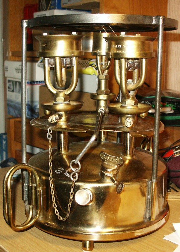

    2 large burners and one small.
    Anyone seen this one in a catalogue?

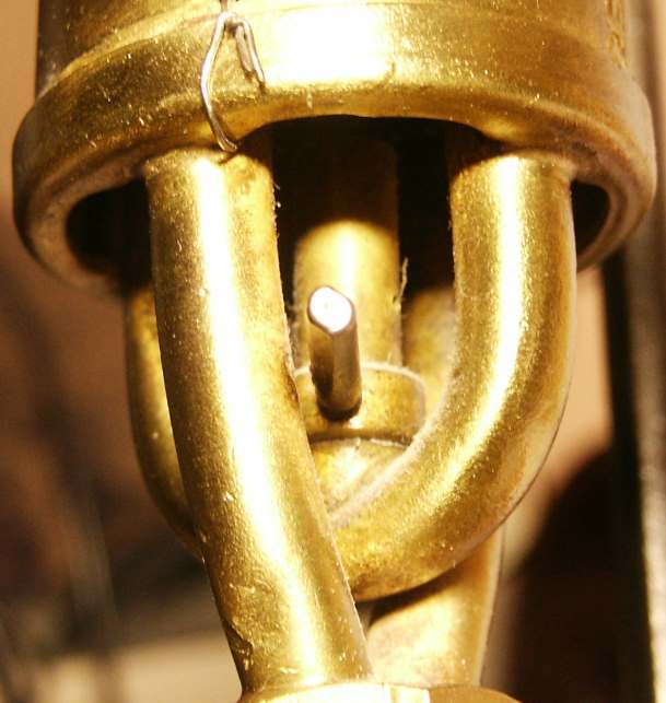

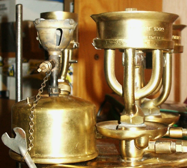

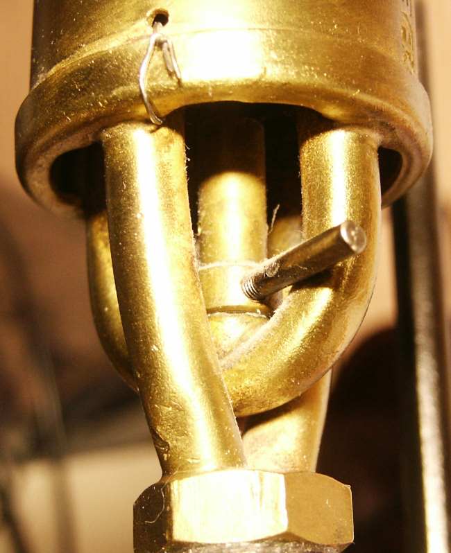

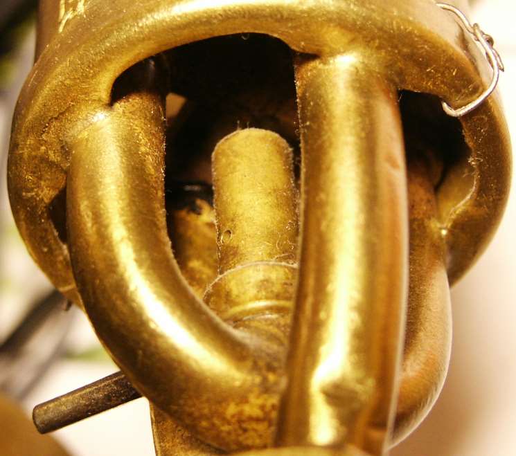

    Finally at least found a reference to the larger burners on this stove. It's single mounted on the Svea 3 pictured in the 1960 Svea catalogue:
    https://classiccampstoves.com/threads/214
    Part no: 1083 - boils 10 l in 7.5 min
    Fuel consumption 0.73 l/h at normal burn.
    The smaller burner puzzles me. There's a lever that can be turned between the 2 burner tubes.
    When turned it feels like the jet thread is loosened. You cant turn it more than maybe 30°.
    There's also a tube on top of the jet which has 2 1.5 mm holes at the base.
    Anyone seen this arrangement, or can figure the function out?
    What's an estimate of power, all burners burning?
    15 kW?
    /Hans
  3. kerophile
    14,341
    Hi Hans, From your data:
    A single 1083 burner using kerosene at 0.73l/h has a theoretical heat output of 7.3kW, according to my calculations.
    Your stove/burner has a very high output potential.
    Hope this helps.
