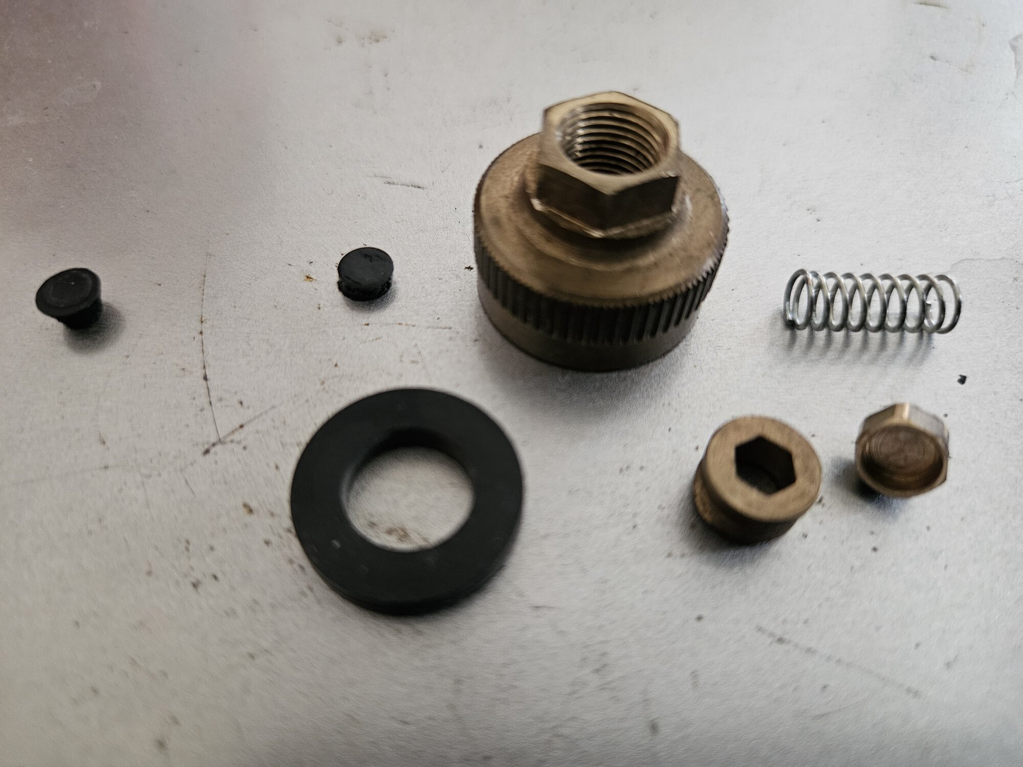

    The tank cap has a SRV pip in it... interesting!
    I was also surprised it came apart really easy!
    The pip on the left was what was in it... Lol...I punched a 5 out and put it back together.

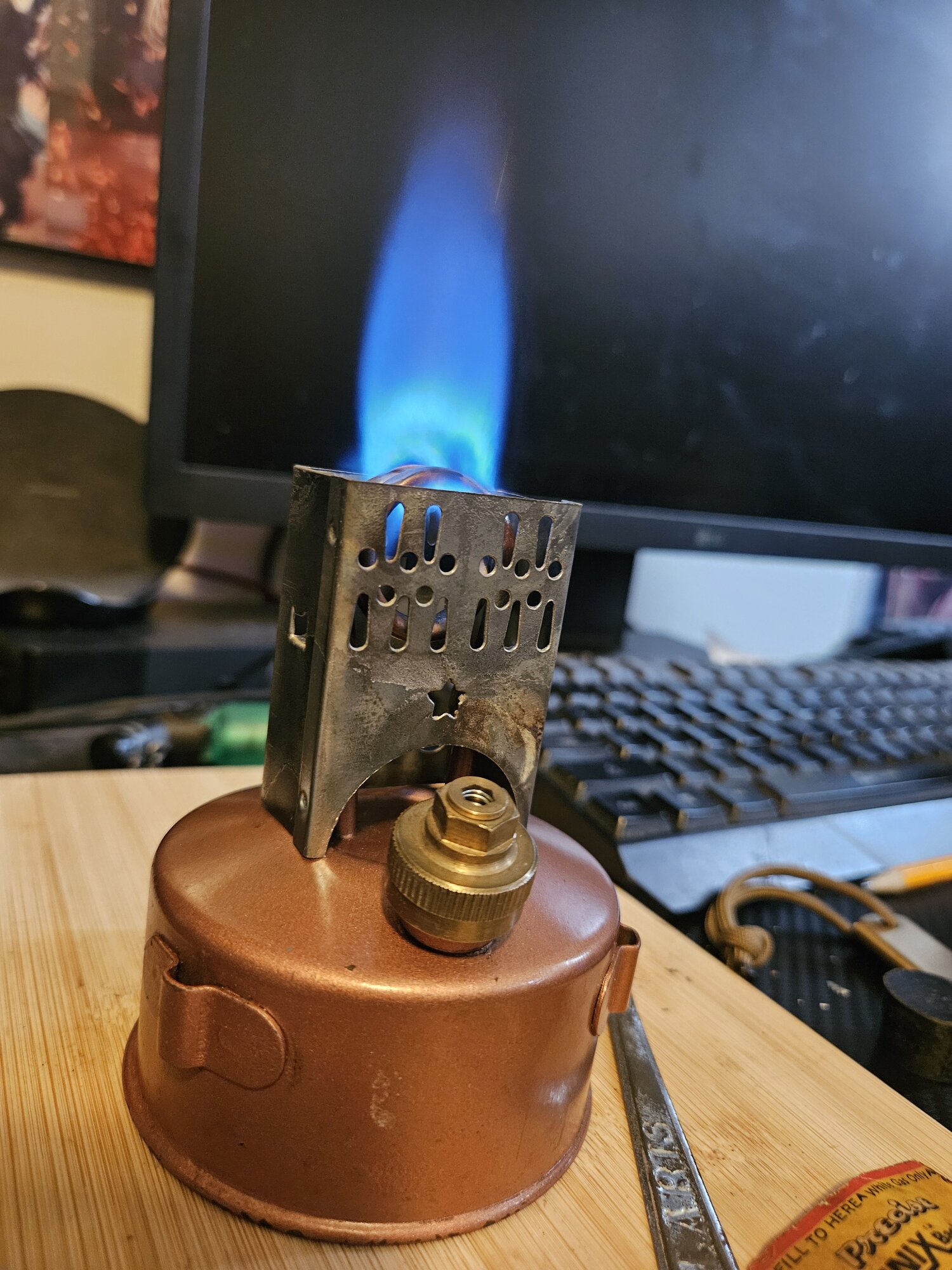

    I tried to blow air into the tank and heard nothing coming out the jet. Pricked it... Still nothing....so I filled it with carb cleaner...sealed the cap and held it in my hands... After a few seconds I got a few drops... Then a stream of brown looking crap... Then it squirt clean. I know of no other way to clean the coil... But this method has worked for me every time.
    Now I let this go for about 20 minutes...and used the cleaner to wipe off the carbon....and it came pretty clean.
    Next was to fuel it and light it up.... But it didn't work right and needed to be picked again. After it still ran kind of shitty...
    So remembered that my Taykit runs away better with the windscreen I went to look at it...and it was in two pieces... apparently made that way. One half stays on... The "door" or cover pops on and off when you are going to put a cork or plug in it. Weird... But ok. I just used a brass brush to clean it and put it on after some straightening... It performed perfectly after this ..

    All in all it works fine ..weird that the legs don't touch the table like the tank does... But it does seem to hold a pot. Not flimsy at all... Just never seen one of these before....

    Nice flame now, it maybe a clone of a South Korea stove. ??????
    What a big flame difference with the windscreen on.!!!!!
    Nice work

    @JP2 you got me man...I have never seen one like this, but I assume there are tons of them out there. It definitely does need the heat shield...but most of the coil stoves I have need them to perform right.
