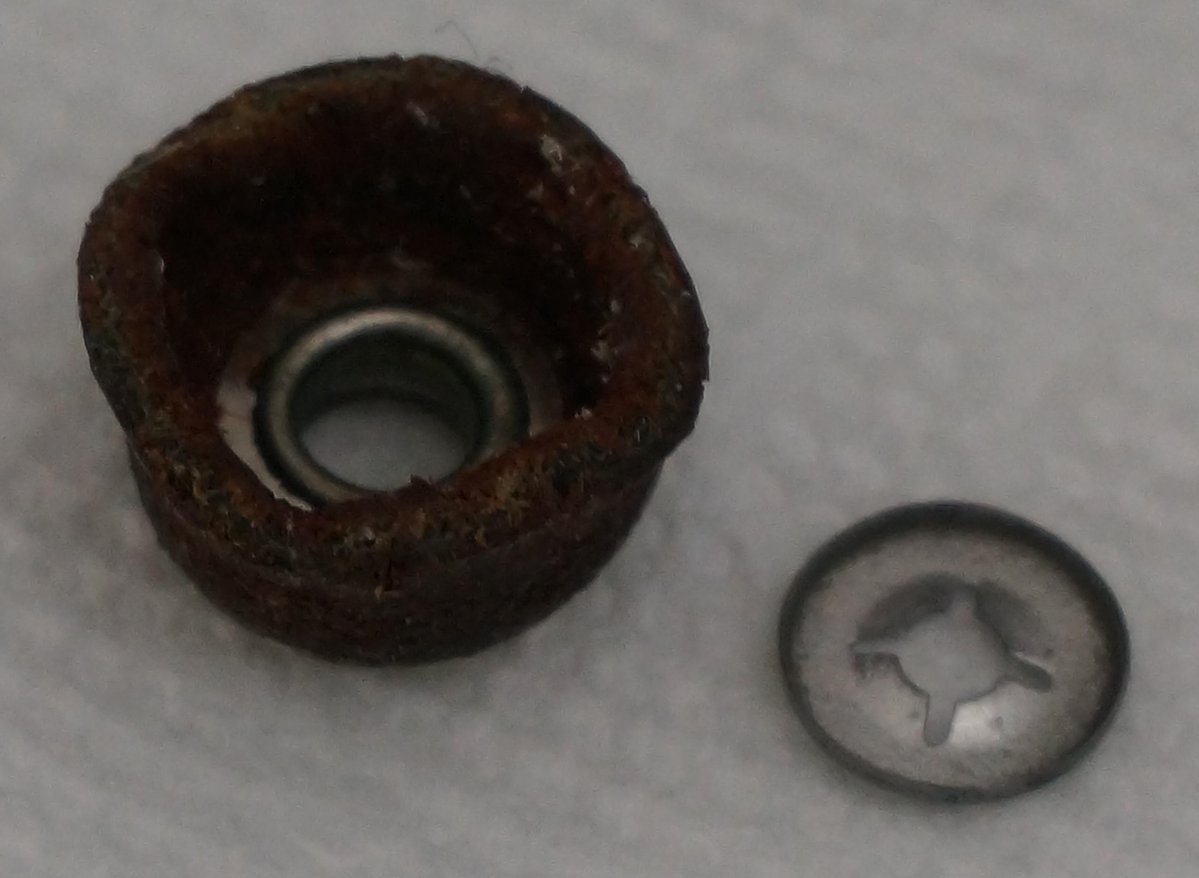

    Does anyone know where one can purchase a push on nut for the 111B pump rod?

    Hi @The Warrior
    Best, fastest and cheapest option is to measure the diameter of the pump rod and then search for “Starlock Washer” with the correct measurements.
    Worked for me, when fettling a couple of the older MSR burners.

    The pump rod end measured 3.9 mm where the clip goes on according to my calipers. I'll google it.
