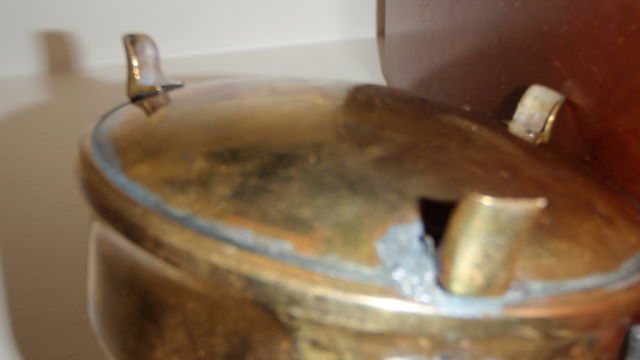

    Came across this 221 in a job lot today.
    I have had a look through the SRG, and I cant find anything with the type of legs this one has, or even the box.
    Can anyone help with any information on it, date etc.
    Ian

    Hello Ian, you did not find much as you found yourself an unusual, if not very rare Primus 221 model! The letter K denotes a 1921 vintage, which is in line with the feet, separate from the recepticles of the 3 potholders. This style was due to change in 1922/23 when both merged into one pressing, effectively moving the legs to the outside perimeter of the tank.
    The container seems the right one too, tinned, not painted as that colourful style had yet to appear, around 1925 I believe.
    The markings on the pumpknob is also a pointer to the old age, as these letters appear on other parts too on these older stoves. The significance is unknown sofar.
    With even the flame plate there, no more accesories like spanner, meth's bottle etc.?
    Even so, a very delectable find, even if you have paid a substantial sum, which I doubt, and congratulations are in place!

    Mike - Thanks very much for the information. There is a spanner, but no other equipment. I see Bom Bom Bom Bom, on another post somewhere, has a box similar to the one I have, which makes me wonder whether it is original to the stove. The embossed inscription on the brass plaque, reads, No 2 - The Compact Primus Outfit - Regd No. E44814, but my tin has been painted black at some stage.
