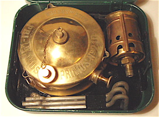

    This topic is partly speculative and hopefully helpful but please do not treat it as being proven fact
    The stove attached to this topic is a 1936 210. Full details of the 1934 and 1936 stoves can be found using the links above.
    During the middle of the 1930s there were several changes that happened at about the same time. Generally Primus was conservative taking the line that "We made it that way last time so we will make it that way this time" although from time to time they did change features on models.
    I think that it must have been in 1935 or early 1936 that they made a radical change to the 210s. The earlier models used a female connection on the bottom of the rising tube and a cap for a reserve lid. During the 1930s there was a depression and people who were struggling to buy food would not be buying luxuries like stoves. This would affect the sales and I suspect that Primus looked for savings in their production costs. The 210 used the connection on the 1934 stove and the 51s and 54s used the connection on the 1936 stove. I think that the decision could have gone either way but the 51s and 54s stayed as they were and the 210s changed to an identical connection. The 51 and 54 reserve lid was already in existence so they saved the cost of making the cap reserve lids. That saved the cost of making two designs of reserve lid. Spares for the earlier type would not be a problem as stocks could be produced before the appropriate machines were converted for other uses or scrapped. The earlier rising tubes needed a machine set up to cut the threads in the lower female end. A machine was already set up to cut the threads on the male rising tube so another machine could be set up for other work or scrapped.
    When I was buying stoves off ebay I used to use the different connection to "date" undated stoves. Obviously I could not accurately date the stove but I could put them into a period. Any stove with a female bottomed rising tube had to have been made before 1936. Any stove with the male bottomed rising tube had to have been made no sooner than 1936. If it was made by Hjorth it was made between 1936 and 1955 inclusive. If it was made by Bahco it was made between 1955 and 1962 inclusive.
    I always avoided asking any question relating to age as that could have alerted other buyers to the desirability of the stove and increased its price.
    I always asked questions about missing pieces or anything that would decrease the desirability of the stove and decrease its value. Providing that the seller was honest they would add the answers to the listings and depress the price.
    As well as this change there were two other changes that first appeared shortly before. Both changes seem to have happened in 1935 as they first consistently appear on the 1935 stoves.
    Primus introduced the tank lid with the captive airscrew. This did not have a cost saving effect. It would be slightly dearer to make than the previous tank lid.
    Primus introduced the fully slotted reserve lid on their 96s. This was a big improvement on the previous reserve lid. I doubt whether there was any change in production costs between it and the previous reserve lid.
    I have not seen any documentary evidence to support my opinion but it seems strange that several model changes occurred at about the same time when usually models remained unchanged for long periods.

    A 1935 Primus 210 stove has turned up with the later rising tube and other fittings so the changes occurred in 1935 not the 1936 that I suggested. These are the parts that were used from 1935 to 1962
    The captive airscrew tank lid was also introduced to other models at the same time
