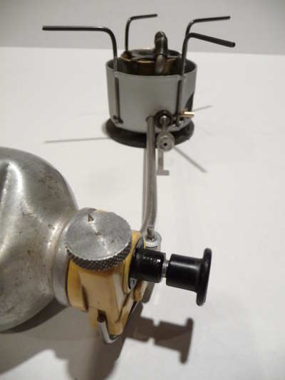

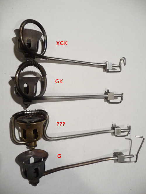

    With a little research and a little guessing, we (hikin_jim, doc_mark, and I) have determined that this fine little stove is the MSR Model MF. Here is the topic of discussion that we had: What is this MSR stove's model?
    We could be wrong but the evidence is overwhelming enough to say that it is the Model MF. Plus, we love to guess at these things!!
    So we expose it here for all to see.
    sam

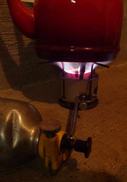

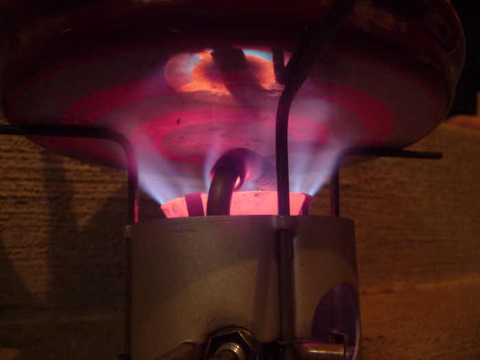

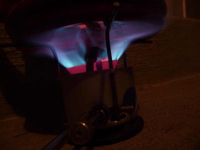

    A few flame shots...

    Really? Yours simmers? That's unusual for something in the XGK family. It must be the flattened geometry of the generator on your stove. The flattened geometry would keep the flame close to the generator even when the flame was turned down low. Just compare the generator geometry of the GK and XGK stoves to the geometry of your MF. It makes sense to me that your stove would simmer better.
    Kind of ironic, assuming I'm correct, that MSR has the capability to make a reasonably good simmering stove with the reliability and simplicity of the XGK but doesn't seem to realize that they've already solved the problem. It's like they just accept that their liquid fueled stoves (except the dual valed models, the Firefly and the Dragonfly) just don't simmer even though some of their older models did a reasonable job of it (e.g. your MF, my pre-shaker jet Whisperlite).

    Actually, most of my early MSR X-GK family of stoves simmer, too. It wasn't until MSR dumped the sintered brass surge filter, changed the jet design (around the mid/late 1980's), and dumped their outstanding yellow pumps, that the X-GK's lost their ability to simmer. Also, the simmering that they used to do will never compete with the FireFly or DragonFly stoves, but it is definitely usable for cooking. When you add in the tin can top that MSR used to include with those early stoves as a simmering plate, along with the other capabilities for simmering that the Old Timers had, you can do quite well.
    When I post the photos of my collection, I'll include some of the various parts that allowed the earlier MSR stoves to do better than the later X-GK's can do. Hope that explains it a bit, but if not, give me a shout, and I'll give it another try. :D :D Take care, and God Bless!

    Nice discussion on these MSR stoves. It's interesting, Doc, that you say the later XGKs don't perform as well as the earlier ones. I have a couple of later XGKs (I believe one is a shaker jet) that still performs unbelievably but you are right don't perform as well as the GK or G or MF for that matter. Boil times are a little longer, relatively.
    Now here is an interesting tidbit about this MF. I did a boil test of one litre of water in a ceramic kettle, a Le Crueset to be precise. The kettle is a really nice kettle if you are using it on a conventional stove. It's quite heavy and keeps the liquid warm for quite a long time. With these features, as you already know, it takes a while to bring water to a boil using this kettle, although not too bad.
    I did a boil test with cold tap water at about 60F, 1 litre, 4700 feet elevation, ambient temperature at 30F, no heat reflector, no windscreen (no wind), no lid on kettle and used kerosene and Coleman Fuel. The results were very surprising.
    I tried kerosene with the existing jet just for grins and found that it performed well at about 5:15 to get to a rolling boil.
    After I emptied and cooled the kettle down, I refilled with tap water, same temp, and used Coleman Fuel to run a second boil test. The result was quite disappointing. It took 7:50 seconds to bring the water to a rolling boil. Something was wrong.
    I realized that the jet must be a kerosene jet with the smaller aperture. So, I borrowed the jet from my Model G to see what would happen. I went through the refresh steps with the kettle and tried it with Coleman Fuel again with a little more than a litre of water in the kettle. This time it scored 5:50 to get to rolling boil. At this point I was sure the original jet that came with this stove is for kerosene and that I don't have a jet for gasoline other than the jet I can borrow from the 'G'.
    I didn't realize the difference in flame size until I compared the flame photos. Very nice.
    Here are some pics...
    Here's the flame on Coleman Fuel and the 'K' jet. It looks relatively anemic compared to the other shots.
    Here's a shot with kerosene and the 'K' jet. Nice and powerful flame.
    This is the stove running with Coleman Fuel and the 'G' jet. Nice and powerful.
    One more shot to complete the simmering discussion above. It is quite happy simmering.
    I'm sure if I used a heat reflector, windscreen, and a better kettle, the times will be shorter. The relative times are what are interesting at this point. It makes a difference using the correct jet for the correct fuel.
