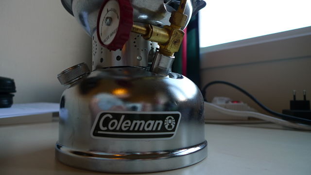

    Hi, I recently got myself a Coleman Centennial stove. I wanted to see what all the fuss about the 502 was, so I decided to buy myself this 2001 model stove. I do like it a lot, it does not weigh much, about 970 Gram, it needs no preheating during warm temperatures and it is made very simple. It also have a leather pump "I think".
    The things I dont like with it, is that there are no tools added to the stove which I can use to fix it. The tankknob is also hard to open if you tighten it a bit to hard. The jet is a bit off centered and the stove does not completely turn it self off due to a fault in the valve part.
    I do also think that the valve knob and generator is a bit exposed, so there is need of a cartridge for the stove.
    Any how, heres some pictures of the wonder:
    1350646603-P1020702_opt.jpg 1350646612-P1020704_opt.jpg 1350646620-P1020705_opt.jpg 1350646629-P1020706_opt.jpg 1350646635-P1020707_opt.jpg 1350646645-P1020710_opt.jpg 1350646657-P1020712_opt.jpg 1350646670-P1020713_opt.jpg 1350646702-P1020715_opt.jpg 1350646712-P1020716_opt.jpg 1350646727-P1020717_opt.jpg 1350646738-P1020718_opt.jpg 1350646748-P1020719_opt.jpg
    Edit- And yes, I do know that the centennial and the 502 are not 100% alike, but they are very very close relatives.

    I have found that most Coleman stoves do not turn completely off when you close the valve. You must wait for all of the fuel in the vaporizer to burn off. Usually only burns an extra minute or so. I have also been sorely tempted to buy one of those Centenial stoves but I already have 3 502's and a 501.

    I took a lot of pictures around the stove so you can compare it to the 502. I know someone else on the reference gallery have taken pictures with both together also. For some reason the centennial is a bit higher and misses some parts on the generator.

    The vent hole in the pump handle is required because of the NRV locking feature. Once you turn the handle clockwise and shut off the NRV, you would not be able to push the handle in if this hole was not there.

    The Coleman Centennial does have the look of a 502. The control valve knob and pan holding ring look 502 but the rest of the stove is a modified 508. It looks good and burns nice! Enjoy :thumbup:

    These are indeed curious stoves. But, you still need a 502 if you want to see the why some of us like it. These Centennial stoves are really just a 508A or 533 wearing a 502 hat. The 502 and even the 508 are great little stoves; the 508A and 533 are just stoves.

    I think what makes the 502, 400 and 508 excellent performers is they have a 2nd control lever for the cleaning needle. The needle reduces the jet aperature for a good simmer.
    The 508A and 533 are hot stoves that perform well at medium to high. To get a good simmer you need some type of trivet or simmering ring to raise the pot a little more off the flame.

    Most Coleman appliances take a little while to "Power Down" after the valve is closed. They are burning off the fuel in the generator. It is normal and nothing to be concerned about.
