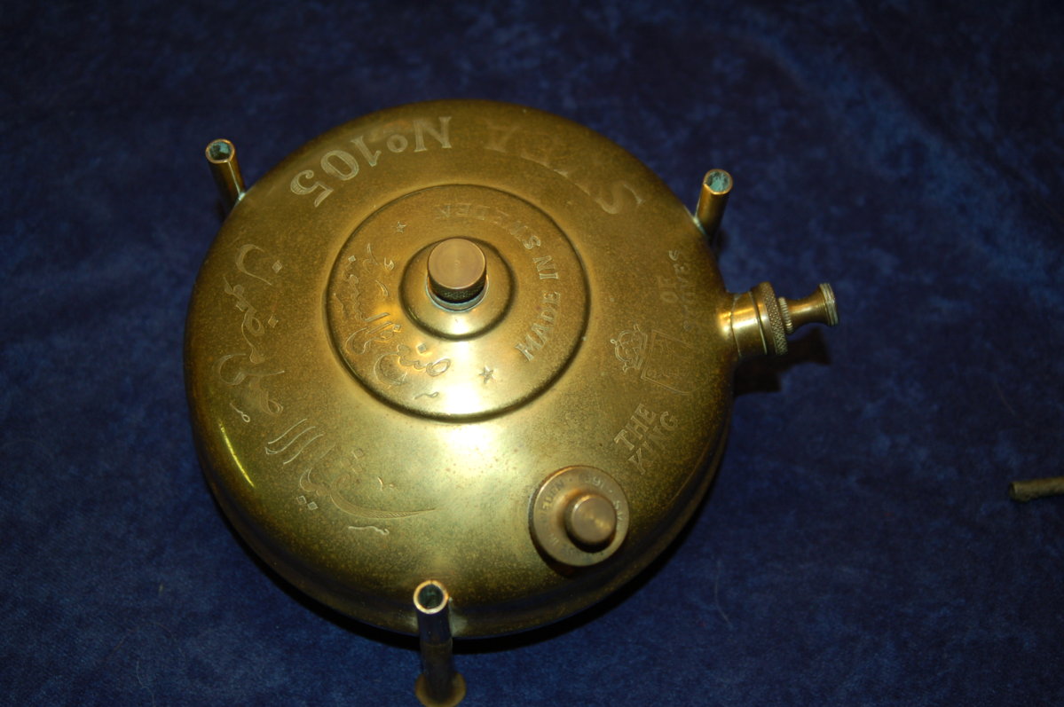

    A Svea No. 105 from 1950, graciously provided by Glyn Stacey and his family. All stoves have a history, sadly most are lost to time or are never known by their new owner. Fortunately this one does not fit into that category. She’s been owned and enjoyed by her original family since initially purchased. I feel it's always important to know as much as possible about a stove's past. It helps bring an added perspective and dimension to the item; helps ground its importance and brings human elements into play. Stoves, like everything manufactured or worked, are nothing without the human factor. In the end they are there to help focus the true importance of anything cherished – life and memories.
    This stove was purchased in 1950 by Glyn's father Graham Stacey, from the Malvern Hills area, England. It was for use in their very basic cottage as a backup to cooking when their electricity would fail (which it often did). Graham was very familiar with paraffin stoves and lamps. He grew up in the Middle-East as his father was stationed in Egypt, Iran and Iraq working for the British Army. When Graham was back in England and had his own family, he would frighten them to death whenever he got the 105 singing. Her first firing though was along the west coast of Scotland and Skye. A trip filled with fond memories of rain, midges and laughter shared by the family. The Stacey family continues to vacation there to this day, keeping the traditions of his father alive and well.
    The Svea stoves are amongst the most beautiful made with almost all their parts showing intricate engravings. The Svea 105 came with all her original parts as shown below. There was no spanner, pricker, draughtshield or tin. She was in excellent used condition, all I did was clean and polish most of her parts. Both gaskets on the fuel and center fount caps were still pliable and held pressure. No leaks with the non-return valve (NRV) when tested. Only her pump leather needed to replaced, original had ripped (stuck to inside of pump tube) and her jet cleaned (a bit of carbon build-up generated underburning).
    Lightly sanded her pan rim to remove some surface rust (original color was gold). Labelled ‘SVEA’ x 2 and ‘SWEDEN’ with 3 x Crown logos separating text on her outer rim.
    Stove ready for packing.
    Markings on the bottom of her fuel tank: ‘MADE IN SWEDEN’. Typical flared out Svea feet.
    On her side, showing the discus shape of her fuel tank.
    The top of the pump handle unscrews and becomes the stoves center fount cap for packing.
    Pump cap labeled ‘SIEVERT MADE IN SWEDEN’. Fount cap unscrewed, showing the threads on the remainder of the pump knob.
    Fuel cap labeled ‘SVEA MADE IN SWEDEN’, no markings on vent screw but both with knurling.
    Fount markings: ‘SVEA No 105’
    ‘THE KING OF STOVES’ with the Svea coat of arms.
    Arabic script.
    Top view, one of her legs removed to show the center, inner raised graphics around the burner hole. ‘MADE IN SWEDEN’, star graphic and more Arabic script

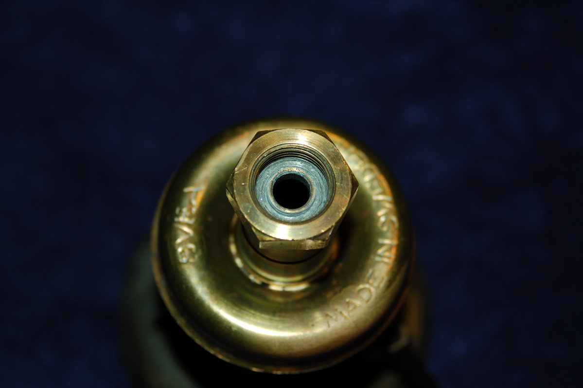

    I think one of the washers you replaced was the washer between the tank and the vaporizer. I am thinking maybe I should do the same. I looked at the picture of that area. Is that a picture after you removed the washer and before replacing it? The reason I ask is that as I look at mine it seems ....well... more filled in. light to medium grey. Would this be the existing lead washer? I kinda gently picked at my washer with a dental tool. seemed like it I would only be able to scrape off very fine fragments and not get the whole washer out. How did you remove your washer? was it lead or rubber?
    This stove does have a leak from the top when the little cap is on and from the NRV so I am getting a tool to remove that and see whats going on there.
    Mine has a rubber cup on the pump and I think I would like to replace it with a leather cup. Did you take off the nut at the bottom of the shaft or replace the cup from the top?
    This stove will be my 1st "fettle". So I am very excited to learn and do this....but know so little! DSC_6295.JPG I really appreciate this thread.
    Thank you. Here is a pic of my washer. Any help would be much appreciated.
  4. Tony Press
    9,371
    @NW Lady
    What I see in your picture is the lead washer. Don't replace it unless you get a leak from there. When you put the burner riser on the tank, tighten hand tight (don't twist the burner), then use a correct sized spanner to nip the riser nut tight to the tank - tighten gently and don't force it.
    It is usual to take the nut off the bottom of the shaft to replace the pump cup but sometimes they are cross-threaded and forced on. I would switch to a leather cup.
    When you say "a leak from the top" where is that exactly?

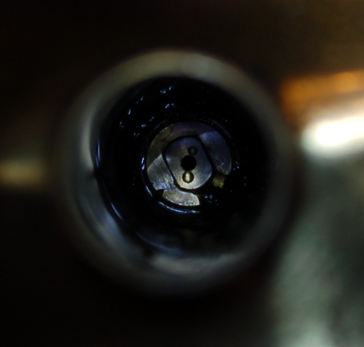

    Thank you, Tony for the info on the lead washer and how to attach the burner assembly. ie.. don't twist the burner... get a wrench and only tighten that way.
    I had a leak at the top of the tank when the vaporizer was off and the font cap was screwed onto the top of the tank. From posts, I read, that little nut still has perhaps the original washer... black with white lettering "S". I plan on replacing the washer. I haven't tried to leak test this lead washer and the vaporizer yet.
    I know I have an NRV leak so trying to solve that. Getting a NRV tool sent... ordering a lead washer. ,,,but kinda confusing since I don't know what kind of NRV this has. Saw a post that the SVEA 105 usually have an "all in one". here is a pic of the NRV. seems to have black gunk around it. I think it is from the washer on the pump as it is black rubber of some type and some crumbly, black, sticky stuff on the end when I pulled it out.
    Should I try to clean out the black gunk before trying to remove the NRV? I was thinking some of it may get into the tank.

    It's a good idea to clean the pump tube out before removing the NRV. That ensures your NRV tool house all the way down and fits the NRV properly. It also stops gunk falling into the tank.
    A good idea is to soak the NRV in penetrating oil for a day or more before trying to remove the NRV. Do this by filling the pump tube with the penetrating oil.
    You can make your own penetrating oil by mixing 1:1 acetone (nail polish remover) with automatic transmission fluid.

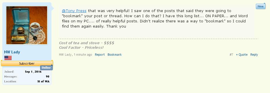

    @Tony Press that was very helpful! I saw one of the posts that said they were going to "bookmark" your post or thread. How can I do that? I have this long list... ON PAPER... and Word files on my PC.... of really helpful posts. Didn't realize there was a way to "bookmark" so I could find them again easily. Thank you
  8. janders
    janders Subscriber
    Aug 11, 2014
    789
    @NW Lady
    If you look just under Priceless....
  9. Tony Press
    9,371
    @NW Lady
    If you look at the bottom of this (or any) post, you will see "Bookmark". Click on it. When you go to your personal information, you will find your bookmarks.
