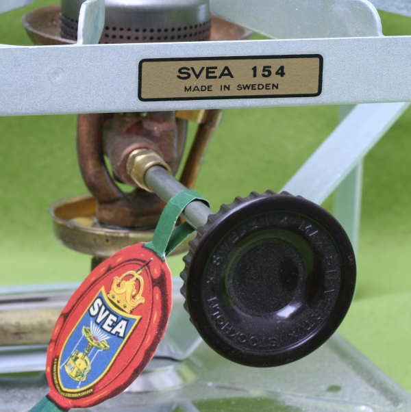

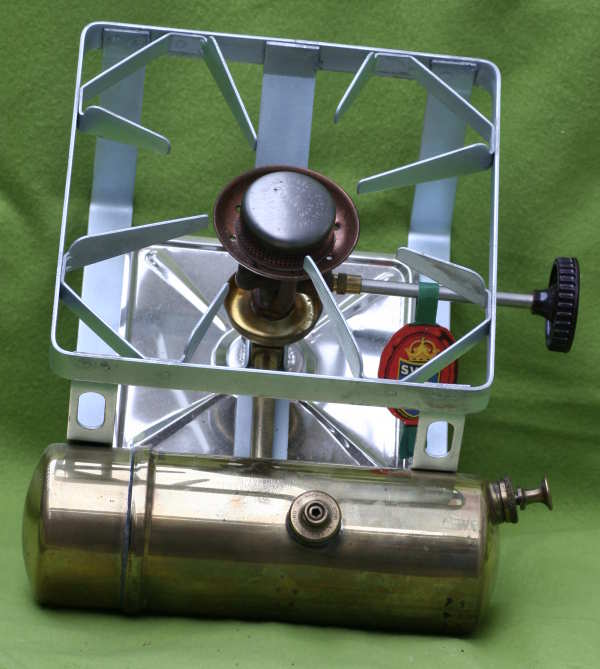

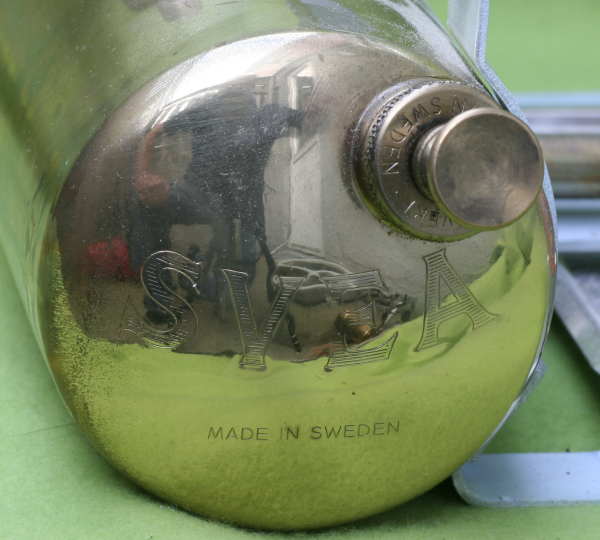

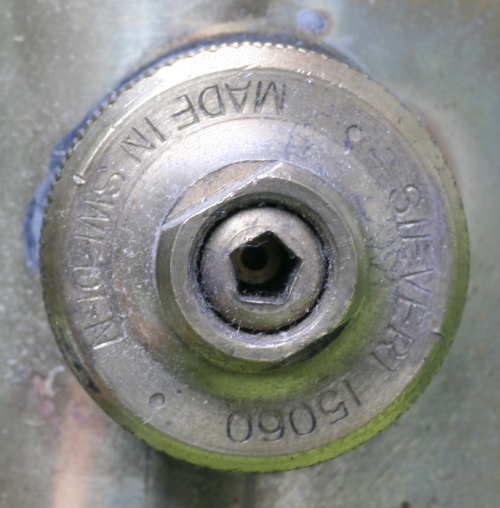

    Surplus from the Norwegian civil defence.
    The Svea 154 is the twin sister, and mirror image, of the No:155. They can be bolted together to make a double burner as shown on this Svea advert .
    1219522068-Svea_154_7.jpg 1219522001-Svea_154_2.jpg 1219521991-Svea_154_1.jpg 1219522028-Svea_154_4.jpg 1219522044-Svea_154_5.jpg 1219522055-Svea_154_6.jpg
