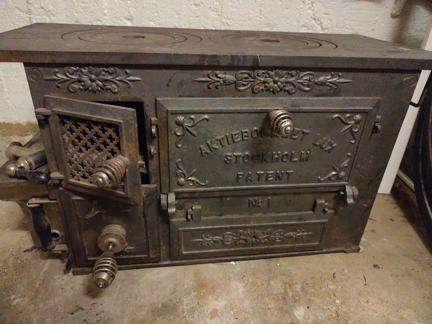

    Not sure if this is the correct forum for this or not. But I would like help from anyone to identify this stove that my grandfather gave to me.

    That's a rarity!
    It's called "Luxspiseln no.1", and was seen atleast in catalogues and instructions from 1902. I have a catalogue with this one posted in the reference gallery, but you need to be a subscriber to see it.

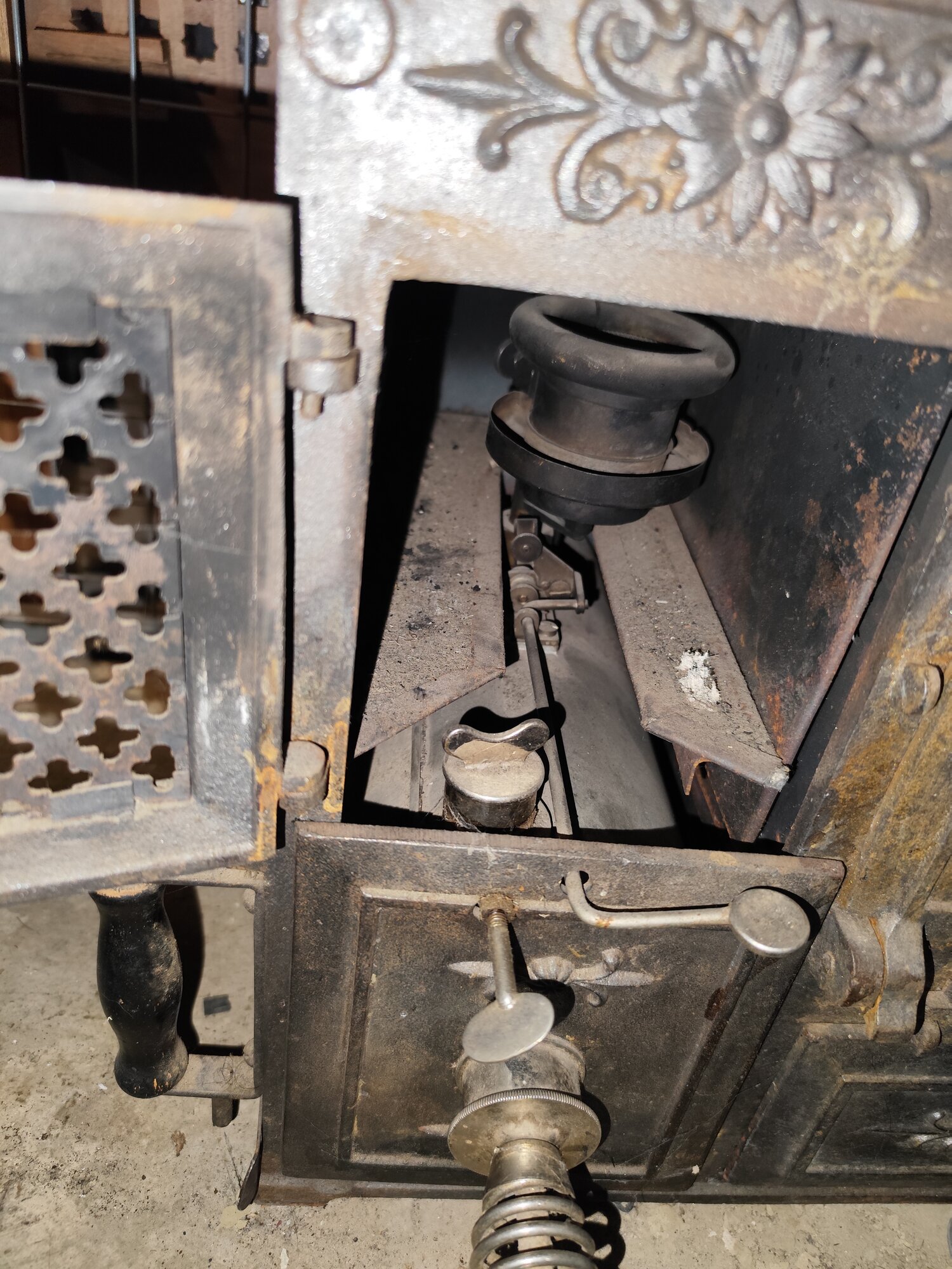

    Do you have the burner with it?
    This part, if you pull out the lower left drawer:

    The stove is really beautiful. Great!

    That is indeed a beautiful unit. Does the burner on the left run on kerosene? I would have guessed the stove was a wood burner.
