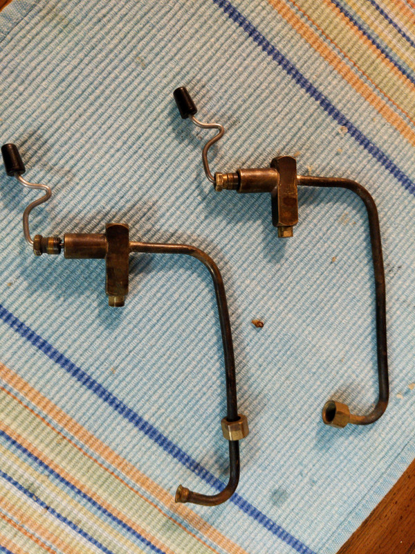

    I'm new to this forum. I'm a scout leader and have found myself learning to maintain our white gas gear.
    I have unearthed a couple of 400 generators.
    the prickers in them both look short (relative to a working and healthy one I have)
    I've seen this thread 400 pricker wire broke or recessed? - The Coleman Collectors Forum
    and believe I need to replace the currently shortened bit with 28 gauge wire.
    The problem is I've tried pulling the black handle out (after fully opening the packing nut) and I'm reluctant to pull much harder than I've already tried. Is there a trick or clever thing I could do to make this removal feel less like I'm trying to wreck these relatively rare and difficult to find pieces of brass?
    I have 2 working 400 coleman stoves but I'd really like to be able to restore these two generators if it's possible, as backups for what we currently have or replacements in the event I find yet another stove I didn't know we had.

    hmmm... seems my images didn't make it... I'll try again here.

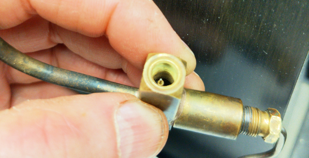

    The generators
    and the short pricker
