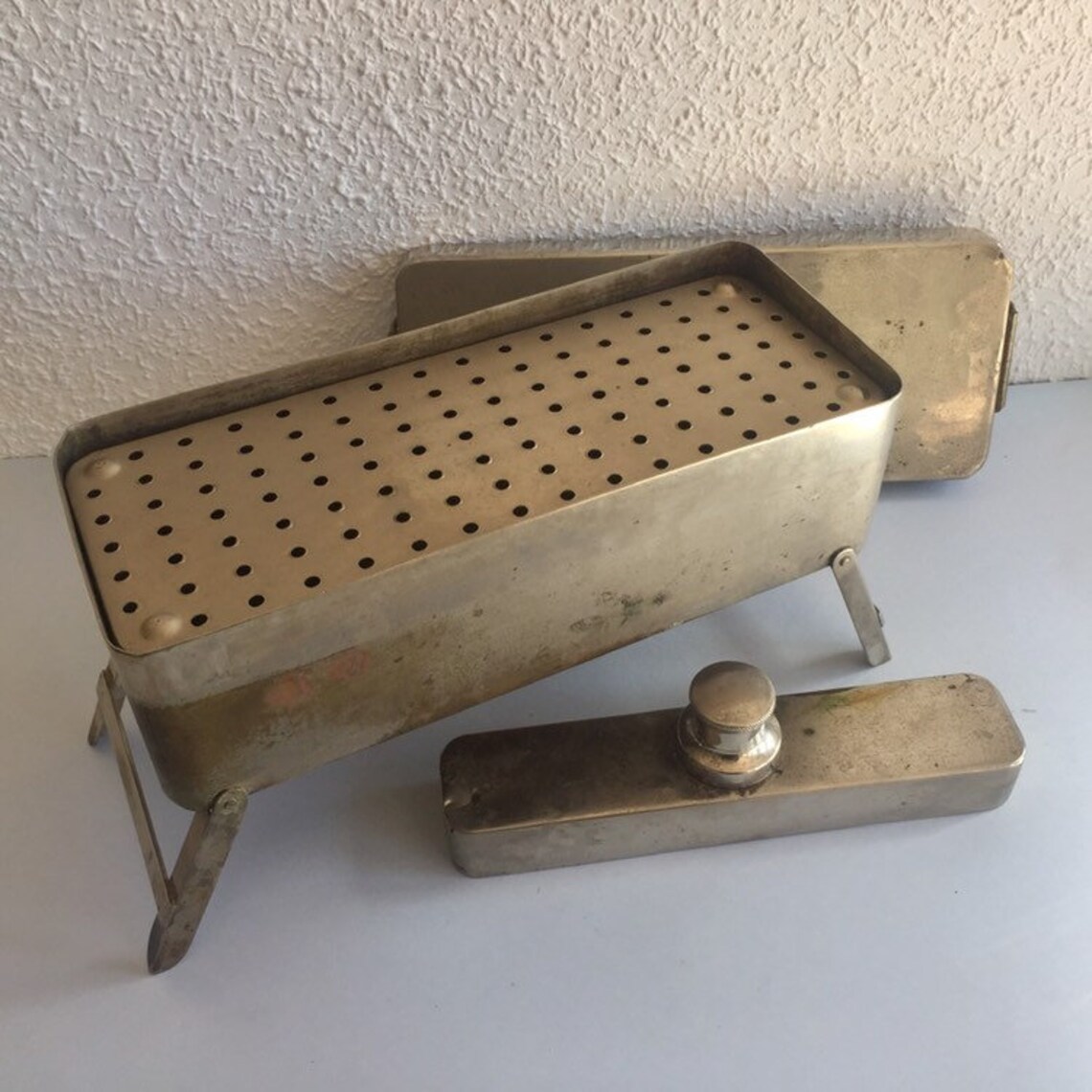

    @gieorgijewski
    I feel you are misreading me.
    I do not doubt what you have said and shown. I am simply trying to understand what the use might have looked like.
    A date of 1917, or 1927, or 1937 makes a bit of a difference. The 1939-45 kits from other countries I have seen look to me intended for autoclave not boiling, but I have seen so little. I am trying to reduce my extreme ignorance!
    I wonder if the field kit with burner is older than the drawing, or the same age. I presume you have some idea. If it is the same age it might have a slightly different use, or the drawing might not have been exact. I don't pretend to know: I just noticed that it is different. In my mind a front-line medic with equipment they can sterilise makes sense, but it also means some compromises.
    For me this topic is something like the British stovies thinking about the lack of shutoff valve with the Hurlock stove. The use environment might make a difference.
    I'm sorry if my "thinking aloud" is troubling.

    I didn't think it was a sterilizer either, so this is also an education for me. I am surprised (and a bit horrified), but it would certainly be better than nothing. Thanks, @gieorgijewski for showing its use.
    ....Arch

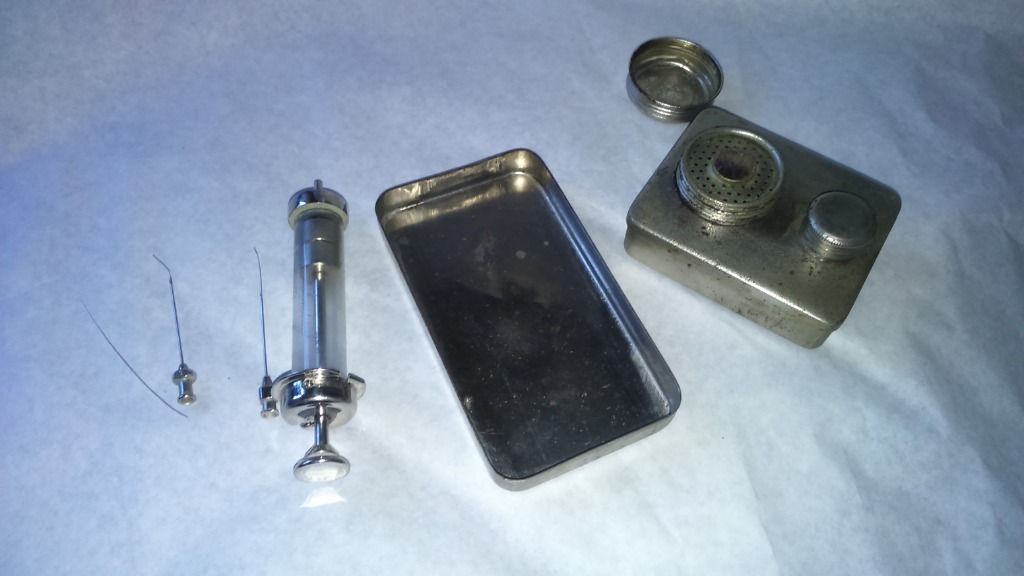

    continue

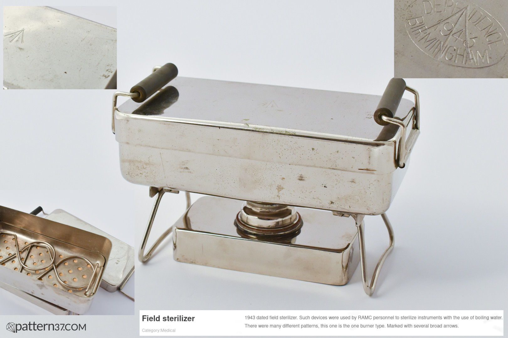

    compilation from Field sterilizer 1943 l British WW2 | pattern37.com
    from 60 ties italian
    all started in 1906 when metal glass syringe systems was constructed
    many sterilizer was parts for sets syringe
    wwi was time of changes in medic tasks on battle fields

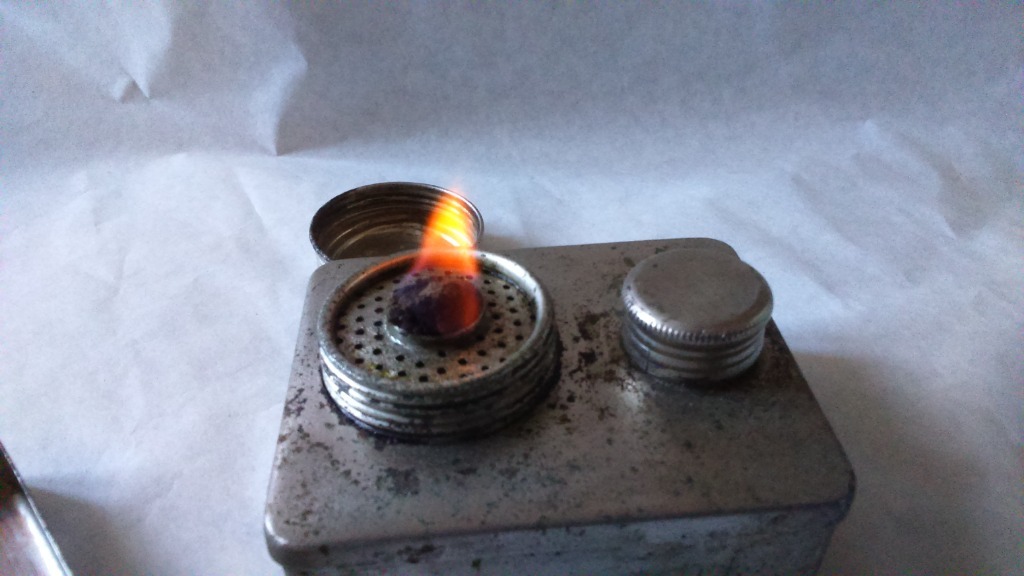

  16. gieorgijewski
    gieorgijewski Subscriber
    Apr 19, 2013
    4,301

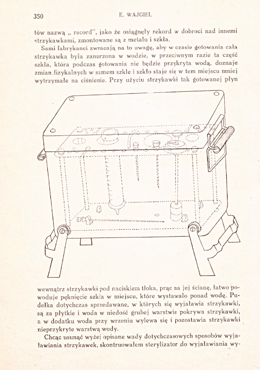

    "RECORD" system
    1936
    automatic translation
    NEW MODEL OF SYRINGE STERILIZER.
    EUGENJUSZ WAJGIEL.
    The following reasons prompted me to construct a separate sterilizer for syringes, which I briefly present below. In clinics and hospitals, syringes are usually sterilized either together with other tools or separately, but in the same sterilizers. In private practice, syringes are most often sterilized in metal boxes in which they are stored, or in ordinary kitchen utensils.
    The above methods of sterilizing syringes must raise concerns for many reasons. First of all, sterilization of syringes that are to be used for injections or punctures should be done in distilled water, which does not contain any salts, especially syringes should not be sterilized in water to which sodium carbonate is added, as is done quite rightly so, when sterilizing other surgical instruments. The presence of salts such as sodium carbonate, etc., which settle on the inner walls of the syringe during sterilization, may result in the formation of undesirable chemical bonds with the fluid drawn into the syringe. Such losses are, of course, not indifferent to the body, because while these connections are not directly harmful, at best they weaken the effect of the drug. It is already known, for example, that the presence of alkali neutralizes the effect of adrenaline.
    In addition to these most important reasons for sterilizing syringes in distilled water separately from other surgical instruments, there is also an economic consideration, i.e. proper maintenance of syringes.
    The syringes currently most commonly used, marked by manufacturers with the name "Record", as they have achieved a record in terms of quality over other syringes, are assembled from metal and glass.
    The manufacturers themselves make sure that the entire syringe is immersed in water during cooking, otherwise the part of the glass that is not covered with water during cooking will undergo changes. physical forces in the glass itself and the glass becomes less resistant to pressure at this point. When using a syringe boiled in this way, the liquid inside the syringe under the pressure of the piston, pressing against its wall, easily causes the glass to crack in the place that protruded above the water. The boxes sold so far, in which syringes are sterilized, are too shallow and the water covers the syringes in an insufficiently thick layer, and in addition, the water pours out when it boils, leaving the syringes uncovered with a layer of water.
    In order to eliminate the above-described disadvantages of the existing methods of sterilizing syringes, I constructed a sterilizer for sterilizing only syringes. In this sterilizer, syringes of various sizes are completely immersed in water during cooking, and the needles are sterilized along with them. The design of the sterilizer is very simple, as can be seen in the attached drawing, sterilization is not difficult even for unskilled workers, who usually forget about the correct way to sterilize syringes.
    This sterilizer has walls so high that commonly used medical syringes (even the largest ones, i.e. with a capacity of 20 cm) are sterilized in a standing position, and water can cover them to a height of several cm. To enable the vertical position of the syringes, a separate pedestal with holes for different calibers of syringes is placed into which the medical syringes are placed before sterilization.
    The pedestal also has small holes for syringe needles and separate holders for the longest needles in use. Using this pedestal, after boiling, the syringes and needles are removed, covered with a sterile cloth, and after cooling, they are ready for use.

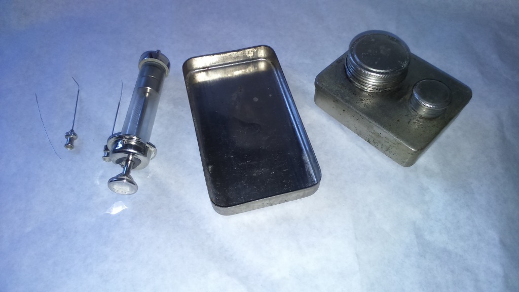

    Do We Need moore discussion?

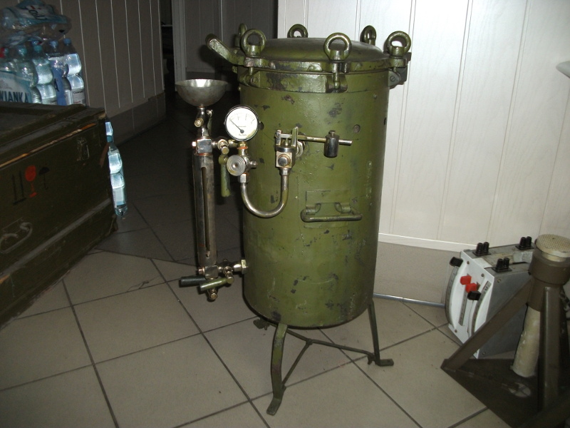

    We can talk about regimental level medic's care - in fields
    btw
    steam or water bath? but not autoclave
    because that
    is waterbath
    Coleman 527 Military Medical Stove Complete and Unused
    size and weight determine autoclav use
