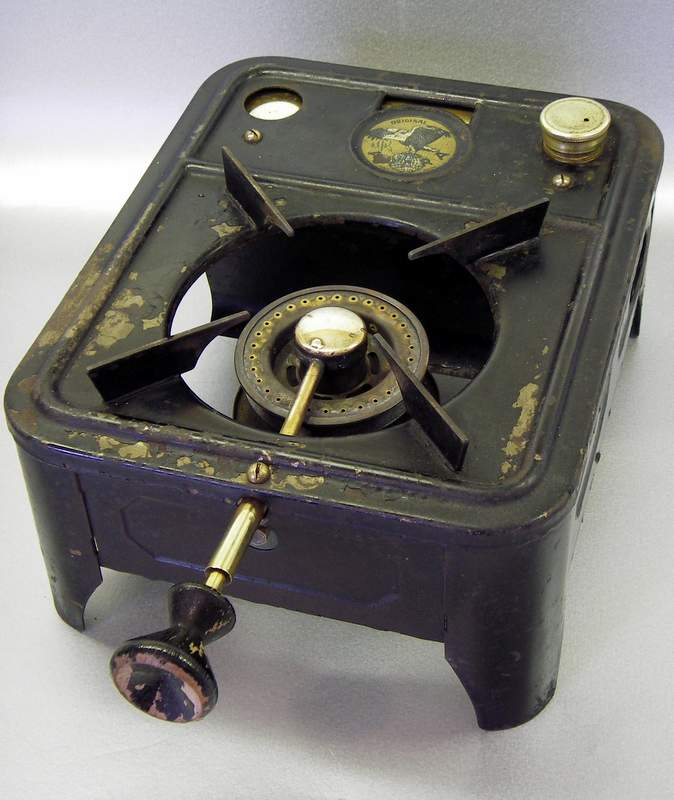

Arara S55 spirit stove

    The burner and fuel tank assembly
    The burner principle is very similar to what I here called the second variant of a Tito Landi stove
    Tito Landi
    The fuel is gravity-fed to the sump of a vertical vapourising cylinder, a wick carrying the fuel up to the burner, where the vapourisation takes place
    Priming sequence, using a little thimble-sized cup attached to the fuel filler cap to transfer a priming shot to the burner priming cup
    1342890281-14.JPG 1342890296-15.JPG 1342890312-16.JPG 1342890330-17.JPG 1342890344-18.JPG
    Like the Tito Landi, this Arara has burner outlet holes set around the inside perimeter of the burner ring to ensure the vapourising chamber stays hot enough to do its job without burning the wick. At risk of sounding like character Nigel Tufnel (Spinal Tap), the Arara has six to the Tito Landi's four though

    Puts a lot of heat out when turned up to, er, eleven

    Hi Jhon what a wonderfull and interesting spirit stove you have,i realy like the primming feature,what a brilliant and usefull idea, delivering the correct amount of spirit to prime the stove.
    A brilliant stove you have John a great performer with a superb controll. You realy have a brilliant unique collection of spirit stoves and some very fine examples of some rare and interesting gassies

    I see the priming thimble can also tell the user there isn't enough fuel, if the thimble is empty. ... NO PRIME - NO BURN!!
