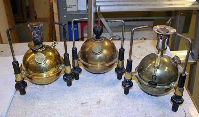

    From left to right:
    My Assurans stove, Technical Museum's Assurans stove and C.R Nyberg stove

    Thanks Magnus.
    Not quite the first stoves - wick stoves had been around a good while. Your stove is an Assurans by Assuranskökbolaget patented by Forsberg in the 1870's - likely to be the first petrol stove of this type. Nybergs later stove is uncannily similar!
    The distinction with the later paraffin pressure stoves was the addition of a pressurizing device to force the less volatile fuel into the burner.
    Thanks again to Stefan Järkeborn

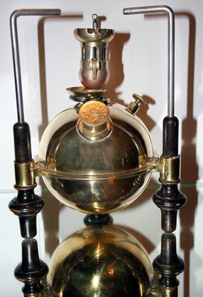

    An updated picture from Magnus

    Courtesy
    Forum Rule:You give the moderators the right to use your pictures elsewhere in the site for reference purposes. Such use will be credited 'Courtesy
    of Magnus Thilander

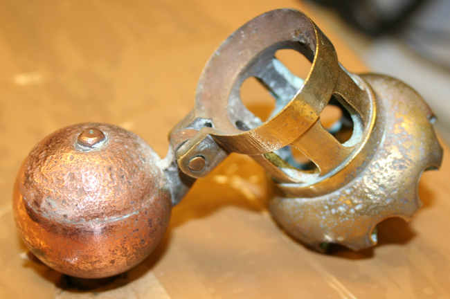

    An updated picture of the burner from Magnus
