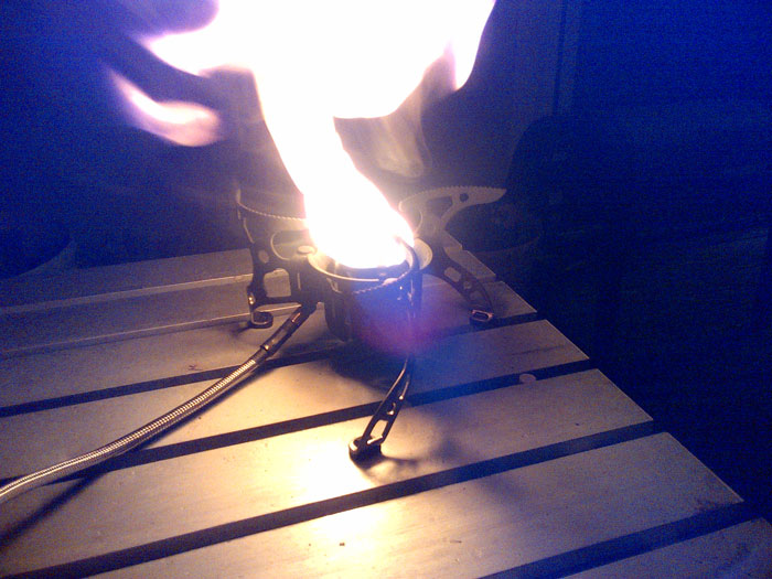

  3. Linus
    Mar 6, 2013
    63
    The instructions for this stove state that Kerosene and Diesel will burn in the stove. Diesel will never vaporize properly. I tried it as an experiment. Yellow flame results. After awhile, the generator tube will cool and the burner will resemble a camp fire. Luckily the flames are restricted to the stove's superstructure. I am using the correct jet for the heavier fuels.
    Kerosene will burn with a small amount of volitile fuel added. I use fuel injector cleaner. Basically, this stove will be my butane gas stove (with a jet switch). I am terribly afraid of using gasoline. Kerosene is about as good as it gets, and it is a hassle.
  4. Linus
    Mar 6, 2013
    63
    Here is the stove burning diesel. At this point, the stove cooled and the vaporized diesel turned into liquid. What a mess!
